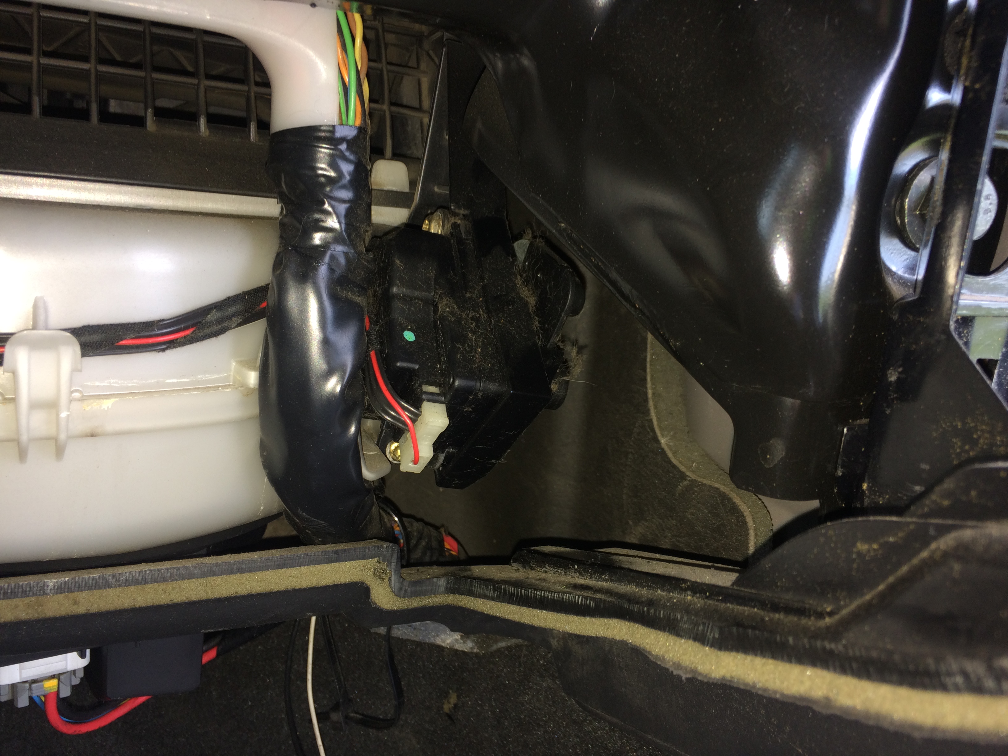

So I have recently fixed a mess of problems on this lovely vehicle and everything was great until my sunroof started to act up. When I press the switch to auto open it it stops after moving partially the it only moves slightly when I push it again. It does the same thing going forward and some times the switch doesn't do anything. It does start working properly but eventually reverts back to the same thing. For my a/c issue, it blows cold but every once an while when I turn on the a/c or even just turning on the blower I feel the air come out of the vents but then I hear a little motor and the air stops like I pressed the manual circulation button. I can hear it blowing but it's like it keeps closing itself off. If I turn the air off and then back on I feel it again but it closes off again. It's not all the time but annoying to say the least. Any help is greatly appreciated!

I've been messing around with it and have discovered that I haven't had that quality sensor on at all, but having it on hasn't changed much. I also discovered that if I turn my a/c off it blows through the vents as normal but if I turn the a/c on it stops blowing. I hear my blower motor going but I get no air flow. I can press manual and auto and change speeds but it won't blow with the a/c on only with it off.

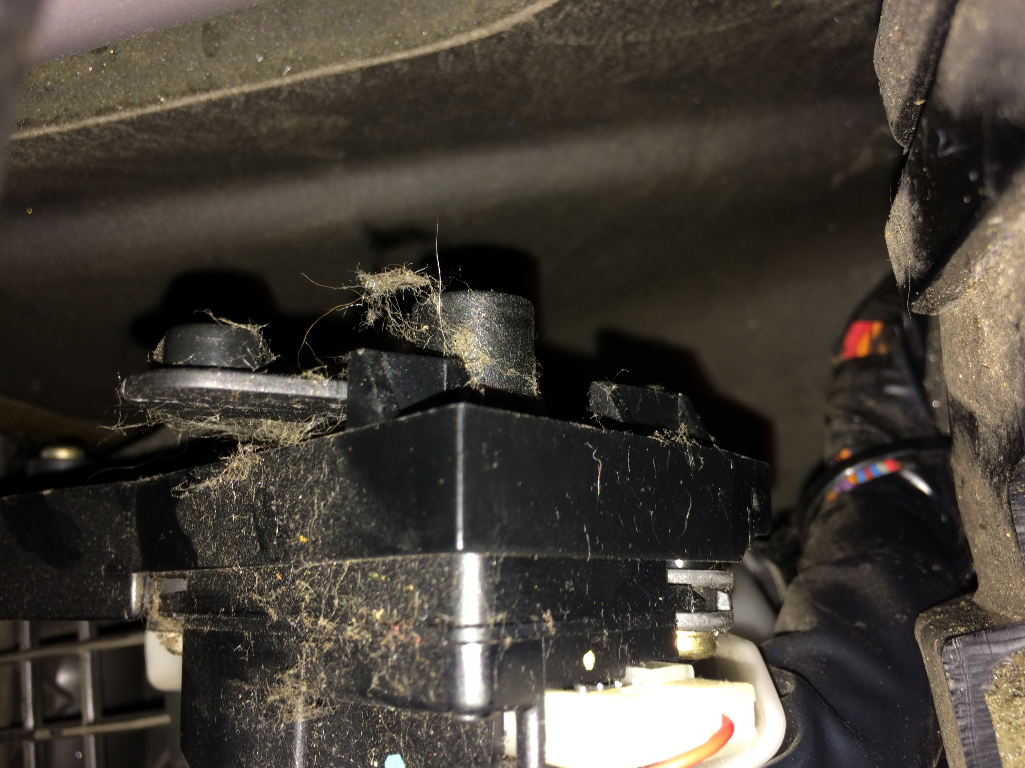

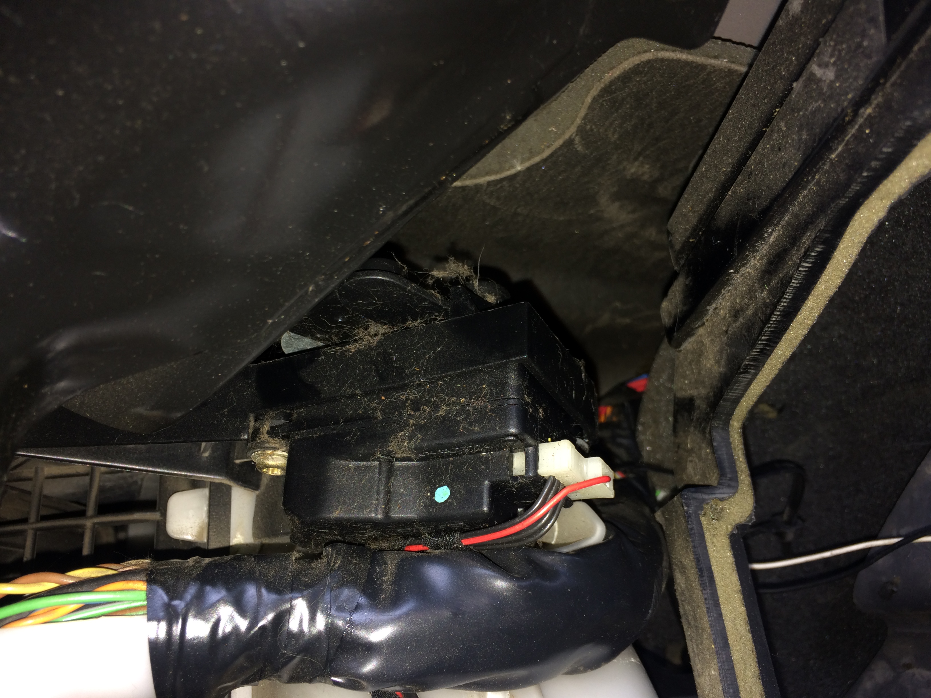

I don't really have an air flow issue in that way. It's not that it blows and then gets weak it's that it goes from normal to nothing as if I closed all the vents at once when the a/c is on. It does it when I first start and after I've driven and somtimes not at all it's more of a door closing on me than things freezing up in my opinion but I'm not ruling anything out just yet. Think I may go and pull my glove box out and see if anything looks like it shouldn't.
