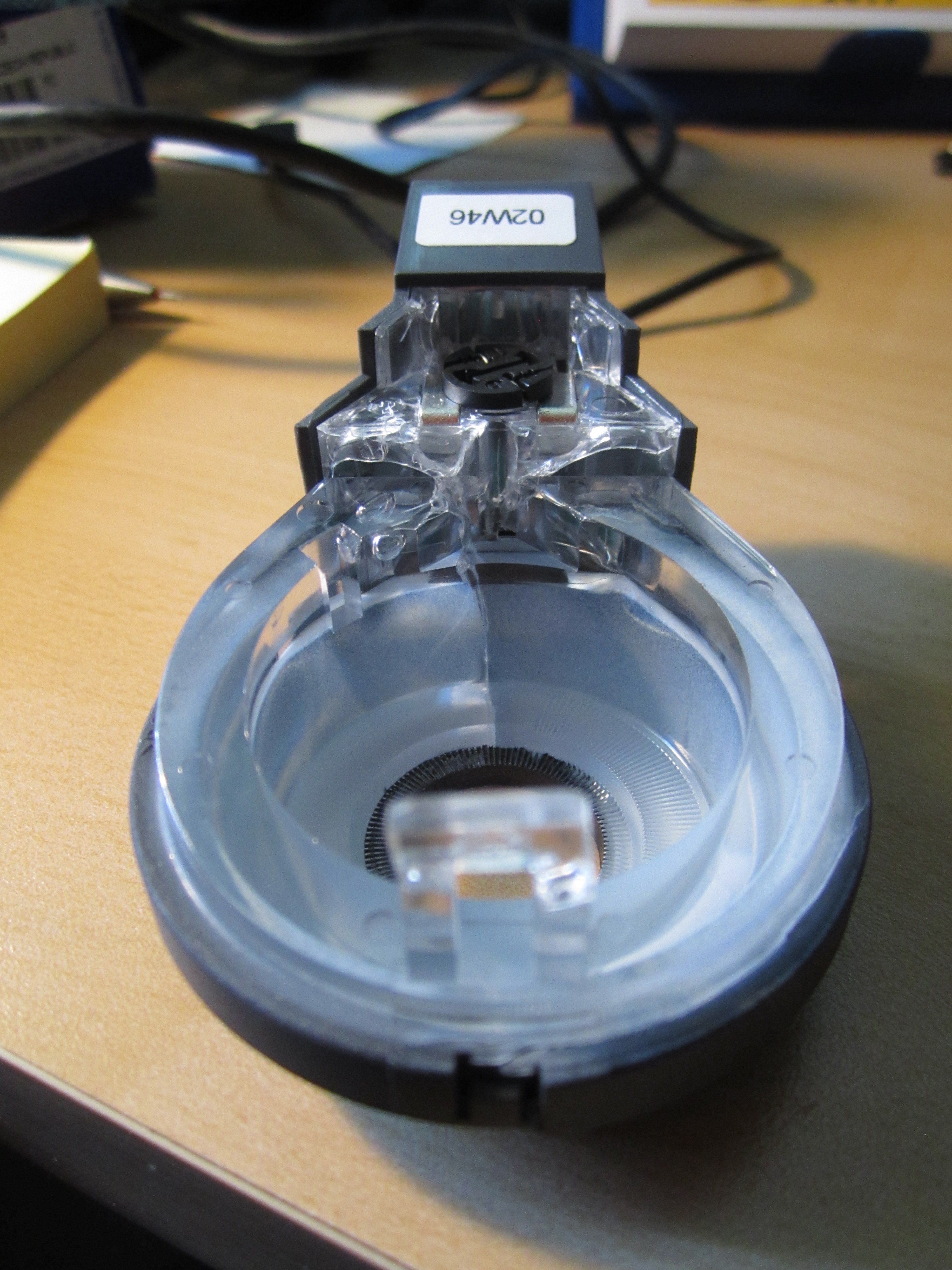

Well, while I was waiting I decided to try 2 things. First try the other key in case the key was bad (as happened with our 06 XC70) but as they key only has the chip it was not something I thought was an issue but worth trying. Nope, same issue.
Decided to remove the antenna ring and see if the contacts were bad. This is what I found:
Do you think the crack and shattered body of the antenna ring 'might' be the issue? Even the clip holding it on is split. Another $80 out of the bank account! Like all the other things that the PO broke on this car that I have never seen broken on a P80, this is another one where you go, " How in the name of creation (I use more colorful engineering words) do you manage to break one of these???" Question now is why is it flaking out now, is it just to piss me off?

Was the CEL on when you bought it?

I think that answer is at 2nd page.

Check my parts thread if you want try a used one. Part number is up. 1999 NA

There was a CEL on when bought, but it was believed to be related to the flashing orange arrow of death from the tranny. The dealer checked it as I thought it was the PnP switch and it will set of the engine light too. My Dice unit would not talk to the tranny/TCU so took it to the dealer. Mechanic found a non-communication issue with the TCU related to oxidation on the contacts of the TCU and ECU. Cleaned the contacts with Wurth contact cleaner and a cotton bud. Refitted and switched off the CEL's and all was good and has been on the only 2 journeys since then. The car has mostly been in bits for the last 5 months, but when I started it up to turn it around in the garage it was fine. It was only after trying to start it yesterday this started. It could have happened before but as the mechanic had re-set everything I have no idea if it was there before.
I saw your note abscate. I have ordered a new one as I have to get this car out of the garage to give me room to swap 3 cars worth of winter tires off!
Appreciate the help guys!

Fitted the new antenna ring this afternoon, re-set the check light and started the car up. Within 5 secs the check-light came back on. Same freekin' error code P01670!!!
Re-set it again and restarted. 5 secs and the light is on again. Switch off and walk away to find the fuel can and matches!!!!
Calm down and check the fault code and it is not the P01670, but pack to P0352 B coil primary/secondary coil error. What!!???!
Pull #2 coil and swap #1 with it and issue moves to coil #1 position. Swap in another new coil and now all lights are off for now. In-believable, and new Volvo coil is bad out the box!
Now have to hope they stay out!
