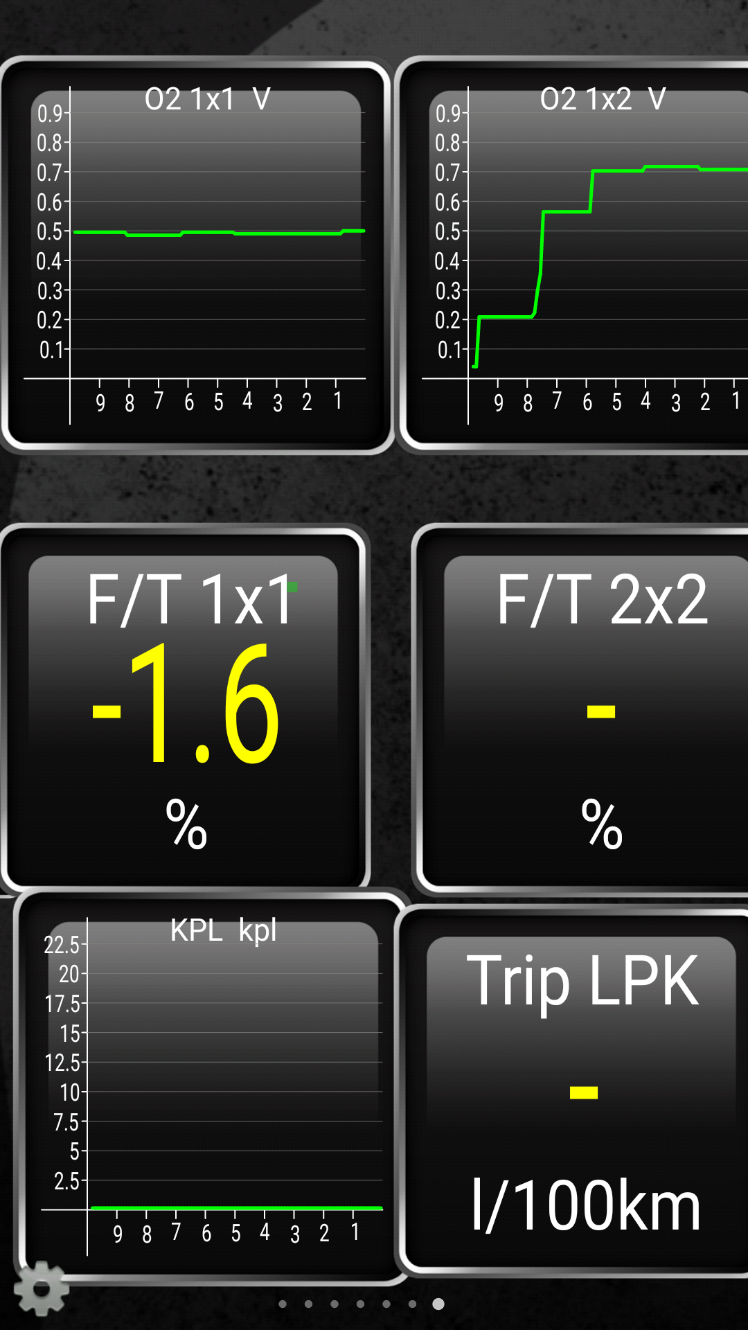

A few weeks ago I noticed though my Bluetooth obd2 reader that the voltage output for my front o2 sensor is reading a flat 0.5mv and barely fluctuating (pretty sure it should be cycling with fuel trim).
Thinking my o2 sensor was bad a ponied up and got myself a new sensor after install the problem still persists.
I started probing wires at the o2 connector to ensure that proper ground is there .. turns out i had very high resistance at the connector. Found it hard to believe that the wires are bad but decided to make sure I had continuity to the ECU connector. Probed all 4 wires and have 0 ohms between the o2 sensor connector and the ECU connector. This leads me to believe something has failed in the ECU.
My ECU sticker has unfortunately faded out and I cannot read the PN. I know that the engine management is Denso and my wiring lines up with the Denso wiring diags. Anyone know what ECU will mate up with mine? Is this just straight swap or is flashing involved? are there any alternatives?

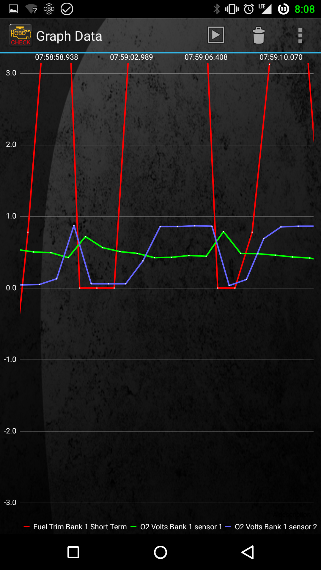

Happen to check for the +12v to the heater on the O2 sensor? Could be it just never comes up to temp. What is the refresh rate on the scanner you're using? It doesn't look sufficient for troubleshooting this. I'd tap the sensor signal wire and check with a multimeter or preferably an oscilloscope.
I know VIDA gives me 2 channels for the front and 2 for the back. Only the first channel of each is used. I would look to see what happens on the rear while in neutral accelerating and decelerating. It should fluctuate and so should the front if you just quickly blip the throttle.
Make sure the car's hot before doing this. Some ECU's run in a open/closed loop fashion - where they substitute values from a table until the sensor gives a usable (expected) reading.

I checked all my fuses and nodice they are all still good. I looked back through my codes and did see that the car threw a P1017 a few months ago which I believe is a ECM malfunction on fuel air. I've also gotten a p1032 "Air Fuel Ratio Sensor 1 Heater Control Circuit High Bank 1"
I have actually tracked down 12V to the heater and sure enough it is there - my o2 sensor heater also gets a pass on DTC. So I've been doing exactly what you say with the throttle and what i notice is taht the fuel trim seem to affect the rear o2 while the front o2 stays idle at 0.5mv. Sometimes blipping the throttle the front one will react.
Unfortunately I don't have access to a scope - might be able to see if I can borrow one from work and report back if I get to it. I tried the obd adapter I am using on an 850 and it showed the o2 bouncing up and down like it should. Pretty sure its just reading what the ecu tells it and the ecu has enough refresh rate to catch the change. I've got a feeling its the ECU seeing as its a brand new O2 and the wires are good all the way to the ECU.
I should also mention I've been getting a knock sensor code as well.. figured it was due to the engine running lean at times which I can see on the rear o2.

So I did some multimeter probing - the heater circuit is getting 12V but funny enough 3V is showing up on the 02 signal line from the ECU. When probing the O2 sensor with the car running I get very similar readings that show up on the rear o2 sensor on my obd tool.
That 3V on the signal line from the ECU seems odd...
