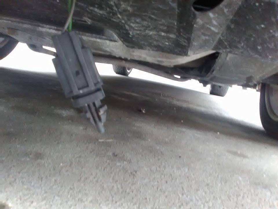

Thanks for another idea of where to look abscate. I would be expecting a P023 code for that also. It's doing a lot of raining here today and will likely not try to do anything on her today being how I lack a garage. Interestingly though, Coming out of work today I caught a glimpse of this? Any idea what we have here? See picture.abscate wrote: 07 Jun 2017, 05:18 These cars are too complex to diagnose by symptom, especially when they are spurious.

Ambient temp sensor,,,not a biggie, near the front right side of car?

Yup. Just your temp sensor. I think it goes in one of the grilles around the fog lights.
