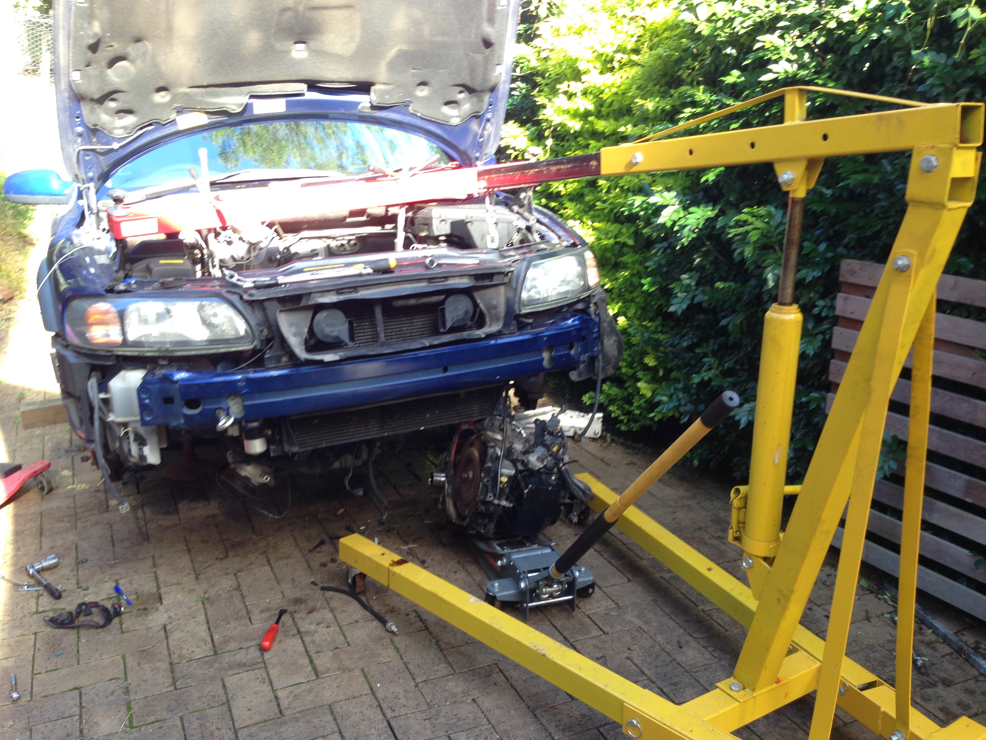

4. I launched into it, removed a plethora of engine components, ready to remove the engine.
5. I then decided that I should just lower a corner of the sub-frame and remove the valve body and give it a good check over. I found a few things that were of very slight concern, a couple of slightly tight valves, but not enough to cause a full "no drive" failure. Of course, the oil was very dark and horrible! But the VB looked as if it had a mod kit through it some time, the solenoids had aftermarket end caps.
6. Since the VB wasn't in that bad shape, I continued to remove the gearbox. What a mission!!! I removed a Subaru outback gearbox in less that 2hrs in the driveway. This thing was a huge job, there were so many things to remove to get access.
In brief the procedure I used was:
a) remove lots of engine wiring and accessories,
b) remove RHS drive shaft,
c) unbolt steering rack and sway bar,
d) remove cat support, take lower control arms off at ball joint ( I unbolted the 2 bolts holding the ball joint to the stub axle housing, instead of the 1 bolt holding it in the wishbone, much easier!),
e) support engine with a support frame across the engine bay,
f) remove sub frame (actually was quite light and easy to handle by hand),
g) Drop engine and gearbox far enough to work on it,
h) unbolt drive shaft from angle gear (jacked the rear off the ground to rotate when necessary, dropped it when needed to hold the shaft still while unbolting.)
i) Unbolt and remove angle gear. No need to unbolt the exhaust at the turbo, it has enough flex and since the mount on the cat is removed.
j) unbolt most of gearbox, leave 1 bolt at the top in
k) unbolt flex plate bolts through the starter hole, there are 6 torx bolts, turn the engine at the crank pulley which is now easy to access since the engine is dropped a bit.
l) connect my engine crane to the gearbox - there is a lift point that a shackle can go through.
m) remove the final bolt and wiggle and jiggle until the trans comes free
n) drop the trans and roll it out under the car. I didn't actually have the car that high, just mounted on stands slightly behind the sub-frame mounts. I'll post a pic...

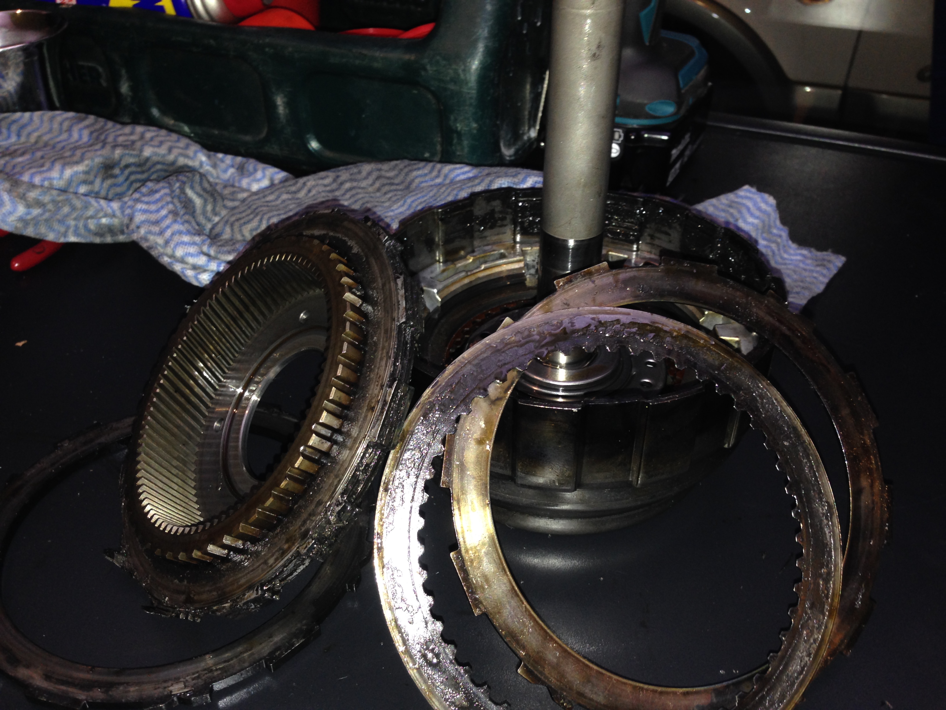

The first few clutches I took apart seemed in OK condition, nothing obvious. All the bearings and gears looked immaculate, even though the oil was very dark. At this point I decided I would take things to a very helpful local automatics guy to advise my on the amount of wear once I had a few more things removed.

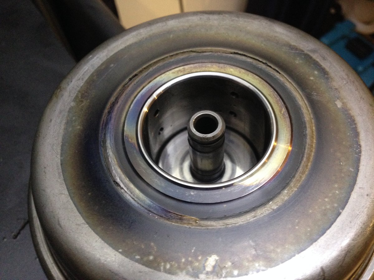

I then noticed a build up of stuff on the turbine shaft hall sensor, closer exam it seemed to be metallic particles. Then I thought I should run my finger around the lower area of the casing, which was full of grit. At that stage I knew I was sure to find a serious failure somewhere.
Turns out that when I pulled the input shaft, that the drum appeared to be discoloured. Then, the steels and frictions where really difficult to remove, they were all caked together and lots of grit around. When I did get some apart it was very obvious that this had been seriously overheated. All the frictions were in a real mess. See photo.
I took what I had dismantled to the Automatics service guy, he mentioned that these often crack the housing of the C1 Drum, he inspected and found it had (see photo). Apparently, they crack, this results in loss of pressure on the C1 clutch, and then burning of the frictions. I also would expect that this might start off slight but quickly get worse, here's my theory; frictions start to wear, filter starts to clog, oil pressure drops, things spiral to worse very quickly from there.
From here, I'm going to strip down the rest of the trans, assess parts needed, get parts quotes and see if it's feasible to resurrect this car.

Exactly the same damage on that transmission as in my now sold 2001 XC70, with cracked drum and fused friction clutches and mettalic grit.
Make sure you get ALL the grit out of there with solvents and replace the filter.
I found a good used one and threw the old one out.

I would suspect a recurring heat buildup issue occurs first, the steel becomes brittle, eventually the drum cracks and obviously snowballs fast from there-frictions burn up probably with a matter of 50 miles or so).
Your AT tech didn't have any insight as to the root cause did he? Depreciated fluid? Low pressure/leaky valve body seal/bad solenoid?
