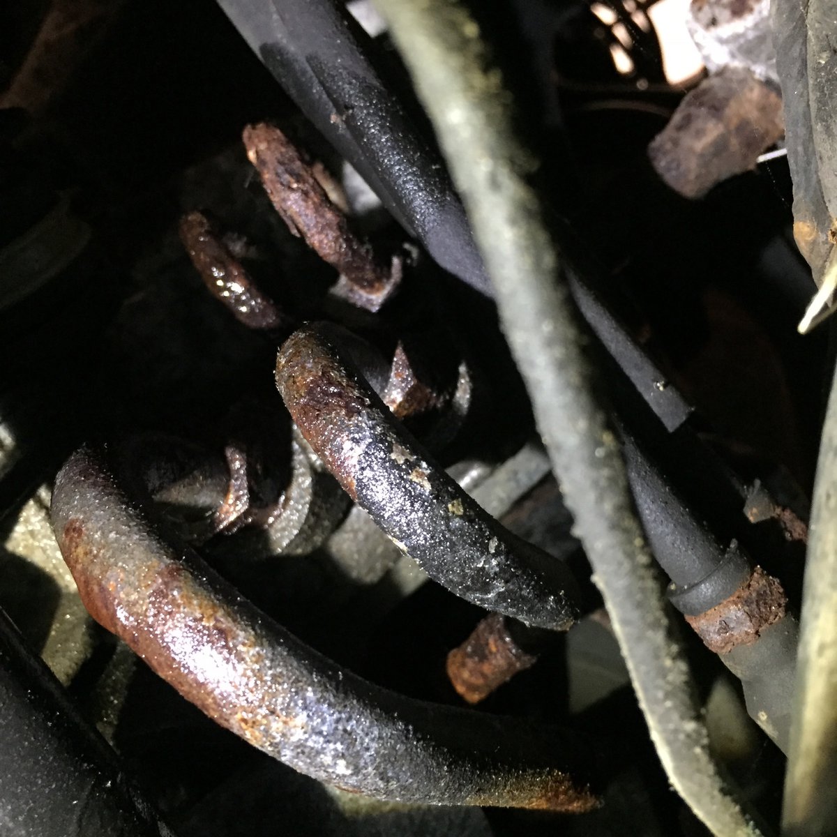

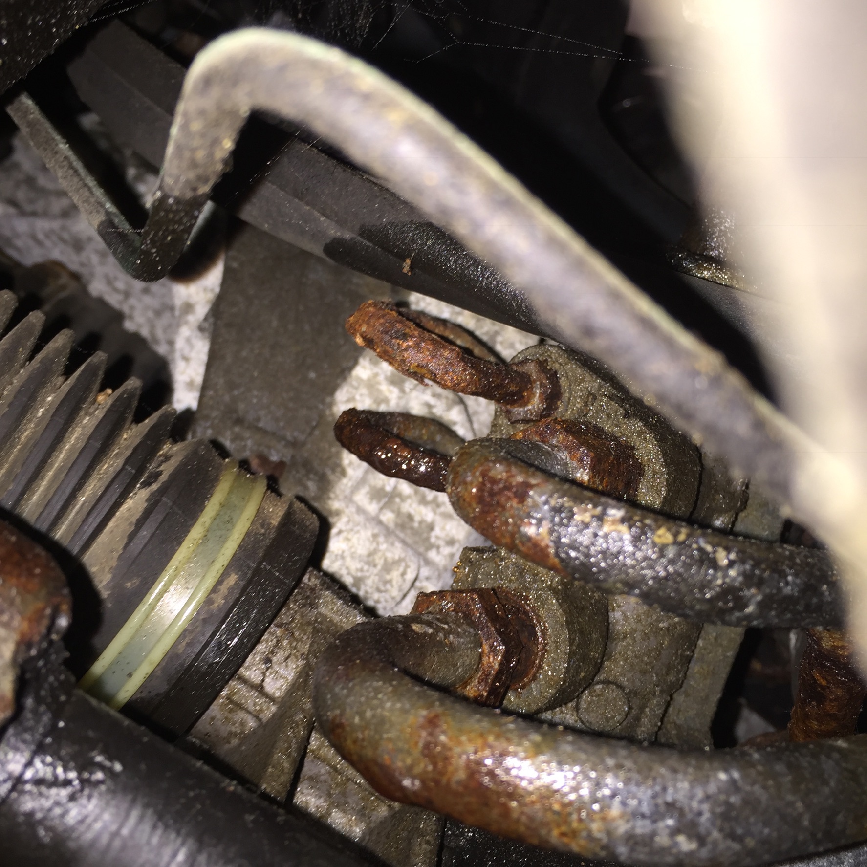

Have an 850 Volvo with leaking fluid lines (see pics). Does anyone know where I can source these lines?

Thanks for the notes. The lines that are leaking are not the pressure and return line from the ps pump. The lines that are leaking are the fluid lines from the steering column part of the rack to the rack...sometimes called oil lines. If you look at a picture of a steering rack you can see these lines. IPD, FCP, the usual places do not sell these lines separately. But, FCP was able to find the part numbers and then I was able to source the lines. Should be here in a few days.

That's what I thought, it was hard to tell from the picture, which is why I posted both links for the diagrams.
