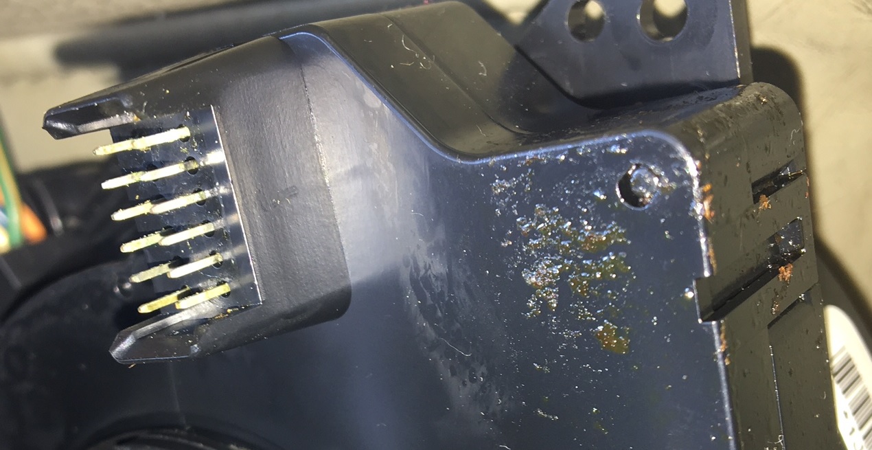

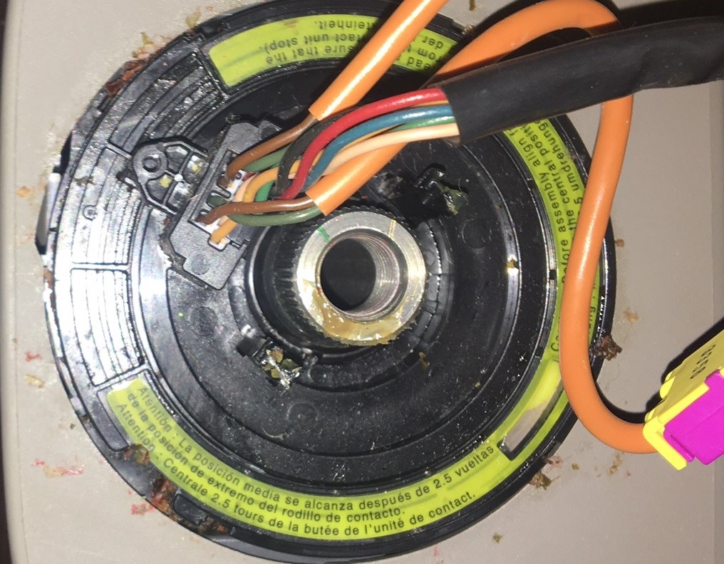

Success! As I thought the toxic smoothy or taco sauce caused damage to various electrical components. I have attached some photos. I removed the airbag, steering wheel, clock spring, left and right stalks and steering wheel module.
Clock Spring showing the remnants of some spilled liquid.  Seeing the mess I took more components off.
Clock Spring.jpg (265.56 KiB) Viewed 2647 times
Removing the clock springs I found the pins that plug into the Steering wheel module board were corroded.
Looking at the Steering Wheel Module connector I knew I had an issue here also.  I removed it and clean it up and added some dielectric grease to prevent further corrosion
Steering wheel module connector.jpg (154.06 KiB) Viewed 2647 times
I replaced the Clock Spring with a like for like used unit. I did not calibrate anything, I will once I get the alignment, but after driving the car about one block the anti-skid light turned off by itself. So the system is now fully functional and communicating.
In the end I did not replace the original steering wheel module I had purchased with the used unit so no need for the possibility of a software update.
I wonder how many failures are caused by spills that end up corroding the connectors. Although I was tempted to try and clean the original clock spring pins to see if the corrosion was the cause of the issues, having the used working unit on hand sent me down the easy path. It didn't make sense to put it back to together only to take it apart again. But, if one finds similar conditions and one has not bought a new unit - it would be worth a try.
