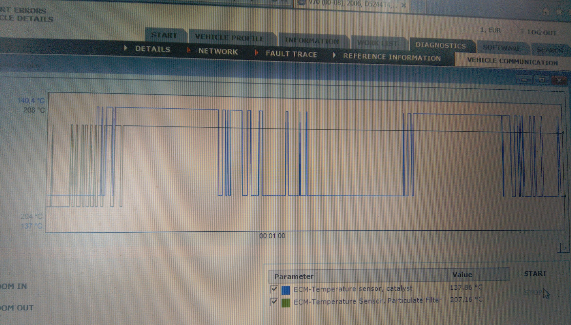

Further testing.. Upper temp sensor which is accessible behind engine without car lift, shows ~300Ohm when engine has idled about 1hr, that should be in line with specs. When logging, this sensor constatly changes values at least little, looking "live" so i think this might be ok.
Now i noticed particulate filter temp sensor is is long times freezed drawing straight line (picture) although responses quite rapidly when i press gas pedal. So i think i'm going to replace that first. Now i just have to figure out right part number, 4 choises:31370464, 31370463, 31431045, 31431046

Looks like i got this sorted out, two days without fault coming back. Replaced both sensors, on dpf right sensor was 31431046 and first sensor right behind engine was 31431045. Dpf sensor was "easy", 17mm open end wrench and 50cm steel pipe as extension did it, but only after heating it first with torch. Sensor behind engine was "easy" too, but it is in so tight place, it was impossible to ger enough force to brake it open with open end wrench, so i just cut wires off coming from it, so i could undo it with 17mm deep socket and long (60cm) extension and extra lond socket wrench. New sensor was tightened with open end wrench.
