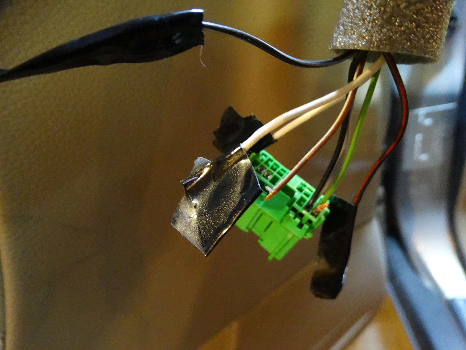

Anyway i almost thought i could fix the problem after looking at the haynes wiring diagram, the diagram shows wires that control the memory going to the mirror, so i started pulling wires trying to disable the system however with ever wire pulled the mirror kept on moving by itself.
At this stage disabling all motors using an on/off switch seems to be the only option other that a software update

Ive tried numerous ways of setting the memory, at this stage i believe they are Non-memory mirrors on a car that has a memory module (as per wiring diagram) , i like my off side mirror when reverse parking so i can look down at the kerb. For a fix i intend to install a relay to act as a switch that activates the mirrors only when the key is set to acc as the mirrors behave after i open the drivers door and put the key in the ignition.
