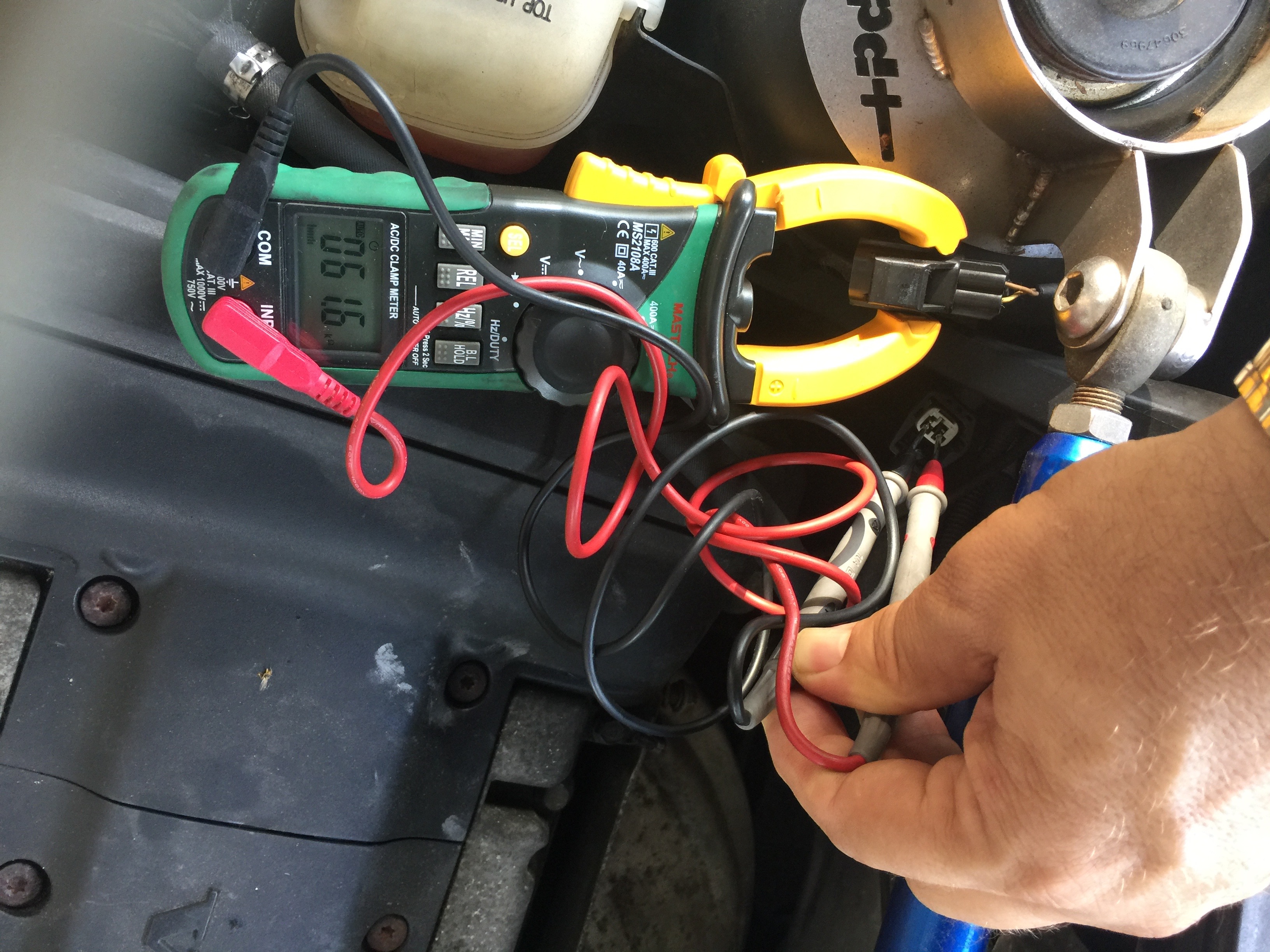

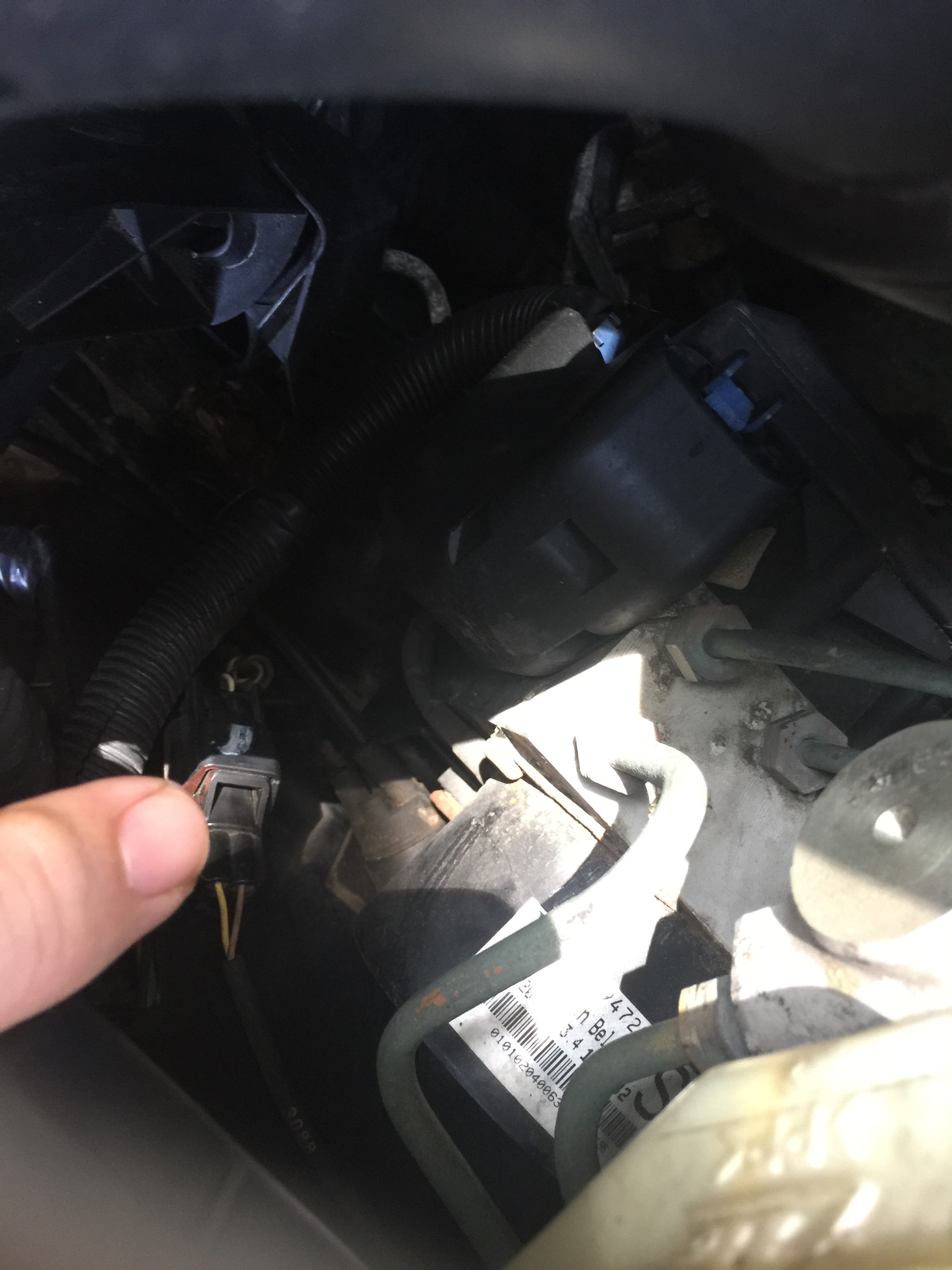

Where to test ABS sensors without removal - under hood
IN North America - LHS connector tucked under fuse box on 1999
RHS connector visible on shock tower
