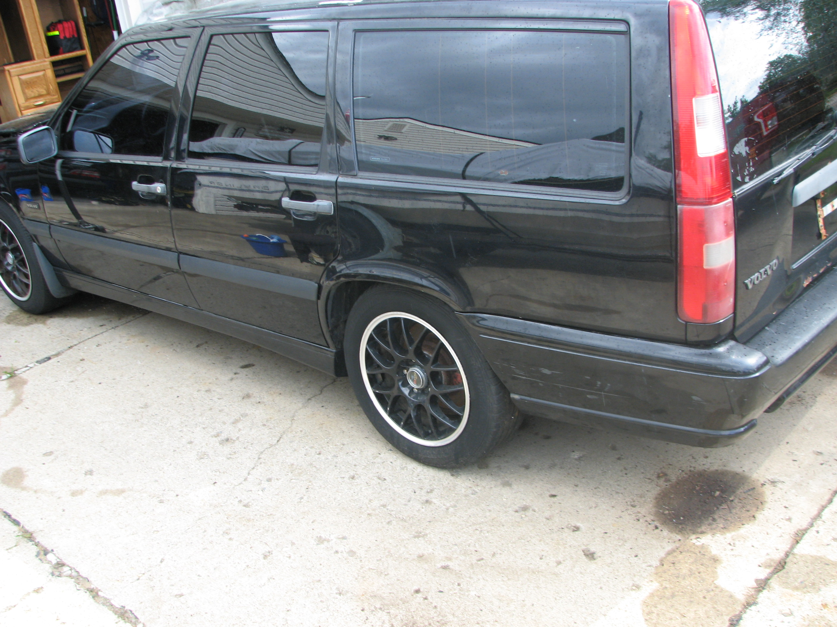

I was getting the Black wagon on the road today after getting it respectable in appearance with a new door and rear bumper from a '99. It looks good!
So I had done an oil change, and a trans drain and fill..
It had been sitting for a year and a half. Not too long.
After less than a mile or so, leaving a stop light, about two blocks out the trans started to slip and then completely disengaged. No further forward motion in any gear.
I checked the fluid level and it seemed full at the cold level which would be appropriate after a mile of driving.
Pulled trans codes on OBD I ("94) gave a missing speed sensor error?
Towed it back to the house I plan another drain and fill tomorrow.
At a loss.
Did not have issues before the drain and fill.
