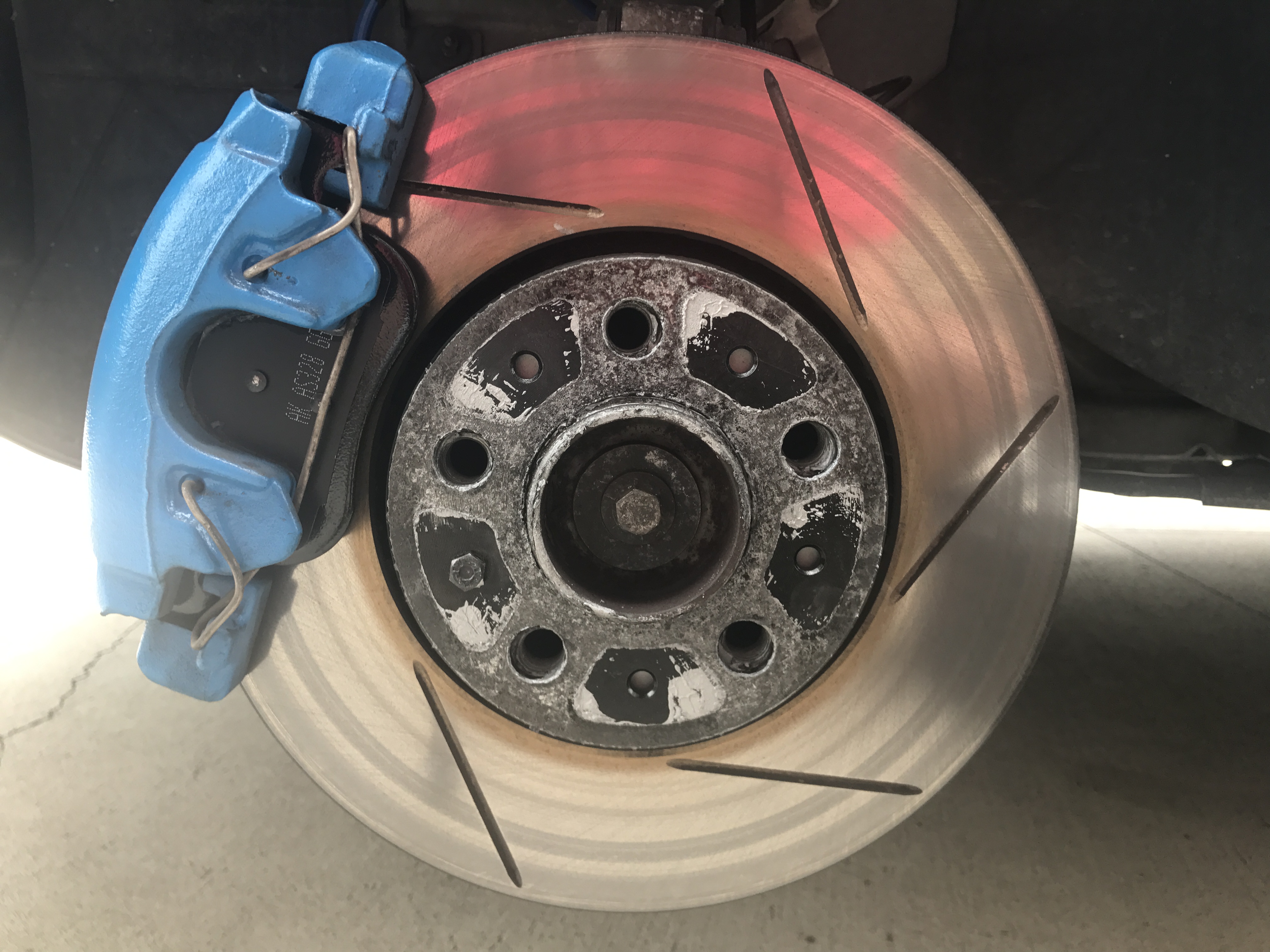

The fact that rotors/pads were changed also brings in the caliper outboard anti-rattle spring being installed wrong. That tips caliper and makes pistons retract much more. It results in low pedal/mushy pedal.
A picture through holes in wheels would help here.

When I bought the car at 114K miles, the brakes were adequate. Rear rotors were pretty badly scored. However the car stopped okay. Decided to ignore it until the rear pads wore out, because the car had more important issues. Then did the lines, rotors and pads. The car will stop quite nicely now. However I still have the soft pedal.
I tried cycling the ABS on pavement before posting. However yesterday evening I found gravel roads and made sure the pump cycled. Soft pedal remains.
I will check on proper clip installation and post a photo later on today.

CedBobKing, as above the first thing to inspect for soft pedal upon a pad change, is the spring goes correctly

So... about those springs.
Before
After
Pedal now feels okay to me. Now I'm just sad that I scratched some of my pretty blue paint.
Thanks so much for the assistance.
