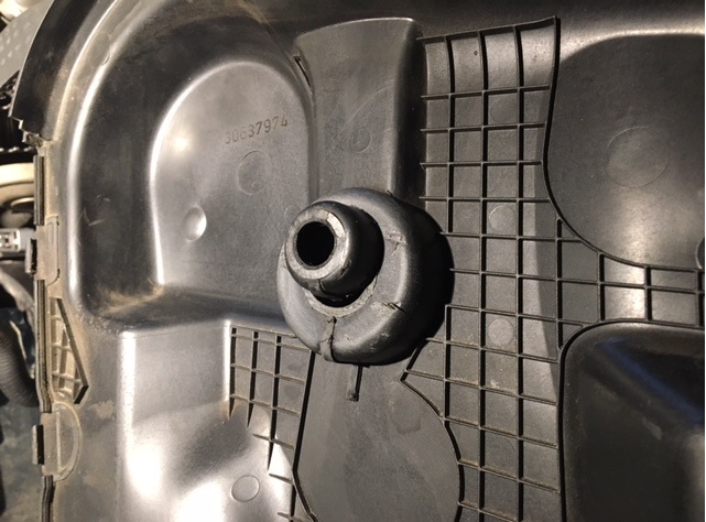

Back to business. I trimmed off part of the plastic on the timing cover to make sure I would not have any fitment issues. It also made it easier for me to pass the hose through with my modifications.
Timing cover modification.jpg (104.51 KiB) Viewed 3131 times
From the picture you can see what I cut off. All the way down to the flat. I left the portion I cut off in the picture, but offset for clarity.
