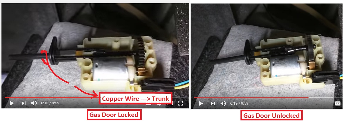

My electric motor (for the gas door) works 99% of the time, there is 1% of the time it does not work.
So I use a copper wire (12 gauge solid copper wire used in household wiring), wrap it around the end of the motor (see the youtube video below).
The other end of the copper wire is in the trunk.
Whenever I the door does not open, I simply open the trunk and pull on my ghetto copper wire and bingo, the fuel door opens.
I will take some photos when I have time.

I borrowed some photos from the video to show you my ghetto fix (wire in the trunk).
Once you see the video above, the plunger extends (LOCKED) and retracts (UNLOCKED).
So, wrap a wire as shown and whenever the gas door is stuck, open the TRUNK and pull on the ghetto wire to release the gas door.
PS: Your other option is to remove the plastic tab on the gas door itself, this way the door is never locked, but you run a tiny risk of vandalism.

Oh thanks for the photos. I guess that works with a worm gear?
I'll have to check mine out too then. Good idea with the wire, i have some steel wire around too.
