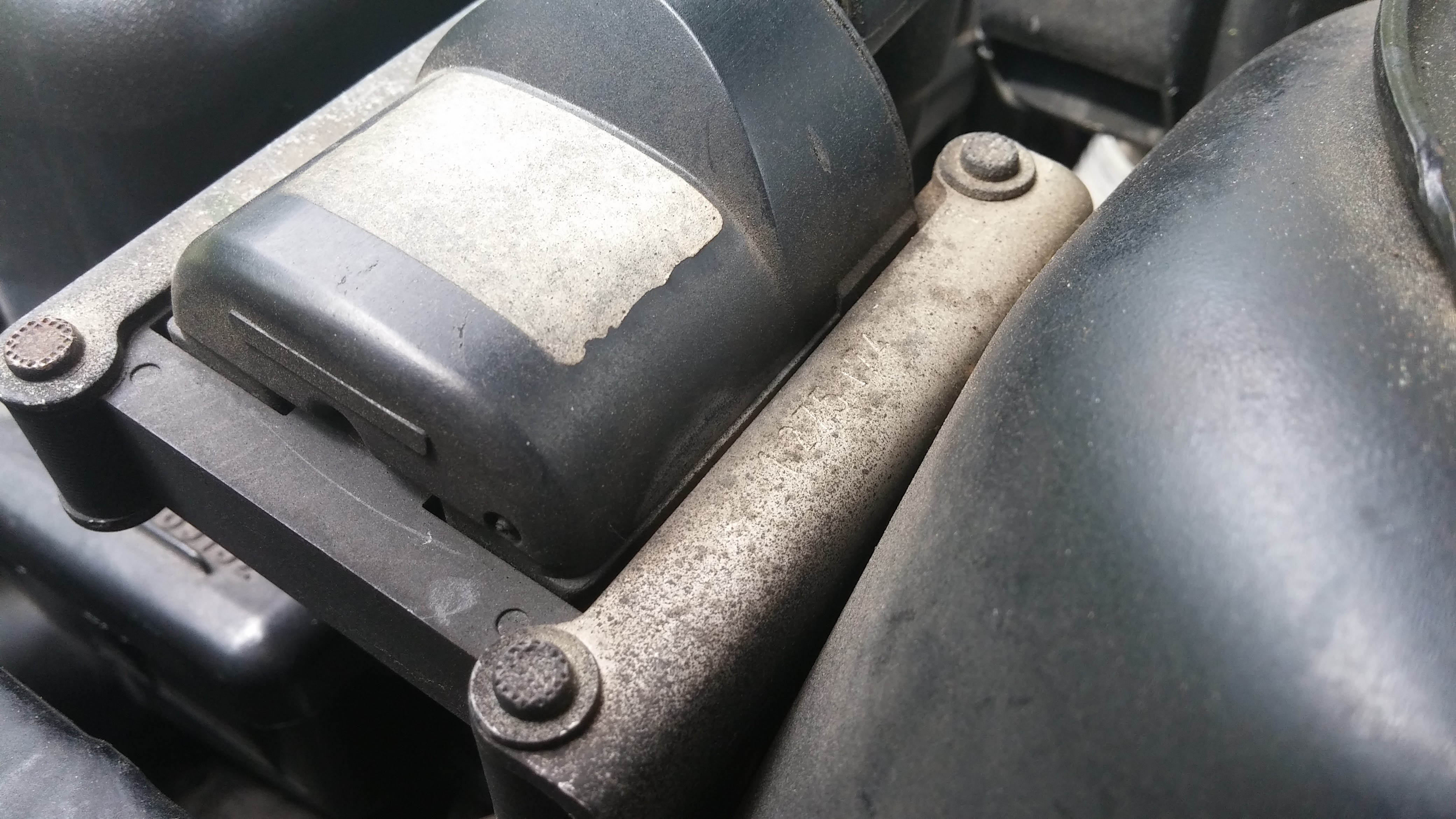

Also, this is possibly unrelated, but is a quiet buzz from the ignition coil normal? It also has some white residue on both the front and back, not sure if it's burned or just from water or coolant splattering it at some point.

Don't worry about coil...it either works or not.

Good to know on the coil. I wasn't sure if that would cause an intermittent miss or if it would just fail.

The white residue is tears collected from the floor of the BMW parts counter.
