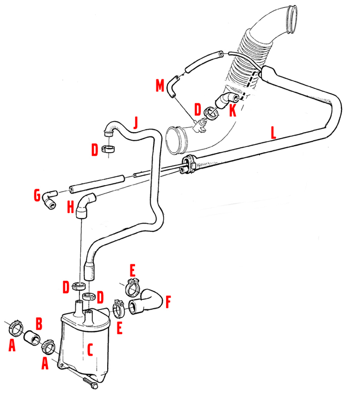

Sounds like a plugged flame trap (PCV system). When they get old and full of crud, they cause backpressure to build up in the crankcase, blowing oil out the dipstick tube and possibly - eventually - causing the rear main crank seal to fail.
The flame trap is a black box on the front of the engine with a few hoses coming out of it. You have to replace it. Both IPD and FCP Euro sell the kits for this, and you should do this operation periodically if you want the car to run right.
