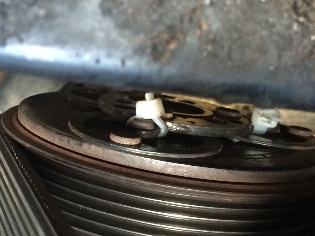

My 04 s80 air conditioner will work for a few minutes and then blow out warm air. I cut the air conditioner off for a moment and then back on and it's cold again. Any advice on the problem? Thanks

Sounds like Gap problem

If it's just like outside air, look at the compressor pulley, it has a plate on the side (the clutch), see if this plate turns once in a while with the pulley. If it stays off a good minute, the gap may be too large (google up volvo a/c compressor shim)

Gtaylor21 wrote: 14 Aug 2017, 10:44 My 04 S80 air conditioner will work for a few minutes and then blow out warm air. I cut the air conditioner off for a moment and then back on and it's cold again. Any advice on the problem? Thanks
A few wire ties on the compressor will fix this, it's quite common.

I did this fix on my Volvo 3 years ago and everything worked great until recently. Now the ac is intermittent while driving. It’ll work for five minutes or so then cut off. Sometimes the compressor will engage if I can make the car do a hard shift but then it goes out again after a minute or 2. Is this a matter of simply replacing the zip ties?

Time for a new compressor

Just look again at the gap, make sure it's the same around the clutch disk. It may have gotten too large again.

Rather than zip ties, do the job right and remove a shim or two from behind the plate to get back to specs.
