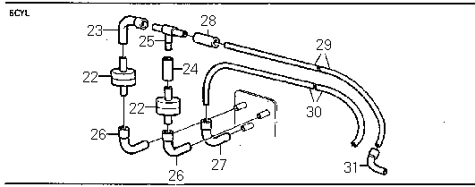

Nothing inside vehicle except vacuum pots to redirect air flow...here's how its setup on firewall

1) I had looked under that volvo 960 post earlier and looked under my s90 for reservoir. No luck. I will look again. 2) thanks for the firewall diagram. That is where i assumed problem was originally. Replaced one of the check valves that i found was bad and a couple of the vacuum lines that appeared deteriorated. 3) cutting out means that under acceleration the air flow from vents in car either greatly diminish or disappears altogether depending on how hard the acceleration is. Actually it also does this even if the AC is NOT on and controls are set just to blow regular air. Have had car a long time. This is a new phenomenon.

Years ago, in many vehicles, a mechanical slider (or rotary) switch controlled a vacuum switch to activate various "vacuum bellows" for redirecting air flow (vacuum bellows: 10, 20, 21, 21).
Newer vehicles, I don't know. Diagram shows (2) servomotor and a (13) solenoid valve. One might control hot water, and the other might be an electronic vacuum switch.
