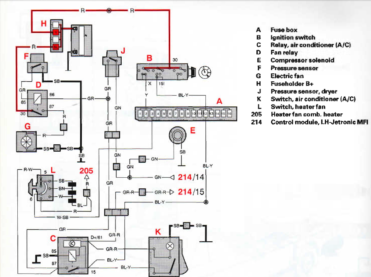

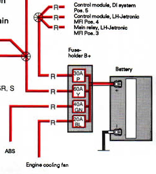

Note - Diagram is for late model 1993-240, which at the battery, has four fuses. So, I'm explaining for 1993-240 late production model, which has an electric fan in front of radiator. If yours has an electric AC-fan, I might be able to explain it, if I have an electric diagram.
Below Photo Explained
At point D (Fan Relay), all it takes is a ground circuit at terminal 85 on relay (D) to activate fan, if AC is turned on, and there is power at terminal 86 on relay (D).
1. With AC Working - Since fan is grounded (SB Wire), all it takes is a power wire attached to fan (G) at R-wire; so you hookup a switch inside vehicle with 12-volts hooked to it on say 12 gauge insulated wire; I would also put a 20 amp inline fuse on this circuit.
Issue here is only inside vehicle circuit to hook wire to would be 25 amp heater/AC fan-motor, which would be fine, if AC/Heater fan was not running. In other words, too much current on one circuit.

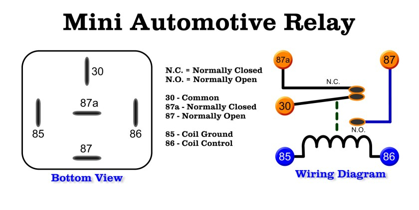

2. Another Method - At battery, with a 20 amp inline fuse going to a Bosch type Relay at terminals 30 and 86, with feed wire (87) going to fan, then from inside vehicle, use a toggle switch that is grounded on one side. With a wire running from other side of this toggle switch, this wire would activate relay (terminal 85) when toggle switch is flipped.
After this photo, I will explain relay wiring more...
Relay
At battery, a 20 amp inline fuse would hook to relay's terminals 30 & 86
Terminal 87 would be hooked to electric fan's positive wire (Item G @ R-wire)
Terminal 85 would have a wire going to inside vehicle, and hooked to a toggle switch that is grounded on one side.
Terminal 87a is not used
