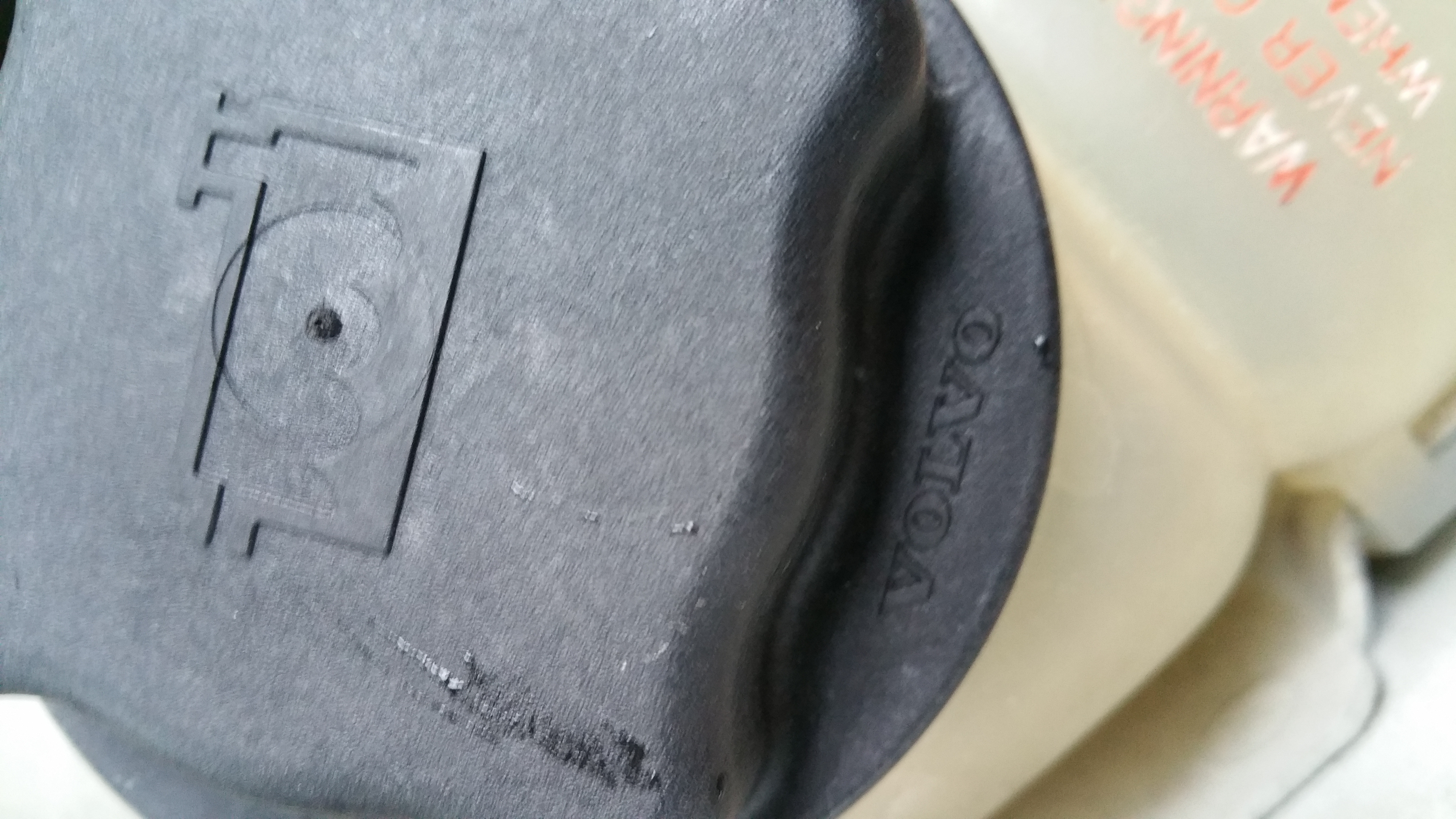

I had a 1998 V70 1998 through 2002 and among the car's quirks was a antifreeze smell in the ac heat system and slight coolant loss over a long period of time. The Volvo technician at my dealer who I might add worked on my mother's Volvos from sometime in the 1970s. My point is he is someone I really trusted and his advice was sound. He said we could replace the heater core and some pipes to start with as the car was under warranty, but I would likely continue to have trouble, but could replace the radiator cap with Volvo's black cap which holds half the pressure as the green and would end the trouble. He was right the smell went away and no more coolant loss.
Every car since, the 2002 S80 and my current car my 2004 S80 I replaced the green cap with the black cap for a 240 straight from the parts department before driving off the lot. None of those cars ever ran hot or had that antifreeze smell come from the ac heat system. Also my 2004 had the complete factory cooling system until this year 140k when I had the hoses and radiator replaced by Volvo. The original plastic tank is still clean and Volvo replaced the thermostat for the first time last year with the timing belt at 109k as preventive maintenance and Volvo has replaced the coolant several times over the years.
So maybe if you used Volvo coolant you would not get that crud, and maybe the black cap would take care of the slow leak. What could it hurt? I will take some pictures of my coolant jug and post them tomorrow as it is dark outside and the hurricane is dumping tons of rain at the moment. June

Sure can, off the Volvo parts ticket part number is 1357775-4 : FILLER CAP $33.94 straight from the parts department at Volvo. Keep in mind this is a factory cap for I believe a 240/740/maybe 940 not sure, probably 1990s since my 98 got one in either 99 or 2000.
I moved to North Florida from South Florida in 2005 and started using the Volvo dealer here in Jacksonville and my car has always been serviced by one particular Volvo Master Technician who has never said anything negative about the lighter pressure cap. Or tried to put the green cap back. Volvo puts a 50/50 mix of Volvos brand coolant. I don't experience after boil, overheating, or any boiling.
In fact July 2016 during the week of that heat bowl where the Midwest experienced 120° ambient temperature I was on a trip to a funeral and the car had the complete factory cooling system except the thermostat which the original never failed, and of course the coolant. All hoses, radiator, heater core were factory with 12x,xxx thousand miles and even one 120° afternoon the car idled for hours with the ac on for my dog without any problem. The hood was so hot it could not be touched but the interior was ice cold and the gage was right on half way as always. I then drove the car in traffic directly without shutting the engine down.
Also on that trip I ran the car in excess of 100 miles per hour through Oklahoma which is a big hot desert and also at that speed the dash readout said the temperature was between 110 and 120° and no boiling that day either, or did the gage ever go above half. Since the car didn't boil or overheat once, I doubt the black cap is going to cause the car to boil.

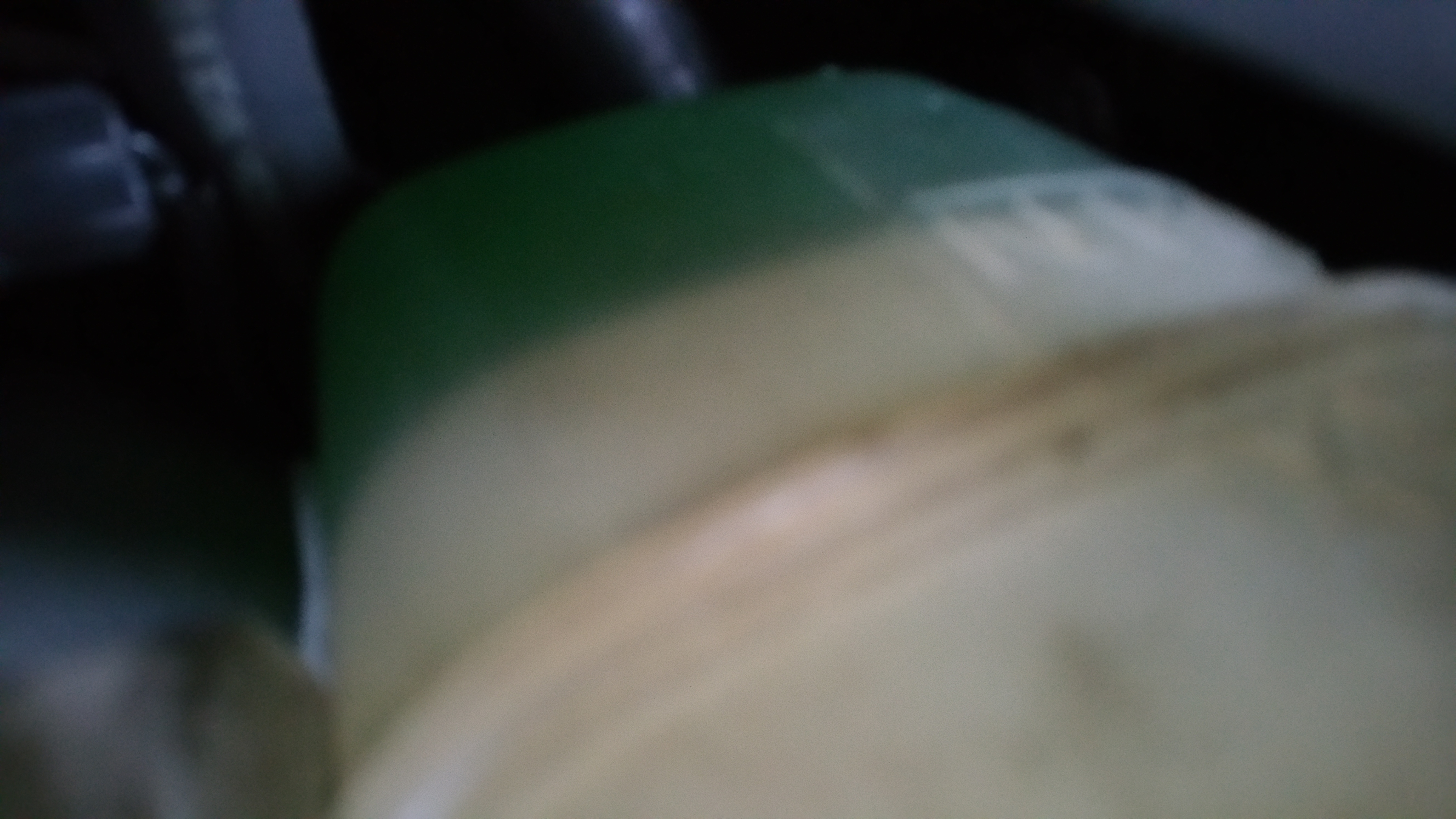

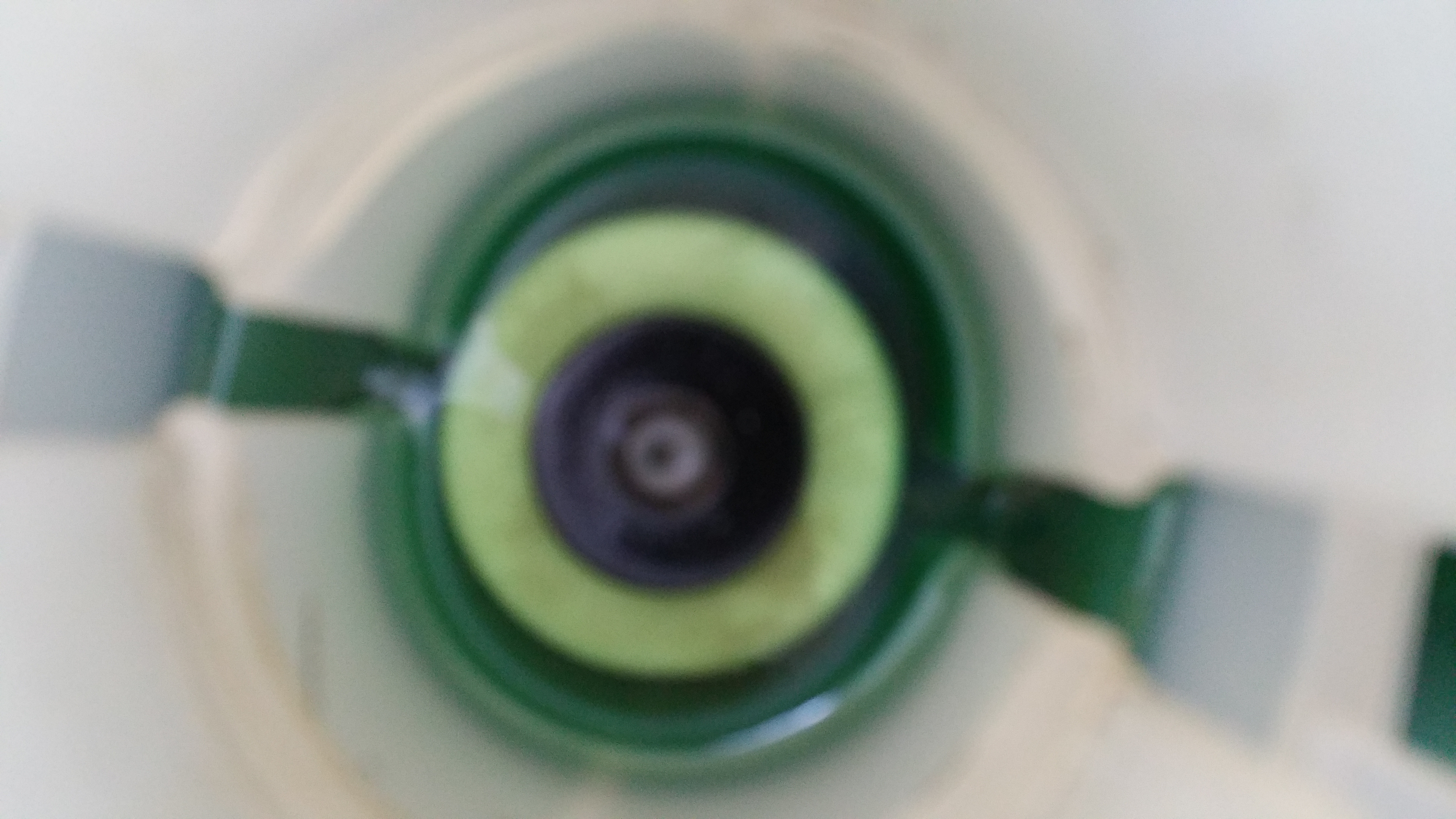

Pics of my nearly 14 year old coolant tank on my 2004 S80 T6 that has 143k. Keep in mind the coolant should be changed every couple of years or 30k once the factory fill has been removed. I understand the factory fill is pure (contamination free) which allows for a safe long change interval.
Putting non Volvo coolant is just not a good idea in my opinion as I have been told that it has is designed to lubricate the water pump and will not react to any material in the cooling system. What you are using is likely changing color as it reacts with some part of the cooling system and the sludge is likely bits of whatever is being disolved by the coolant you are using. June

Thanks for all the insight everyone. Deteriorating rubber hoses. Would have to be my heater hoses (which I've been putting off for a few thousand miles...) will replace them and cut them to see if there's any deterioration. Would be interesting to find some rubber being eaten away. Thermostat's a new Wahler that I installed 3 yrs ago, too.
So June, you're a black cap aficionado? :) I'll definitely keep an eye on this. Like I mentioned, temperature on this car is so constant. I can't believe your expansion tank is the color it is. Do you think the Meyle tank is discolored due to an improper mixture and/or lower or higher boiloff point? This certain requires a little more research. I think I recall reading something on here about black caps. I think I remember reading that folks who race and run Water Wetter need to run black caps in P80s? I could be mistaken. Glad your safe and sound.
I just replaced the coolant in my father's 2009 Honda Accord at 80K. Oh wow, was that coolant beautiful. It had gotten darker (unlike the Pentosin NF which gets lighter) but clean as a whistle in there. Replaced with OE Honda coolant because, well, he picked it up! :)

The mechanic who insisted Volvo should have stuck with the black cap pressure as back in the 1990s to save technicians grief of weeping o rings and heater cores as I understand the 850/70 series in the 90s had problems with weeping heater cores. He was and is a Volvo Master Technician at my old Volvo dealer. He did that trick to solve the coolant weeping rather than ripping my dash apart. If I didn't know him personally he likely would never had altered the original equipment on a customer car in for service and would have had to replace the heater core and pipes. Also my tank has only had Volvo coolant, Maby the coolant you are using is reacting to the type of plastic the tank is made of casting the discoloration and sludge. June
