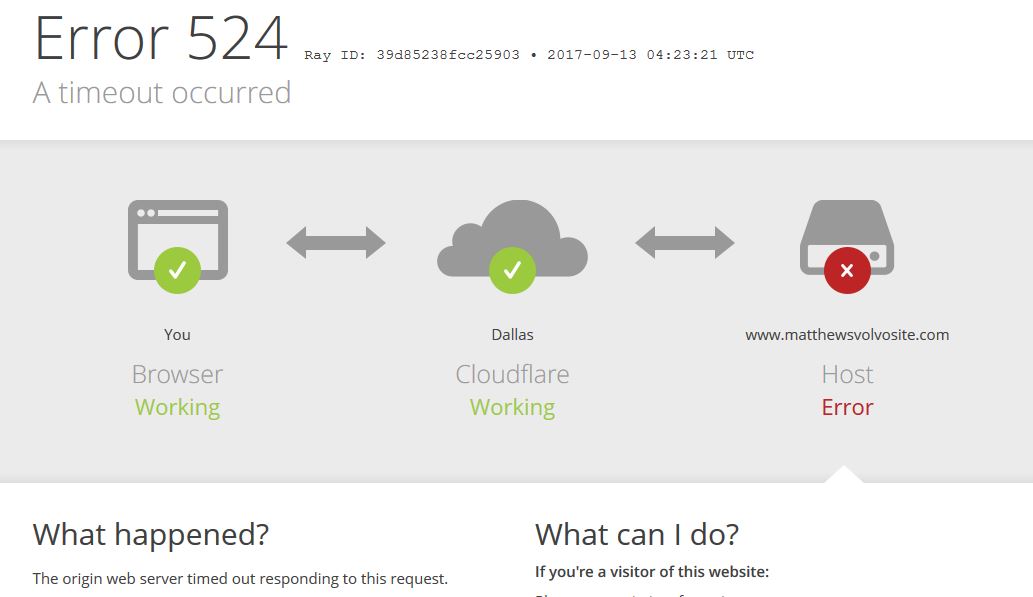

Wow...I see my post never made it!
I recall something about a MVS server issue..'not responding'.
Bummer......
Bummer......

You keep having problems with that! Tell Matt to fix it!sleddriver wrote: 14 Sep 2017, 12:42 Wow...I see my post never made it!
Bummer......

bmdubya1198 wrote: 14 Sep 2017, 15:56You keep having problems with that! Tell Matt to fix it!sleddriver wrote: 14 Sep 2017, 12:42 Wow...I see my post never made it!
Bummer......

I've had that problem a couple times in the past few months. Strange.

Cloud flare occasionally is the issue - even though they claim the remote host (server) isn't responding. Occasionally this happens due to a server being under a big load - such as site maintenance of databases or backups.
