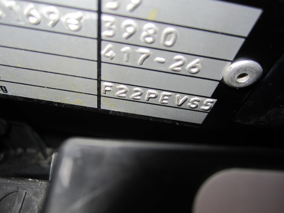

If you have an AWD (especially and XC) I would be really surprised if you don't have Nivomats at the rear. They look like regular shocks with a rubber boot at the bottom and fatter than a normal shock.
The lowest string of 8 numbers/letters on the RHS of the Vin tag by the battery is where you get the info for your spring/shock combinations. In the case of my 2000 V70 base these numbers are:
F22PEVS5
First 2 digits 'F2' are the front spring and strut identifiers. Some of the websites will give you this to convert to a color band on the spring and sometimes the shock.
3rd digit '2' identifies the front anti-sway bar part number.
4th digit 'P' identifies the rear shock
5th digit 'E' identifies the rear spring
6th digit 'V' identifies the rear anti-sway bar part number
7th digit 'S' identifies the 'bump' rubber for both front and rear
8th digit '5' identifies the Steering rack type. 4 = TRW, 5 = SMI . Do be careful with this last number as the steering rack can be changed to the other brand by changing the inner and outer tie rods (can't remember if you have to change both inner and out or just one of them).
If you have difficulty, post the 8 digit number up here and I will try to keep an eye out for it and identify the spring and strut or shock combo.
F22PEVS5
