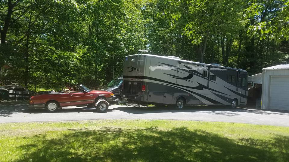

I spend a lot of time on the road with my RV. We'd decided to take the S80 with us this winter trip (five months of exploring) and we use a tow dolly. Any hints or suggestions? Things I want to avoid:
The car applying brakes/parking brakes for whatever reason.
The alarm/security system activating due to angle and vibration.
Anything else that might become a problem.
Anyone do this, and any thoughts.
The 2016 S80 is FWD, with electric parking brakes on the rear wheels. Front wheels are off the road on the dolly.
Dora with Saab.jpg (119.04 KiB) Viewed 793 times
(I know, that's a Saab--forgive me!)
