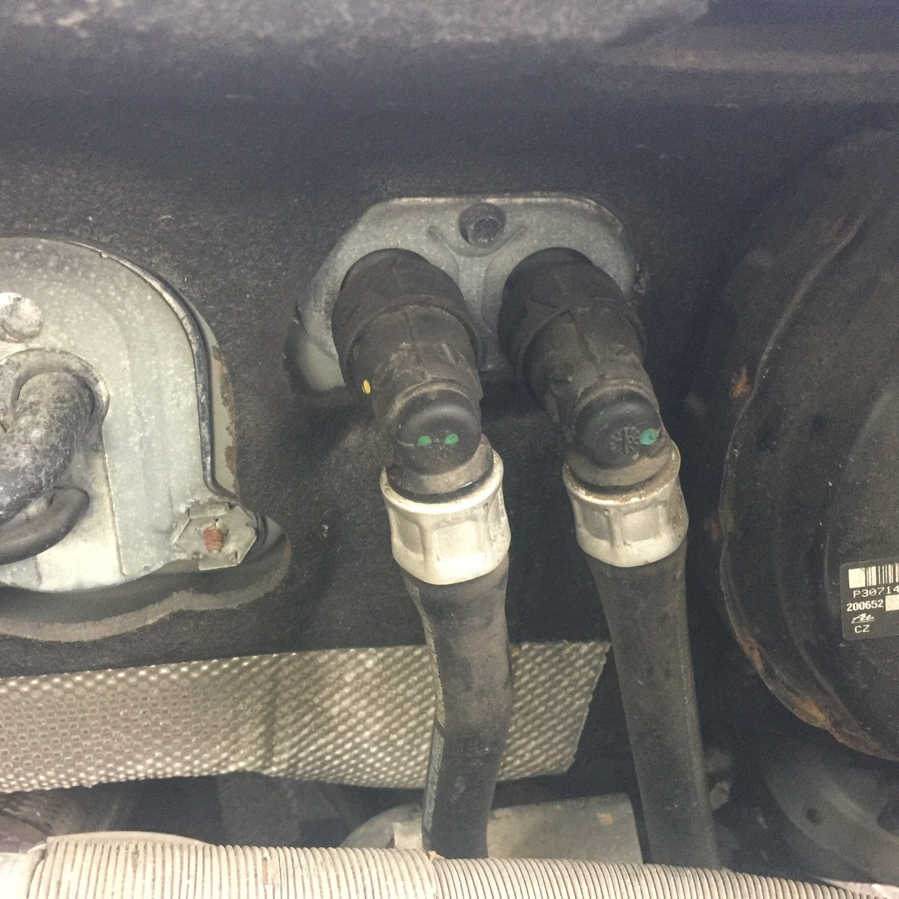

Well they defeated me working my clutch job
VIDA DESCRIPTION
Turn disconnect toward arrow while pulling.
Any hints?
P2 Clutch job heater hose quick disconnects?

Persistence. You need to squeeze them in exactly the right position at 180 degrees. I often use a puff of WD40 as I twist because the hoses have hardened.

I'm not even sure what to compress and what I'm twisting.

The force required is pretty high if they are old hoses. I must admit I cut them the first time then purchased new ones so I could see the mechanism close-up. IPD have some budget priced ones that I've used but I consider them a one-use quality in terms of the quick release mechanism due to inferior plastics.
Perhaps bypass the heater core then go back to it later?

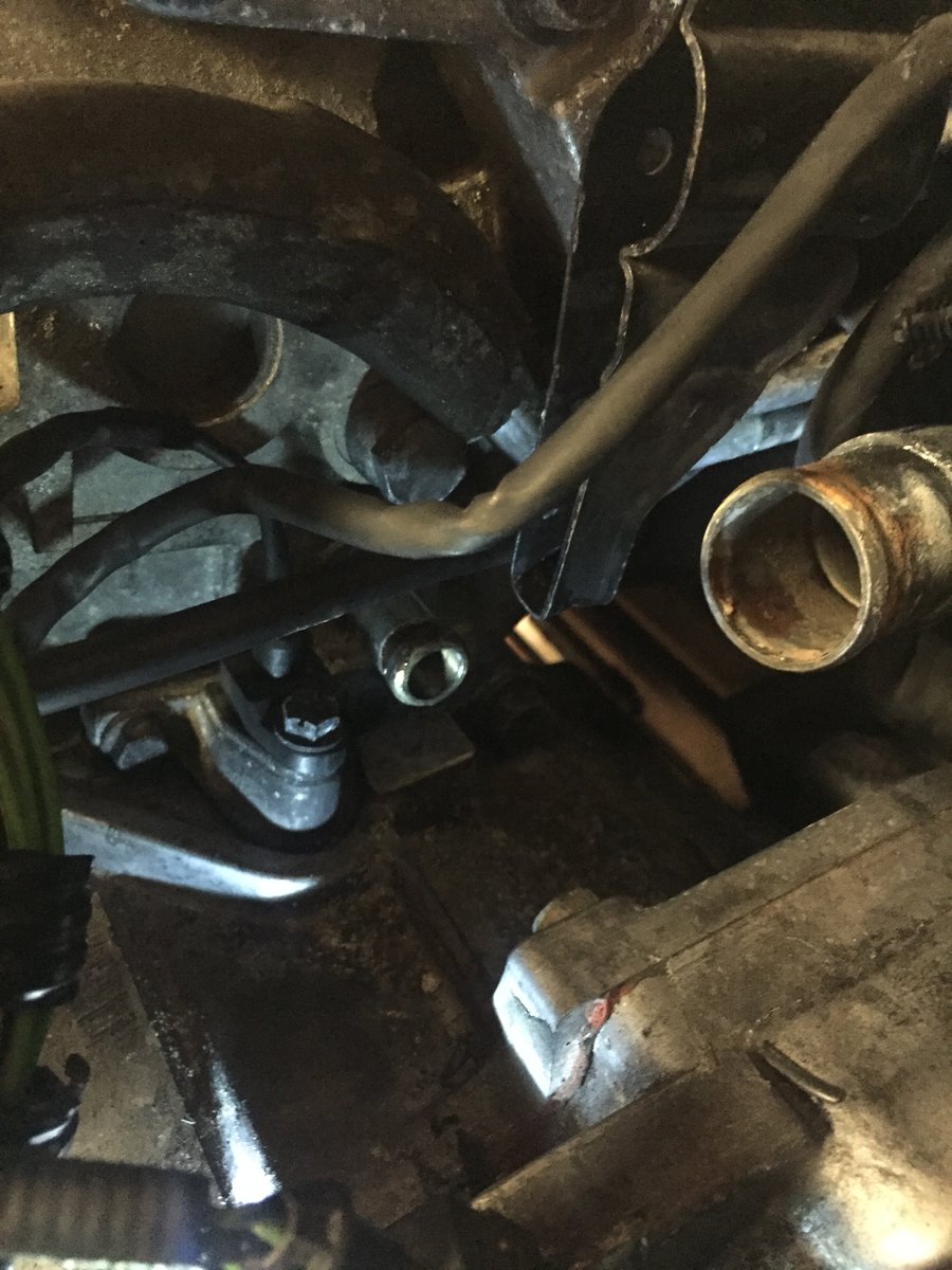

I can release them at the block ..I just need 4 inches of slack in one of them to drop the engine for a clutch job

This may help

At the block is times easier and safer

The video convinced me to release them at the block
I couldn't really see what he was doing other than struggling like me

You keep the whole assembly from turning while also exerting pulling action with one hand while twisting anticlockwise with the other hand. What could be simpler??
