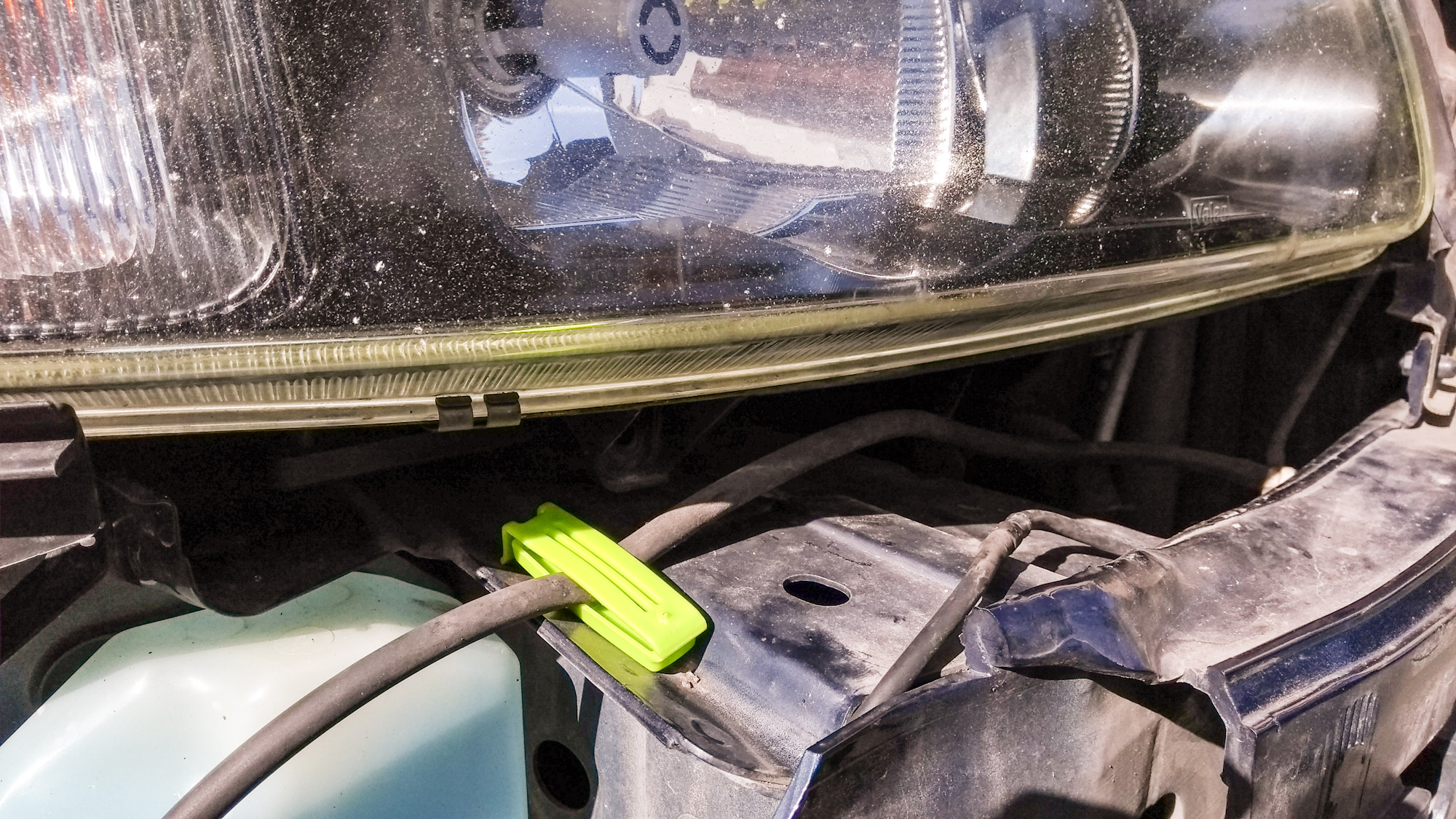

However something like this on the right hose should do the trick. This is for the regular wipers but the principle should be the same. As long as theres the one pump for the washers on the lights and the windscreen.
