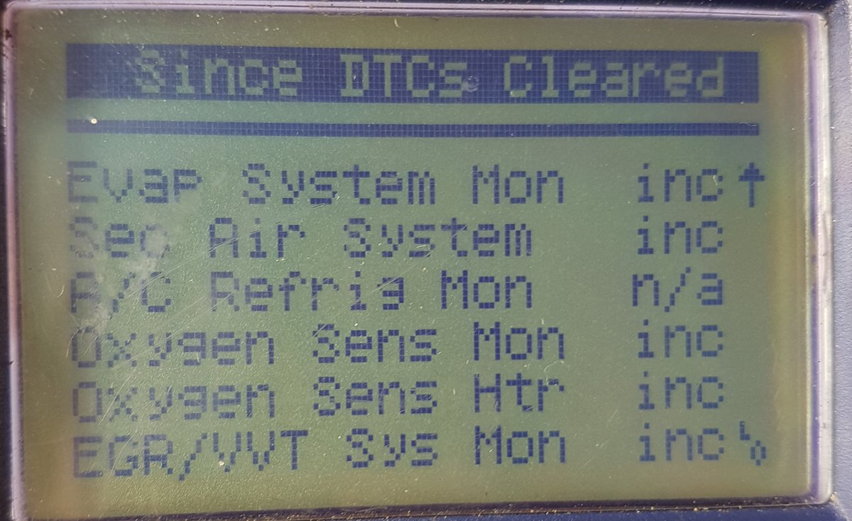

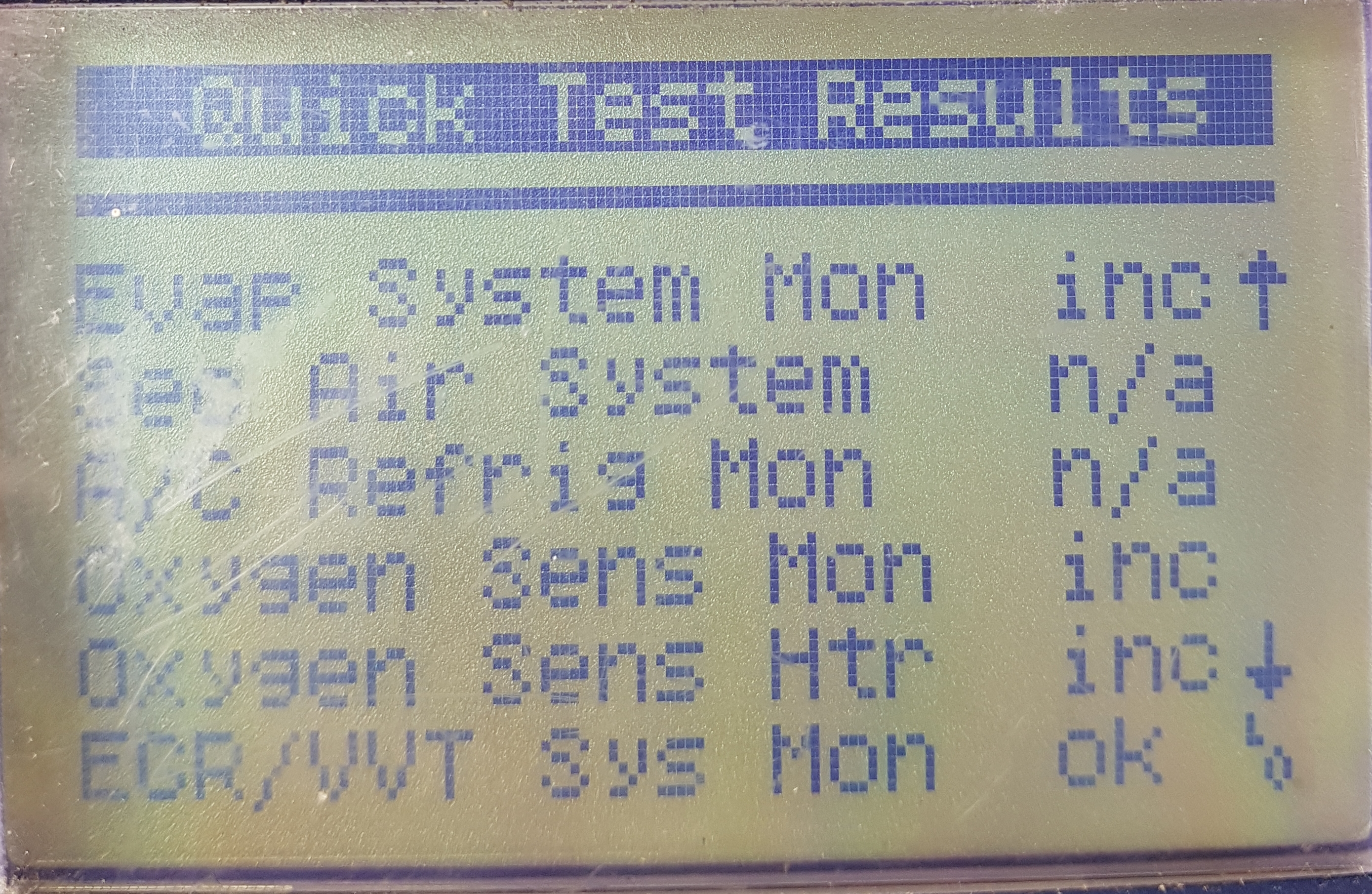

I always keep am eye put at the junk yard for things on my wish list. Yesterday I got lucky and landed a Motronic 4.4 ECU off a 97 N/A 2.4L auto sedan to replace my 4.3 ECU. I eventually want to tune the car.
While everything works flawlessly (even AC), I'm still annoyed by the codes thrown because my car lacks a couple emission related bells and whistles that the donor has.
My original ECU throws no codes, the new one throws the following:
P0410 - Secondary Air Injection System
P0450 - Evaporative Emissions System Pressure Sensor / Switch
P0446 - Evaporative Emission System Vent Contro Circuit
P0412 - Secondary Air Injection Switching Valve A Circuit
These are all electrical, they come on as soon as I turn the car on. I don't have any of these components in my car.
Does anyone here know how to disable the secondary air injection system via software??
How about disabling Evap or just the circuit check?
Original ECU Monitor Systems M4.3
Donor ECU Monitor Systems M4.4
