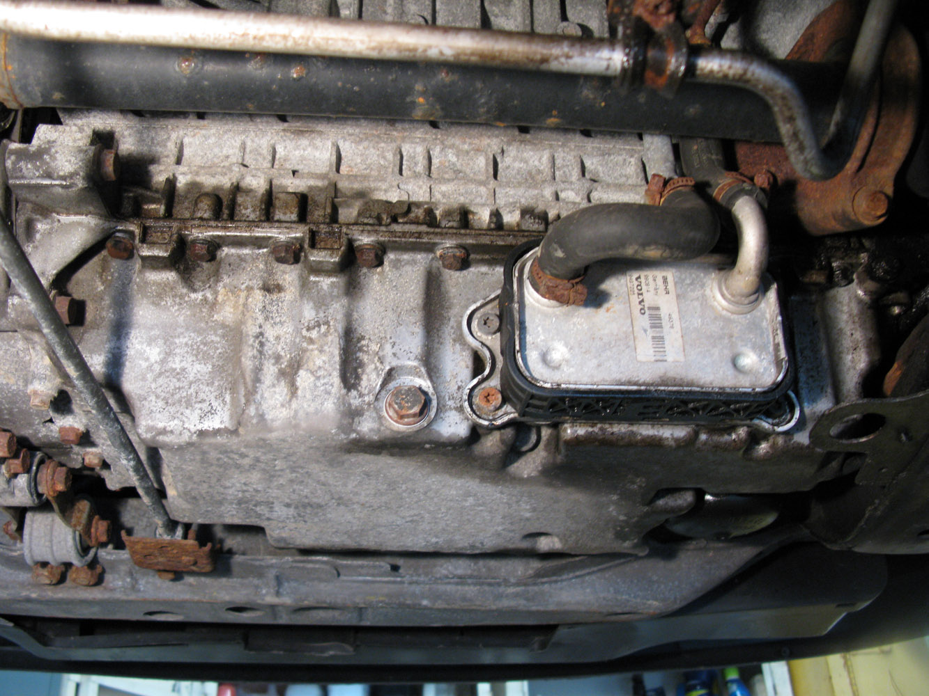

For years, my 2000 V70 manual has had an oil leak on the lower passenger's side of the engine. Now that I'm getting more confident with replacing engine gaskets, I'd like to finally repair this.
Please help me determine what's leaking. After 17 years and 200k miles, what is likely to leak in the areas shown below? I think the leaks are primarily around the crankshaft harmonic balancer (damper) pulley and the seal around the entire oil sump. Are these things which a novice could repair? Can you point me to any posts which detail these repair procedures?

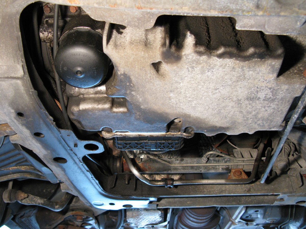

Seen from the front, the underside of the engine has lots of oil splatter on the passenger's side.

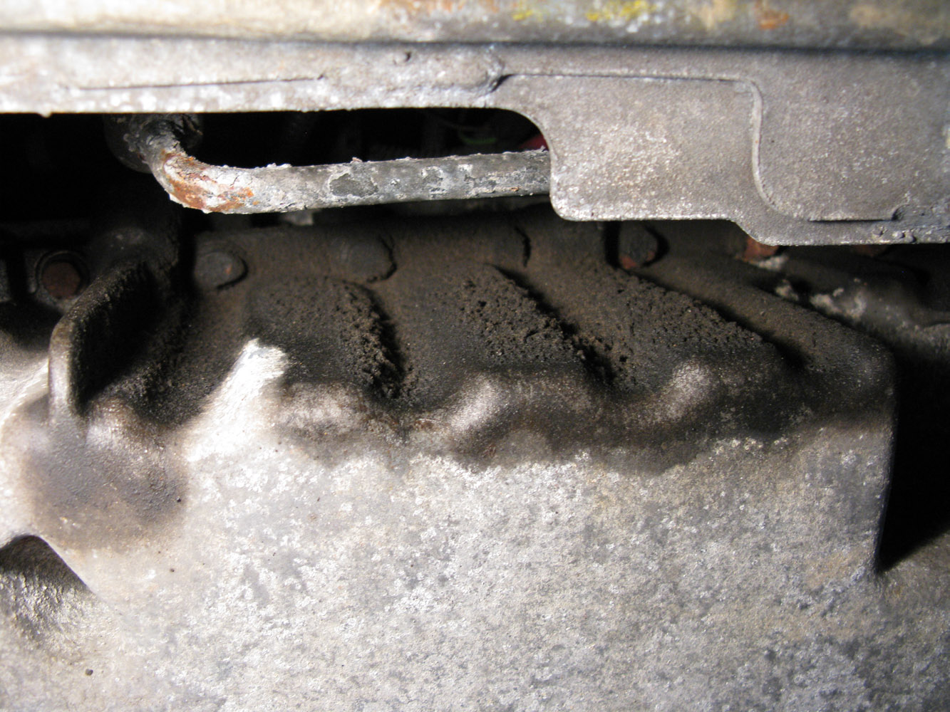

The front of the oil sump had a few millimeters of oil and debris caked on its entire width. I assume the horizontal seam above the oil sump is leaking down, causing debris to stick to it.
Seen from the rear, the horizontal seam above the oil sump has light oil seepage; nothing like the front. The oil cooler looks like it's leaking. Really, I think the leak is higher up.

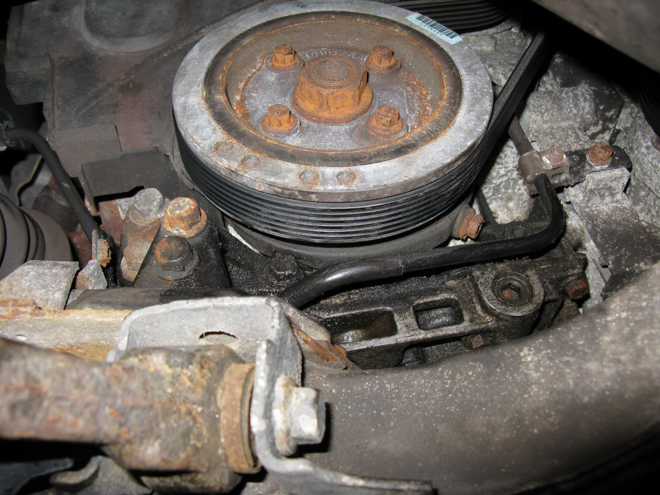

Here's the crankshaft harmonic balancer (damper) pulley shown from the front passenger's wheel well. I had already cleaned the oil from its lowest sections for this picture. No oil is spilled above the pulley, telling me the crankshaft is the leak source.
What could be leaking around the harmonic balancer? Could the repair job be completed by a novice like me?
Is it common for the seal above the entire oil sump to leak? How can that seal be removed and checked?

First thing to check is for oil under the plastic cover on top of the engine plugs/coils. Basically all of the oil leaks shown could be from leaking around the oil cap seal, making its way down the timing belt side of the engine. Or even a front cam seal (less likely).
Except for the passenger side the oil leaks on your car's engine seem verrrry slow, which is typical. The only way to understand the source(s) is to clean it well, with degreaser and some kind of rinse, and see if/how fast the leak evidence comes back. The other spots could trace back to the passenger side leak(s), as well.

Thanks for the tip. A few months ago, I found the oil cap seal was cracked so I replaced it with an IPD robust one. There was some oil around the plugs/coils which I cleaned. I will look to see if there's a path the oil could have taken from the top to the bottom passenger's side. The belt area of the engine looks clean above the balancer, as shown in the last picture I posted.
I just read the Haynes section about removing and resealing the sump. Requires the engine to be out. Clearly not something I'm going to do. But darn, there was so much crud built up on the front of the sump!

What is your oil consumption like? Are there any wet spots or is it all just oil crust?

The sump pan you can remove out the bottom and reseal without pulling the engine, but it is a hassle and a very rare job to do just because of oil leaks. However dropping the pan is a common job to do when it is because of the oil tube pickup seals inside the sump need replacing. At 200k yours are likely on their way out, but until the ticking up top gets bad and/or the oil light stays on for a few seconds at startup, you probably don't want to be drop the oil pan.

The front of the oil sump was covered in thick, dry crust. The oil below the balancer was all wet and mixed with debris. Oddly, I haven't noticed any puddles of oil on the ground below the car. I frequently drive for 350+ miles non-stop, so perhaps it only sprays off when the car is running. That would explain the expansive oil spray on the subframe.
It seems unlikely that my oil cap leak ran all the way down to my balancer. I replaced the cap gasket in May and cleaned all the oil from around the plugs. I checked today and no new oil has spilled from around the cap. The oil below the balancer is freshly wet and the oil cap hasn't contributed in four months.
