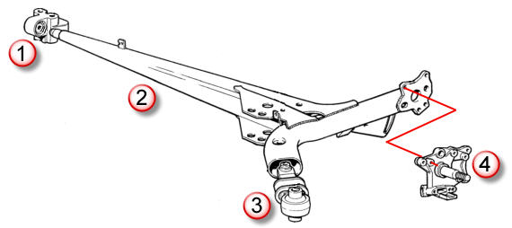

The bushings and delta links go bad after something like 150k miles.
It's a pretty big job but can be done at home on jackstands. The delta links, part 3 , can be very tough , so if they are loose that's great!

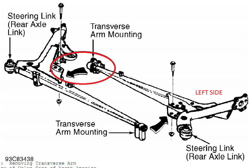

Here's a diagram that shows where the right side of the left arm goes, circled in red.kaneelschep wrote: 04 Oct 2017, 15:51 Its not the sway bar. And its not the rubbers. Those are clearly visible.
Its one of those two bars wich lead from the wheel hubs to the other side.
I think they are called the transverse arms?
The left one is loose on the right side. And i cant see how its supposed to be connected.
Gary

Its loose at 1. Not at 3
The whole bar flips upwards with the wheel.

The round end of the arm is completely loose from the bracket wich apparently holds it onto the side of the other arm.
But since this it is all inside the other arm, you cant really see anything.
Does anyone have a youtube film or picture of the actual parts? So I can get an idea of what to do?
It seems like the only way to fix this, is to take the whole arm of. Fix or replace the bracket back onto it and put it all back together.
Would it be safe to drive with this? I was driving it like this all week. Did almost 800kms..

what i circled at 1 seems to have broken of from the rest. the round part with rubber is still on the arm.
The rest is still bolted to the other arm.
- Posts: 36145
Kaneel, you have no torsion bar on your rear wheel if that part is broken.
Maybe there is a way to attach the. Bar to the car with thick zip ties or hose clamps to at least secure the position? I would use at least 4-5 ties/clamps
I'm not sure what is holding your wheel on the car in this case,
You are going to wear out your tire very quickly if you have that much slop in the wheel, perhaps it is already worn badly.
If you must drive it, keep your speeds down. I would not drive it.
