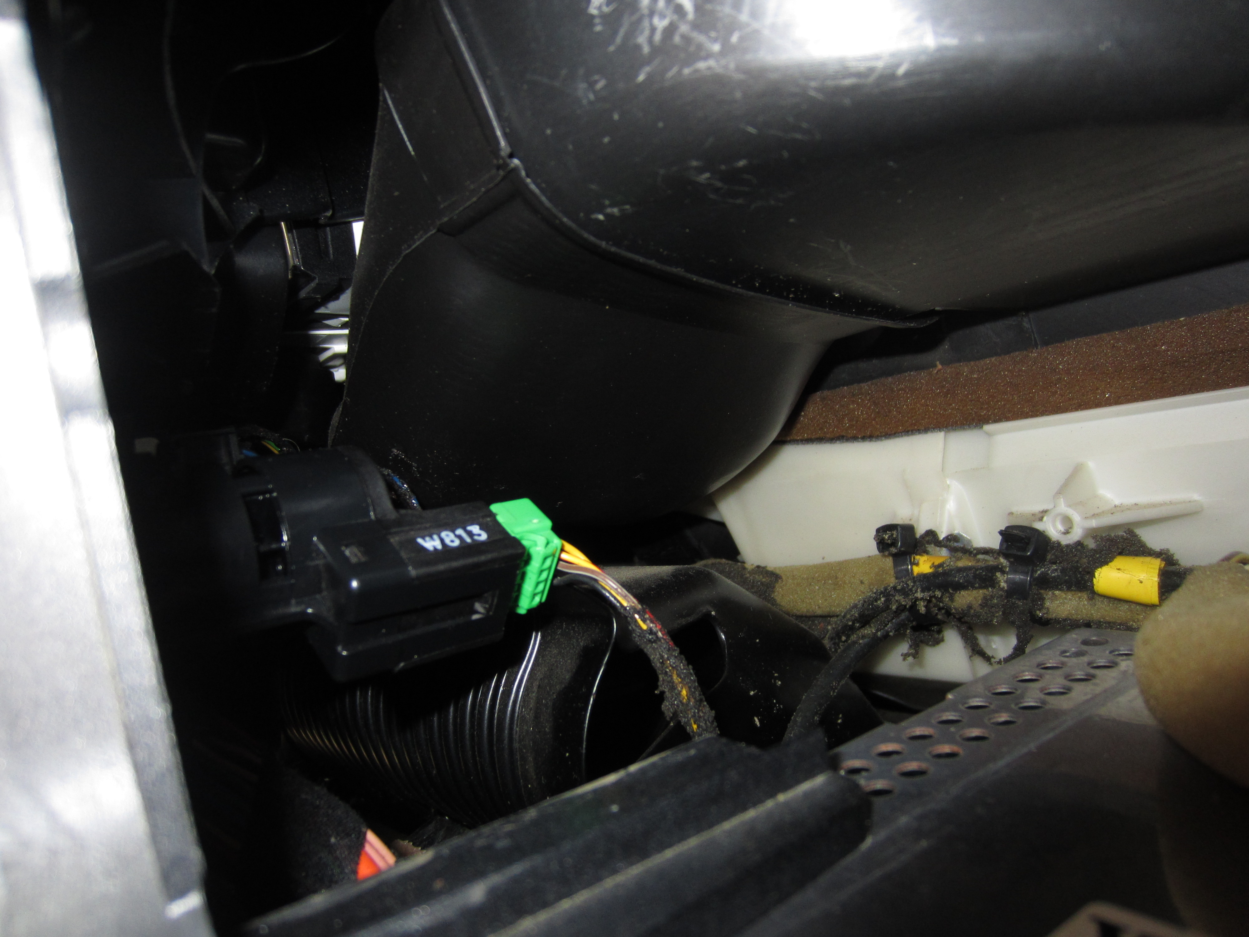

The temperature sensor is located behind the small vent next to the switch panel with the sunroof and rear defrost switches. You may be able to clean off the dust through the vent with either a can of compressed air or an air compressor blow gun, but I decided to remove it to make cleaning it a little easier.
First thing you need to do is remove the radio, using the two tabs on the sides. Just push them in, with your finger nail or a coin and pull it right out. No need to disconnect the wires, just rest the head unit on the console. Put a towel or something over your shift knob if you’re worried about scratching it.
Reach behind the ECC unit and pull it forward to remove.Take note of the position of the connector prior to removal to make it easier to replace. The temp sensor is held in by four clips, two on top and two on bottom. If it’s a little stubborn, pivot it up and down a little bit. Disconnect the two green connectors and slide the radio back in place.
Now you should be able to see the temperature sensor to the left. Reach around and depress the two tabs and pull it back gently. It’s a little tricky to find the tabs at first, but once you pull it out, it’s much easier to see.
Then pull the connector and remove it from the car.
