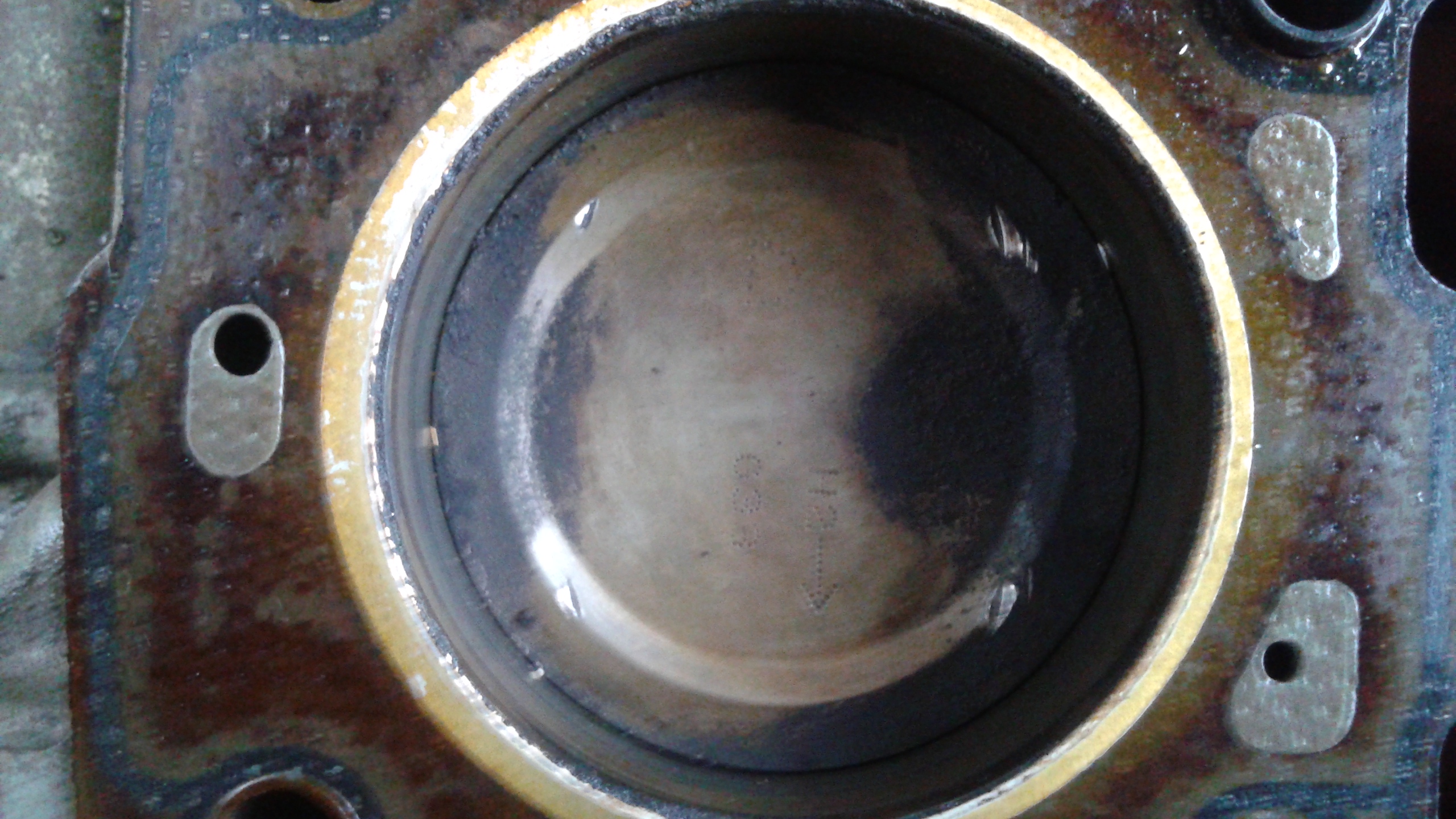

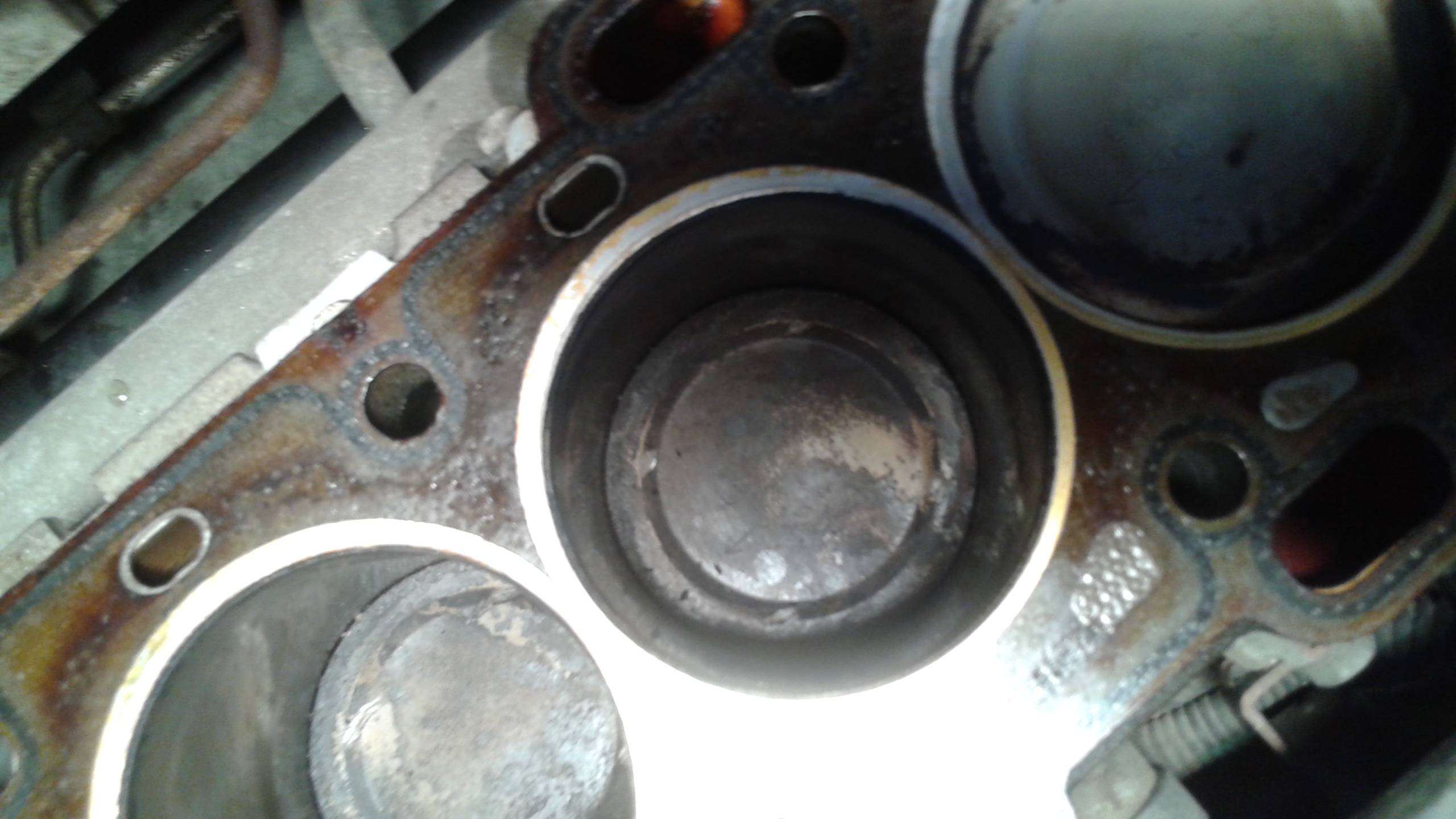

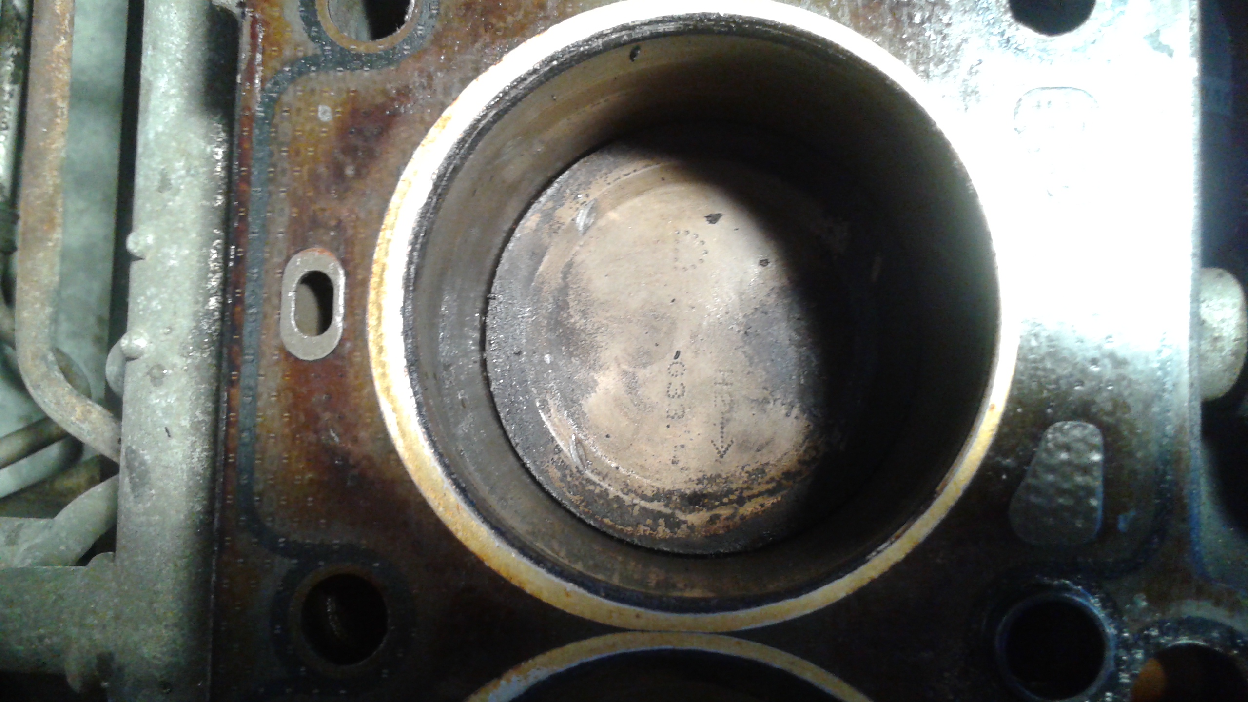

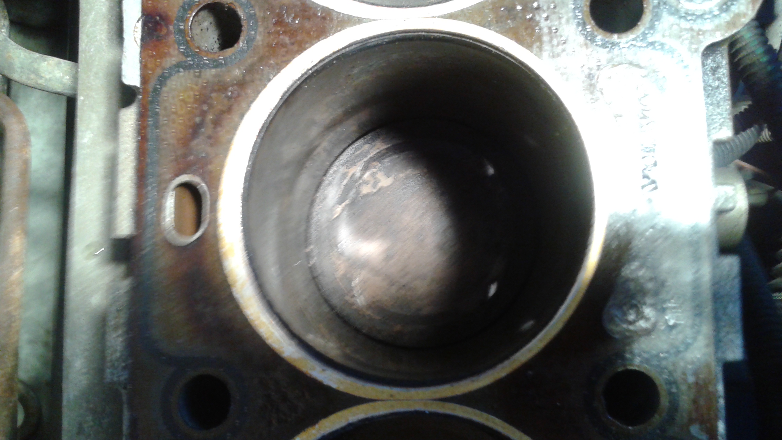

I think this is my first post here. Timing belt jumped on my son's 03 C70 due to a seized water pump and I have pulled the cylinder head. A number of the valves have hit the pistons (in 4 of the 5 pistons) and I am considering whether I can still have the head rebuilt. I am attaching pictures of the cylinders. I have a shop lined up to do the job and will ask them but I wanted another opinion.

Sad but not uncommon aftermarket water pump failure, I'd only put Aisin or Volvo in place. As for the valves, they hit the piston quite hard, not sure if replacing only the valves will do?

Just rebuild the head or put in a used one and new head gasket.Victor Reinz or oem Volvo are the ones you need.

From what I have read, and following on from what misha says too, mostly the damage is to the valves/head (and usually just the valves). The pistons may not look pretty, but they are fairly robust.
Other option is to buy a used motor and just swap it all out if you are worried about damage.

Thanks all for the info. I am taking the head over to the shop today after recommendation from IPD and another Volvo specialist. I am a bit lucky as IPD is only 20 minutes from me. Spoke with the shop manager and he stated that they have rebuilt heads on Volvos when the belt went at highway speeds. My son was at a stop light went the belt slipped so just starting to accelerate slowly. The fellow at the shop mentioned the concern with the piston contact would be the effect on the rods and not so much the piston head surface and that the valves are softer. Valves made contact but none drastically bent. I will be having all the valves that made contact (even the slightest bit) replaced. They will look at everything.

The damage to the piston tops should just be blended out. File of the edges of the depressions with a file or die grinder. once that's done try to smooth the edges. Just like bondo, only different!

I have done quite a few jobs where the pistons have come in contact with the valves. It has always been because the water pump seized up. Never had any problem after the machine shop looked over the head and replaced the bent valves.
