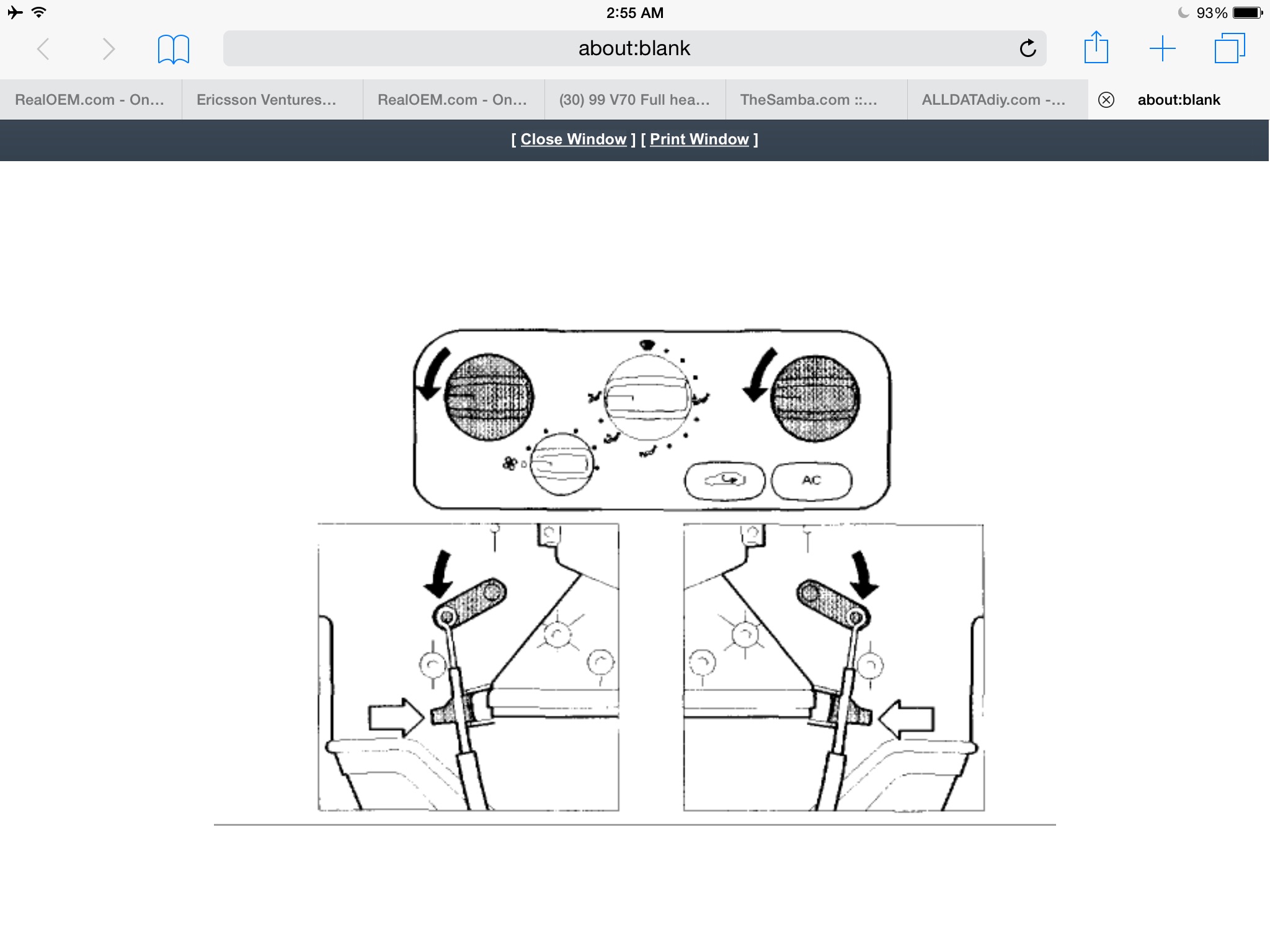

All our cars use full flow heater cores and AC evaporators so the temperature is adjusted by blending the hot and cold air. I'm sure you just have a simple mechanical failure of the blend door which is just admitting hot air to the driver side. Slide under dash and follow the cables to the system and look for things fallen off.
If it disappears into the jungle , you might have to take the dash off yo deal with it. Ugh, 10 hours of work.
I'll look and see if I can find MCC info in Alldata for the superior 1999 model, practically perfect in every way...
It looks doable from inside car...

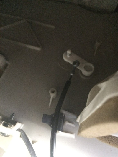

started to dig into this. pulled the kick panel and carpet and found the cable had come disconnected from this lever here. i put it back on but there's something further up the line causing it to bind, so i took it back off and just wedged the blender to be fully closed to hot air. i pulled the radio because it takes like ten seconds, but the cable mysteriously disappears somewhere and doesnt go directly behind the radio. gonna leave it like this for a minute until i have the time to pull out the climate control head unit
