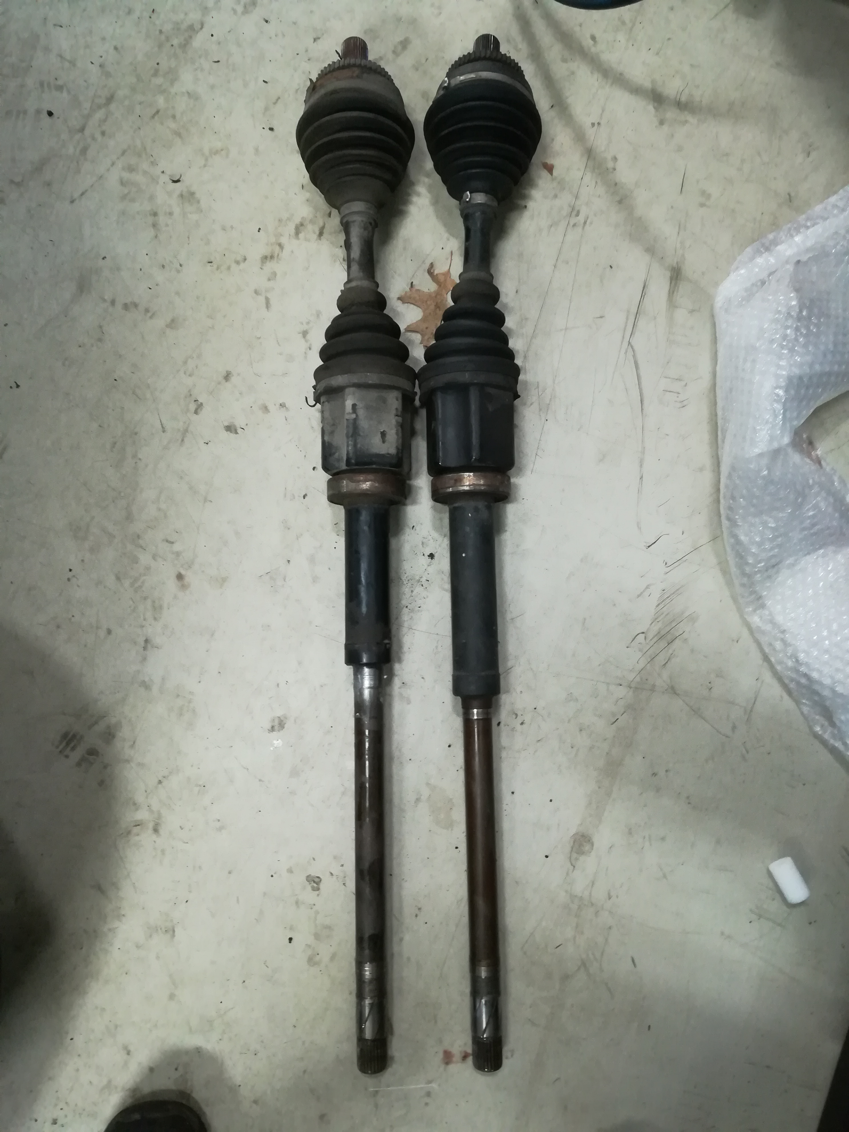

BAD: the right hand side axle did not fit. See the picture attached.
Good:
- left axle fits
- with a workaround, my Indy used the 'new' bearings and used them in the axle that was fitted on my car. So, he basically created one new driveshaft from two 'donors'. This works!
I attached two pictures. One shows the differences between the two axles. The one on the left is the axle I received from the reseller, the one on the right is what was fitted on my car.

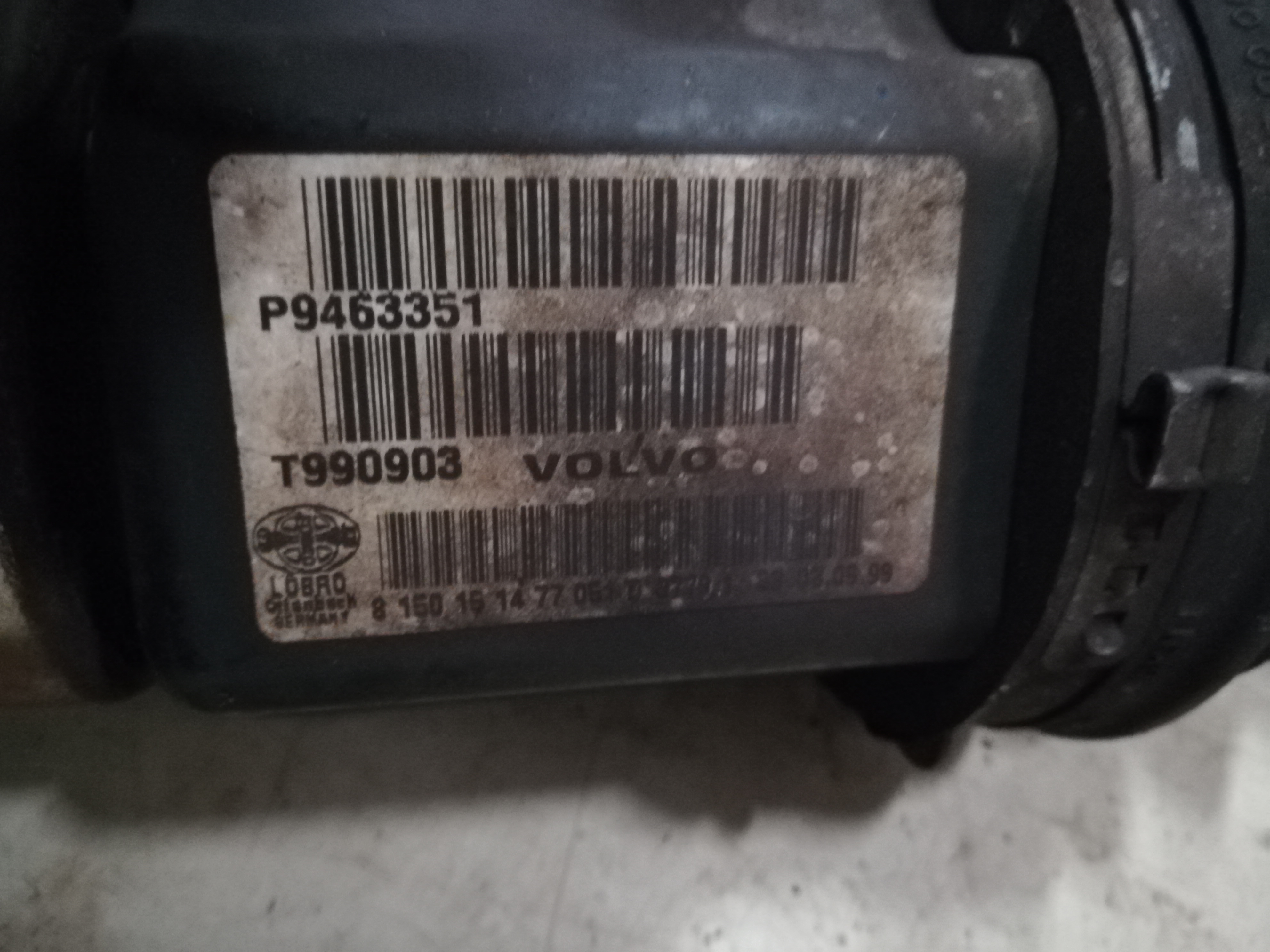

The other picture shows the numbers that are on the axle that was already fitted to my car. Those are the numbers you need when looking for a new one!
