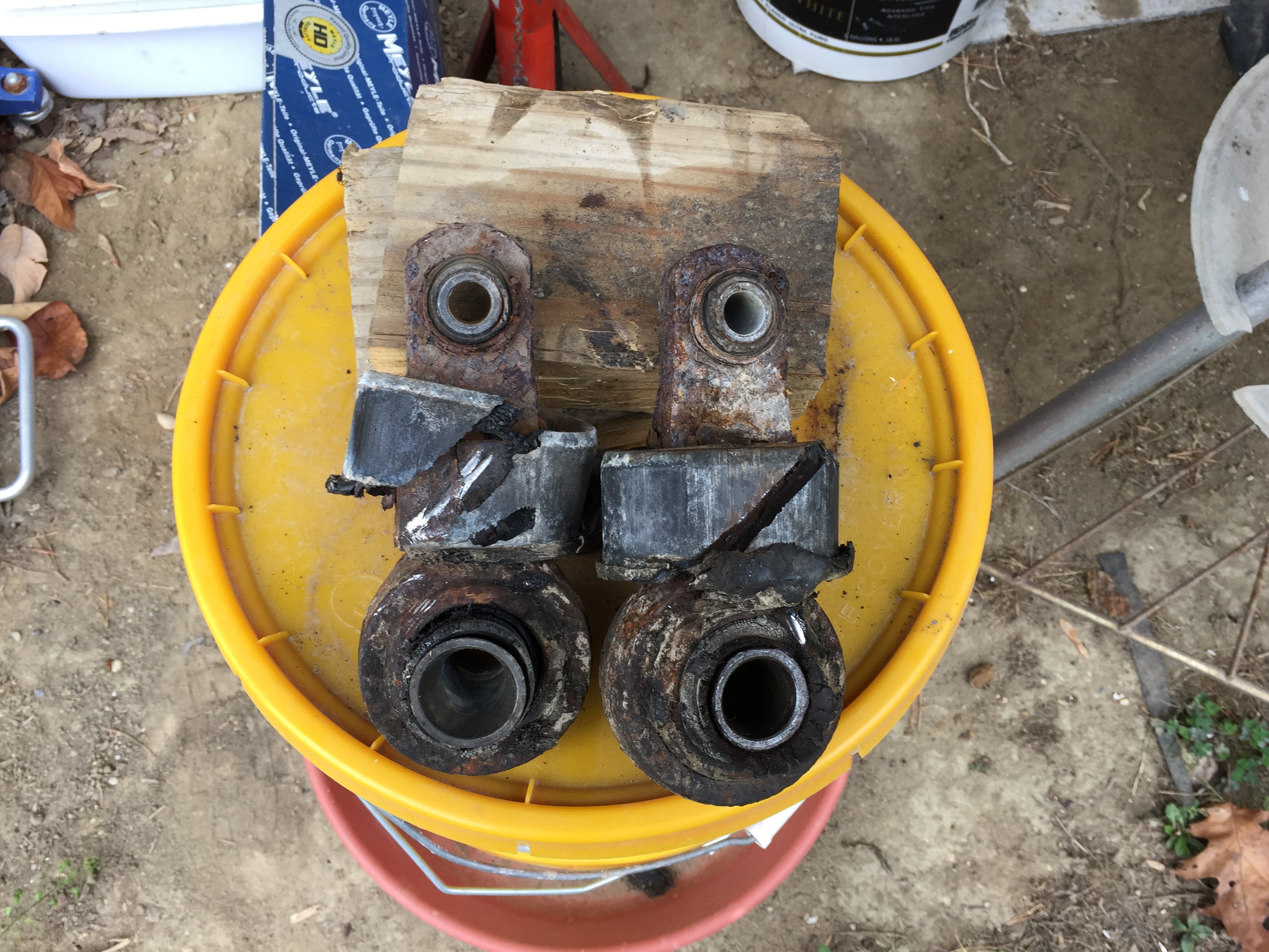

Post by grntrdbx »
[attachment=0]IMG_3655.JPG[/attachment
Old rear link
Old rear link

Nasty nasty job. I got lucky with mine and they crumbled and fell out.
