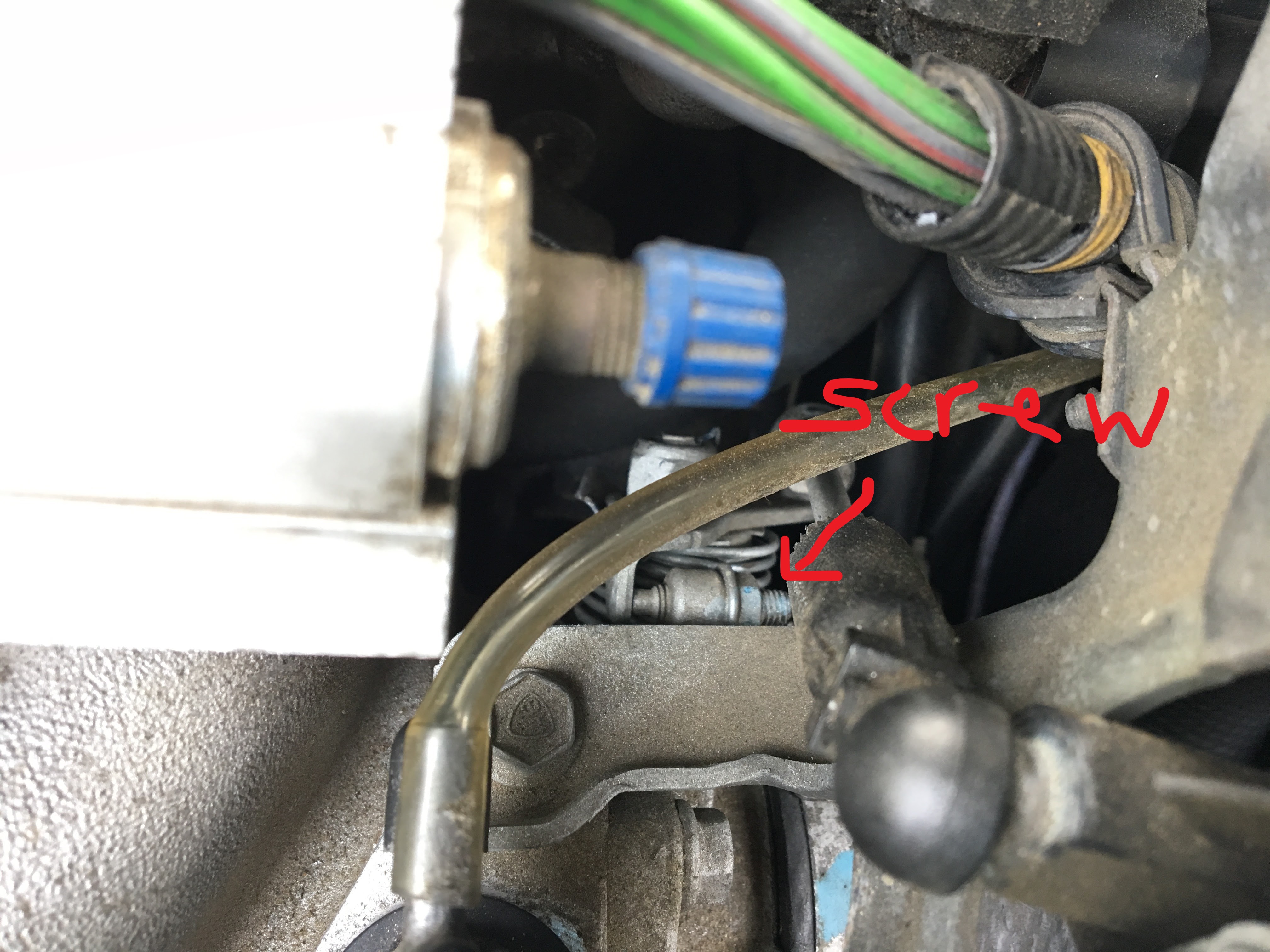

I was messing around with my throttle body today, trying to diagnose an increasingly frequent pulsing idle, and I noticed that it takes a little bit of movement of the throttle pulley to move the butterfly off of the set screw on the back (or side).
When I turn the pulley by hand, the rod that connects to the arm from the pulley has a little play and the butterfly does not move off the set screw until I move it a little further. I apologize, because I know I'm probably not explaining this great.
Anyway, should the butterfly open instantly when I turn the throttle pulley? Should I tighten up the screw a little bit to get rid of the play, or is it supposed to be like that?
I also tightened up my throttle cable a little bit after watching Robert's video showing the slack in the cable (while searching for information on this screw!). I always figured if when I pulled the cable and it turned the pulley, that was good enough. A couple turns tightened up the slack and definitely improved throttle response!
Throttle Body Set Screw- '98 V70

So... adjusting that screw didn't decrease play in the pulley, just increased idle speed... which I kind of expected.
