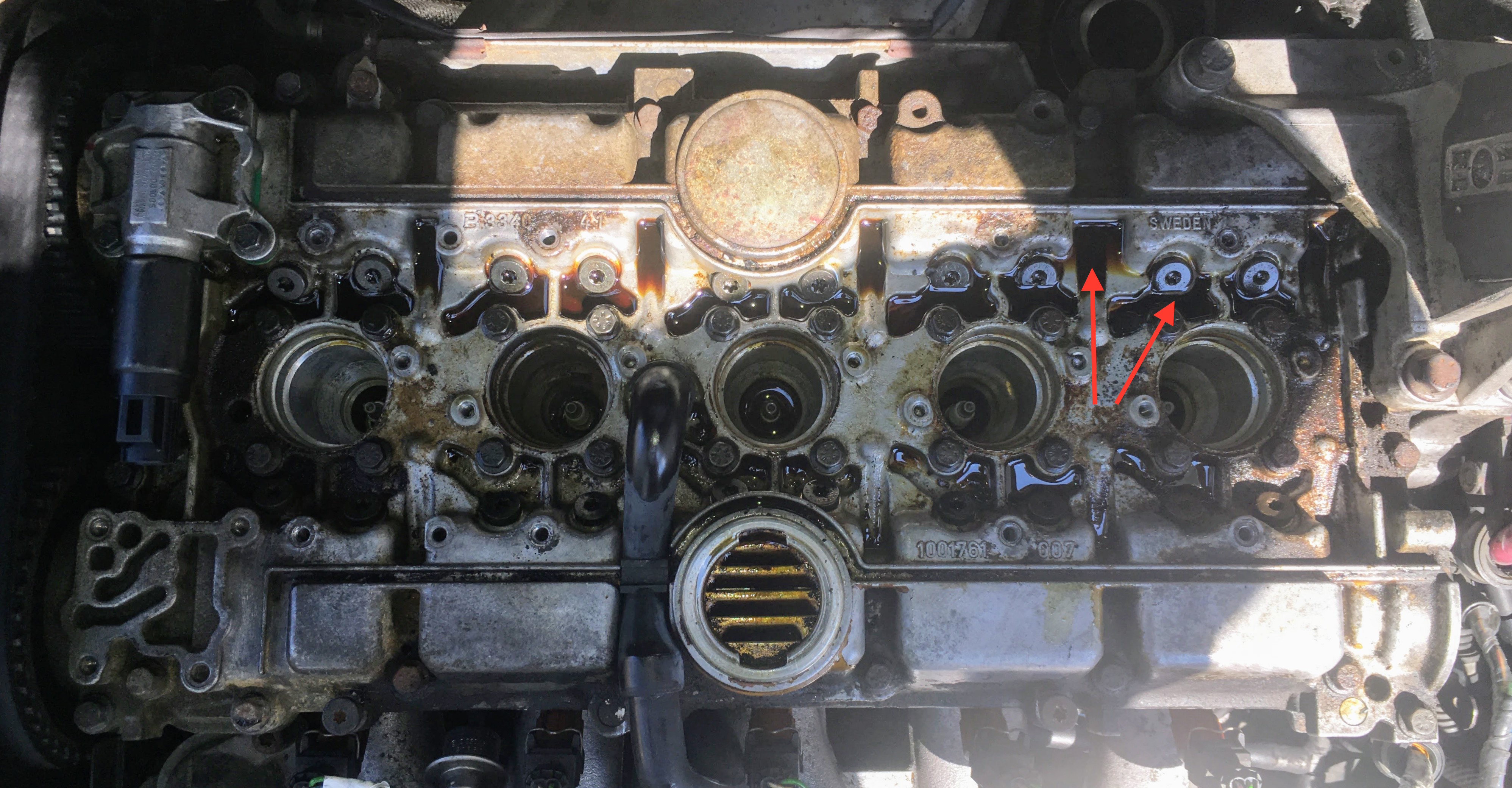

I can give it another try tonight and just drive around the neighborhood until the engine comes up to operating temp, then idle for a while and examine the engine.
Just for reference, here is a photo of the cylinder head taken a while back before I had cleaned up the oil. Since then I cleaned up the oil, and after my long drive there is now oil back in most of the same spots, although not as much. Most of the oil currently is concentrated in the wells indicated by arrows.
