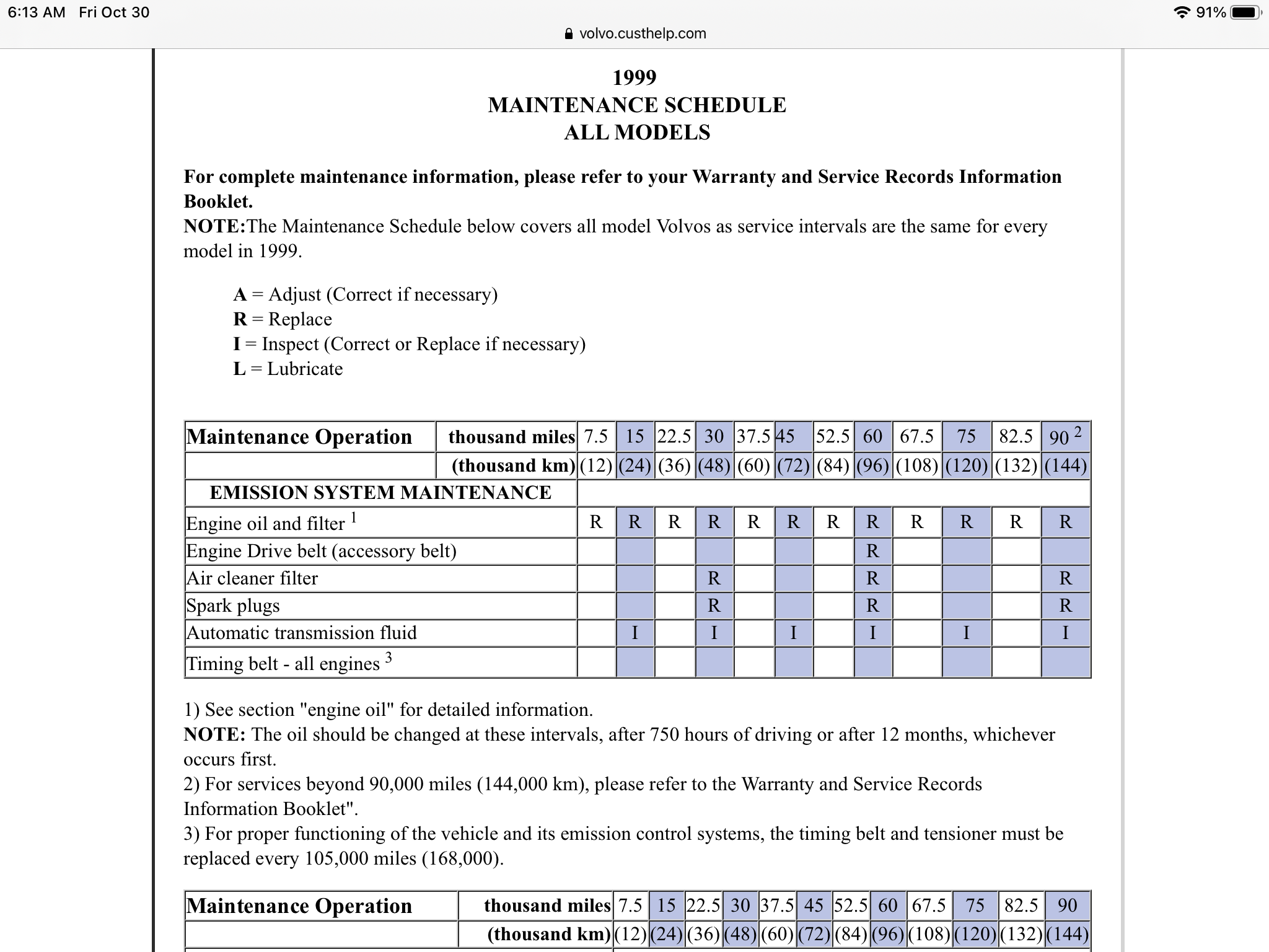

Ok, I just noticed the replacement interval on the serpentine belt on my 1999 is 60k
I put my first replacement on at 137k, now I'm at 200k
How often are people replacing serp belts in practice!
1999 v70T5M P80 serpentine belt life, interval, actual practice

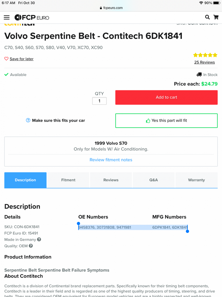

Primary reference for SERP belt for 1999- and P2 models
Part numbers. 9458376, 30731808, 9471981
MFG Numbers
6DPK1841, 6DK1841
