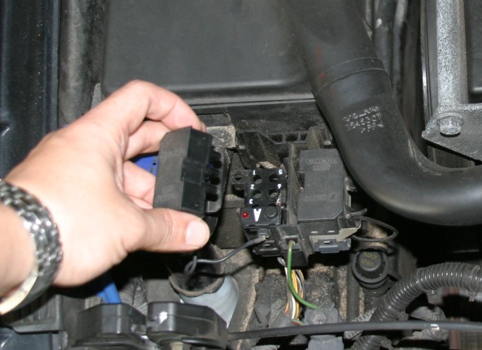

You have a dtc box under the hood that will tell you what's wrong. Pull the codes and see what they say.

Matty Moo wrote: 24 Nov 2017, 06:44 You have a dtc box under the hood that will tell you what's wrong. Pull the codes and see what they say.

No.
You actually have a box under the hood that will tell you the codes. It is your dtc box.
Diagnostic panel under hood.jpg (71.52 KiB) Viewed 3441 times

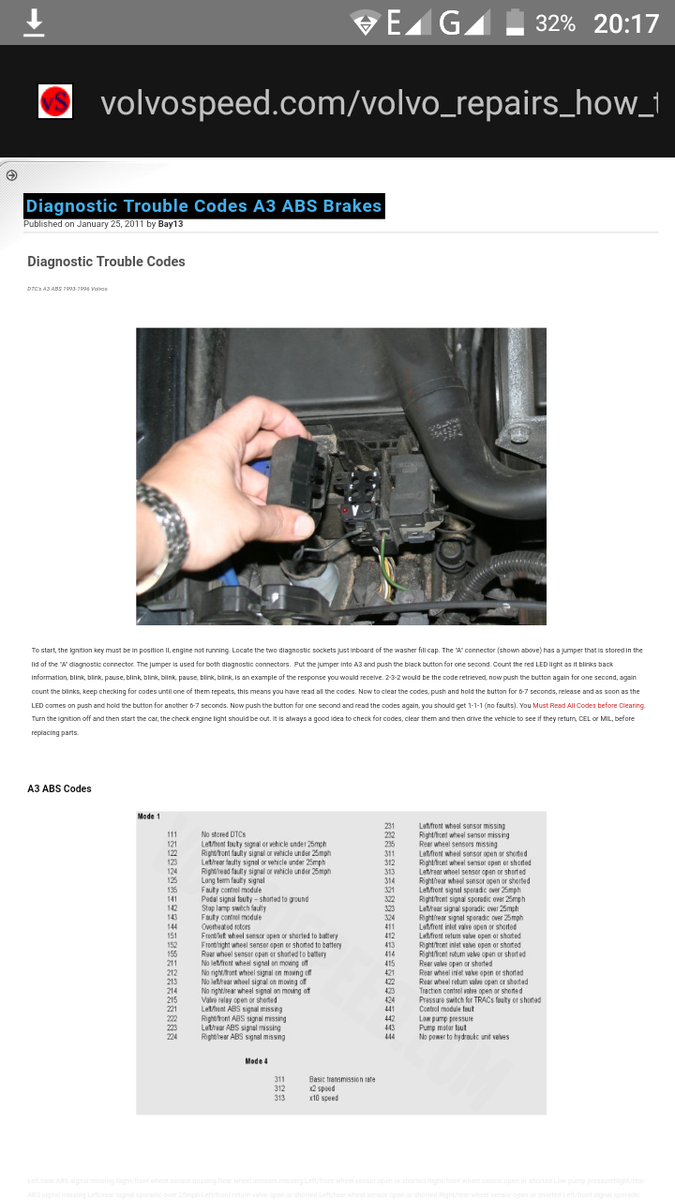

Ok here are the codes I got ...
213
214
141
142
Any ideas?

Which port....A3?

misha wrote: 30 Nov 2017, 01:38 Which port....A3?
Yes the A3 port
