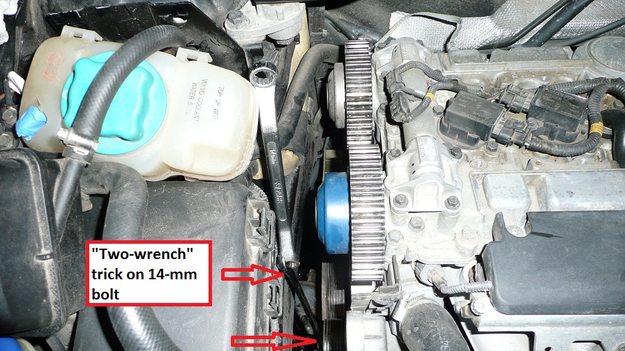

- Serpentine Belt Idler Pulley: 14-mm bolt. I don’t know the torque but hand-tight, then give it a twist.
I used Harbor Freight serp belt tool + Torx 60 socket, but you don’t have to. Just pry the plastic cap and use 14-mm wrench to undo the belt. Re Torx size, the correct size is T60 but T55 would work to.

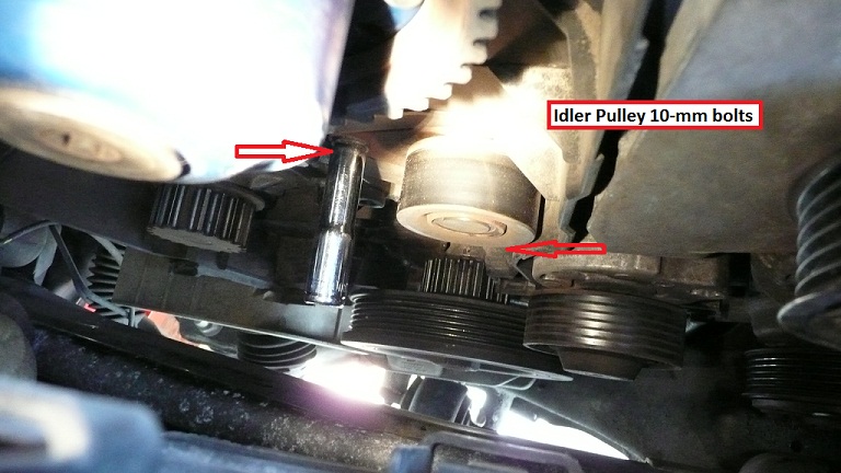

- TB Idler Pulley: 10-mm bolts; 25 Nm.

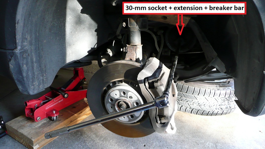

- Crank Pulley: 30-mm nut.

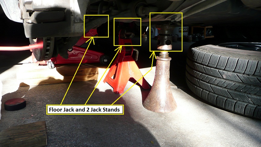

3. RF Wheel removed, I used 2 Jack Stands: the standard 4-leg Jack Stand and a Screw-Type Jack Stand, this allows me to have 2 Jack Stands for maximum safety and the Screw-Type Jack Stand allows the load to be evenly distributed between 2 Jack Stands.
4. Serpentine Belt. The correct socket is Torx 60, but Torx 55 will be fine (I tried T55 and it is OK too). I also have the Harbor Freight Serpentine Tool ($16 or so), this tool is very handy for tight space. If you don’t have any of these tools, no sweat…pry the plastic cap and use a 14-mm wrench, using “2-wrench trick”.

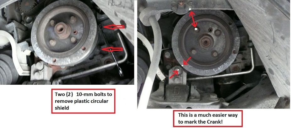

5. In the wheel well, remove the 2 plastic 10-mm nuts, peel the plastic back. I used a piece of wood to prop it open. Using a 30-mm socket + extension + breaker bar, turn the Crank CLOCKWISE until you see the Cam mark (very tiny marks) lining up with the UPPER TB Cover.

---> Note that the FCP-Euro youtube video shows you the tiny marks in the Crank, and put the TB Cover back to check timing? Well, no need for any of those.
---> Assuming the car is stock and the timing is correct, here are the EASY steps:

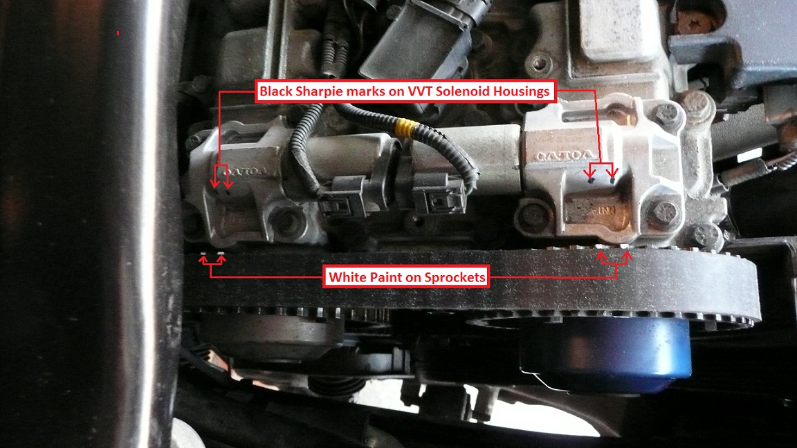

---> Once the Cams line up, do NOT remove the TB yet. For each Cam, place 2 white dots (Liquid Paper etc.), then 2 corresponding Sharpie marks as shown. This way, you don’t need to place the TB Cover back to check. One of the 2 white dots should be on the same tooth as the Front timing mark (you don't have to, but I did it this way to be kosher)...The idea is: the 2 white dots line up with the 2 black Sharpie marks.
---> Now, mark the Crank with white dots as shown. This is the bullet-proof way and very easy to tell if you line things up correctly. Remove the two (2) 10-mm bolts, then remove the small plastic cover.
---> If you want to double-check, then reach down with your LEFT Index finger and feel the ridge (RED Arrow) on the Crank Sprocket.
---> I marked the Crank with Sharpie just to be sure. For the tensioner pulley, watch the FCP-Euro youtube video and tighten the 12-mm bolt finger-tight to prevent the adjuster from moving freely. Now with the 6-mm Hex key, adjust the tensioner so the vertical arm moves to about 2 o’clock position (to tighten the TB), then back to 12 o’clock position (if you are at 20 degrees C).
7. Idler Pulley 10-mm bolts:

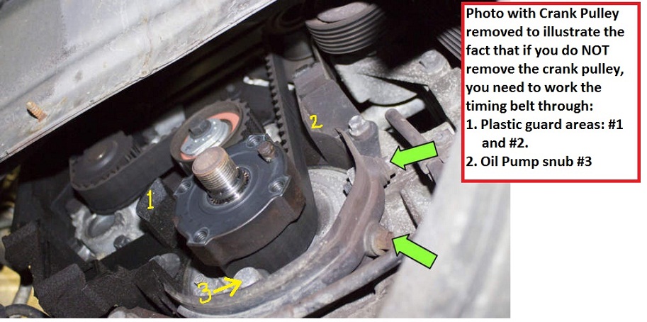

8. The debate whether to remove the Crank Pulley: I have done many Volvo TB jobs, there is no need to remove the Crank if you pay attention to the following photo. When the Crank Pulley is in place, whether you remove the TB or install the new TB, there are 3 places you have to work around:
- The 2 plastic edges #1 and #2.
- The Oil Pump Snub.
---> Just turn the TB 90 degrees sideway to slide it in. I wet my fingers with some water on the TB so it slides in nicely (just an option, you don’t have to do this step).

On the issue of Crank Marks, there are tons of youtube videos, DIYs showing the tiny tiny marks on the crank that are so hard to see unless you have good eyes or you remove the Crank Pulley.
As mentioned above, there is a MUCH MUCH EASIER way to line it up, even with the Crank Pulley in place.
1. Method #1: use the index finger and feel both ridges (RED arrows).
2. Method #2: This method is much easier!
- Note the Locating Pin is at approx 1 o'clock position.
- Incidentally, one of the Crank Pulley bolts lines up with the bolt on the Engine Mount (assuming your Engine Mount is still good and not collapsed), as shown in the red rectangle at roughly 8 o'clock position.
Start method #2 because it is very easy to do, then verify with #1. This is basically a bullet-proof approach!

It is possible to pass the belt without removing the crank pulley, after removing the small plastic cover with two bolts. However the space is really tight in several points near the crank pulley (there are 4 or 5 such points): at these points the belt has to be slid vertically which is not only tricky but also can force the belt to get twisted which can damage the material inside the belt (there is even a warning on timing belt kits not to crimp the belt).
