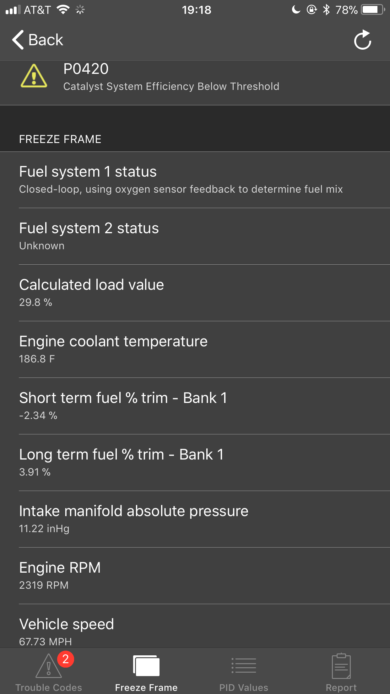

I attached a screenshot from the OBD2 reader I have. Shows the freeze frame for my code the car is showing. I do not recall anything out of the ordinary happening as it was highway speed. The idle boost pressure is -10.9 PSI, drops to 9ish when I push the throttle, then jumps up to about -11.7 PSI. I'm suspecting a vacuum leak as it seems there may not be enough of a vacuum. I cannot find one if there is. Any help in interpreting what the issue may be is helpful, thank you!

When you clear it, how long does it take to come back? That's often a spurious code from a small vacuum leak or manifold crack, or an exhaust leak.

The cat efficiency code is triggered by a deviation in the ratio of the two OXS - so if one of them goes bad, you can get that code.
Do you have a code reader which can report OXS voltage?

The front voltage seems to stay from 0.4-0.6 with an occasional dip or spike to lean or rich. The rear sensor stays steady most of the time but does jump from lean to rich more often than the front. I am going to go on a drive once I get home and will try to get a graph of the sensors' voltages. I will provide an update, thank you!
Spikes indicate the O2 sensor is on its last leg. Yours is new it should not be spiking. I would be looking for something upstream of the O2 sensor ... vacuum leak, intake leak a dirty mass-air-flow, something tripping up the metered air measurement.
From your done list, it looks like intake leak is one you have not checked. Spray starting fluid around the intake, if there is a leak. The leak will suck in the starting fluid and your hear the engine surge.
Front going from rich to lean, rear steady indicates the cat is working.
