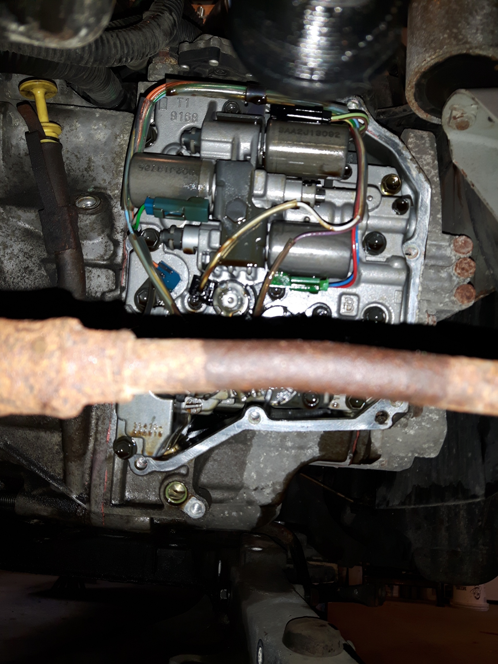

But recently when I stumbled across a 2004 c70 that was a smokin deal because the seller knew or thought the tranny was on it's way out. I decided to wade into the auto trans swamp and so i made the purchase.
So this car had all the symptoms, as it seemed to shift fine when cold but the shifts quickly became violent once everything warmed up. So violent in fact 3 of the 4 engine and tranny mounts were destroyed.
After reading many posts about how these poor transmissions get neglected because of confusion in the Volvo maintenance schedule I figured dirty fluid was the prime culprit.
Again after doing a lot of reading on this forum and a few other forums,, chance of reviving this tranny with a simple flush was clearly going to be a long shot and at best.
What I was thinking was if these shifts have become so violent what chance would the fluid have to clean out all the gunk from the sticking components and decided that I'd have to drop the sub frame to gain access to the tranny pan and valve body.
Once the pan was removed three culprits were now in plain site,,, the 3 linear solenoids, and once the electrical connection is removed surprisingly easy to remove these solenoids. 2 bolts and small brackets and they just slide out.
I had considered ordering the rebuild kits or buying the replacement solenoids you see on ebay but i had not felt confident to take these apart and reassemble.
I mean you only have one chance or else you have to drop the sub frame relive the whole ordeal again and again.
I had a ace up my sleeve http://transmissiontechnology.ca/
These guys were only minutes up the road from my house so i decided to pop in and chat them up.
I had dealt with this place before when my future wife's 2004 Nissan Maxima had transmission problems and they sorted it out quickly but that time we took her car into their shop and the replaced the entire valve body for $1000bux. we felt it was a good deal considering every other tranny shop was quoting more than double for their version of a fix.
Jay was the contact at transmission technology and after a brief discussion with him he assured me that Carlos would not only rebuild and set them up to factory specs he would also modify them so the solenoids were able to self clean,,,basically just drill holes in the back cover. All this for about the same cost of a rebuild kit from Ebay.
What really convinced me was the fact they have a dyno for calibrating them back to factory specs. I asked Jay about resetting the tranny computer but he said "No it wasn't necessary". He said it was possible for a couple hard shifts while the tranny relearns itself. More good news eh!
Once the solenoids were back in the car I did the flush with Castrol TransMax multi vehicle by putting a hose on the cooler return line and flushing 2 quarts in and 2 quarts out til the color came back to a clearish red color instead of the solid mud brown color that came out of the drain. I will mention this though upon initial start up the orange arrow on the dash wash flashing and engine light was glowing.. continued to flash until I erased code with my Autel.
I was finally ready for a test drive and I will say it was uneventful. Nothing out of the ordinary happened the tranny performed as it should with nothing weird to report after a couple hundred kms. It's been flawless.
So Thanks to all the guys on here that have went before and laid it out and made it easier for the rest of us.
