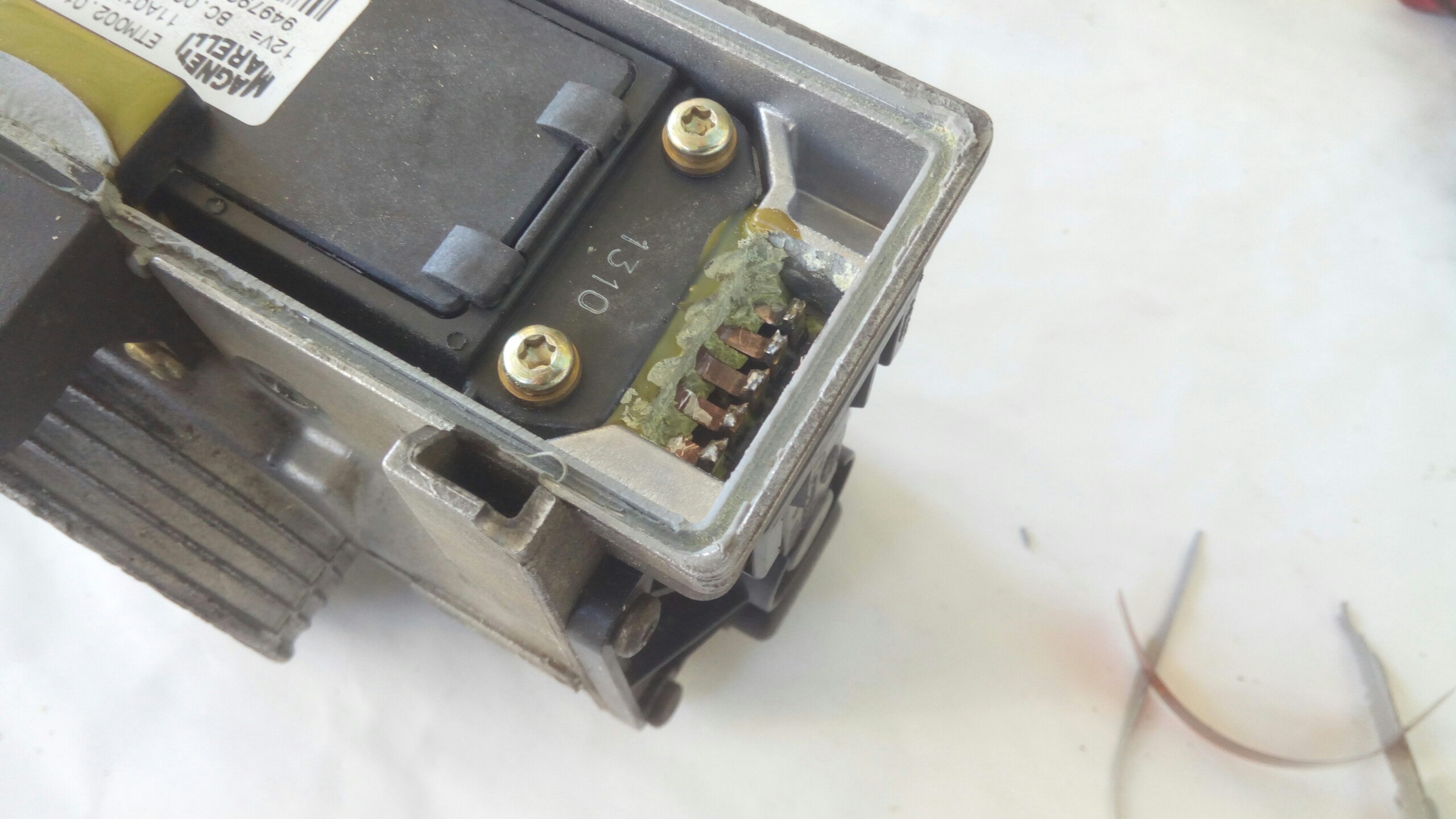

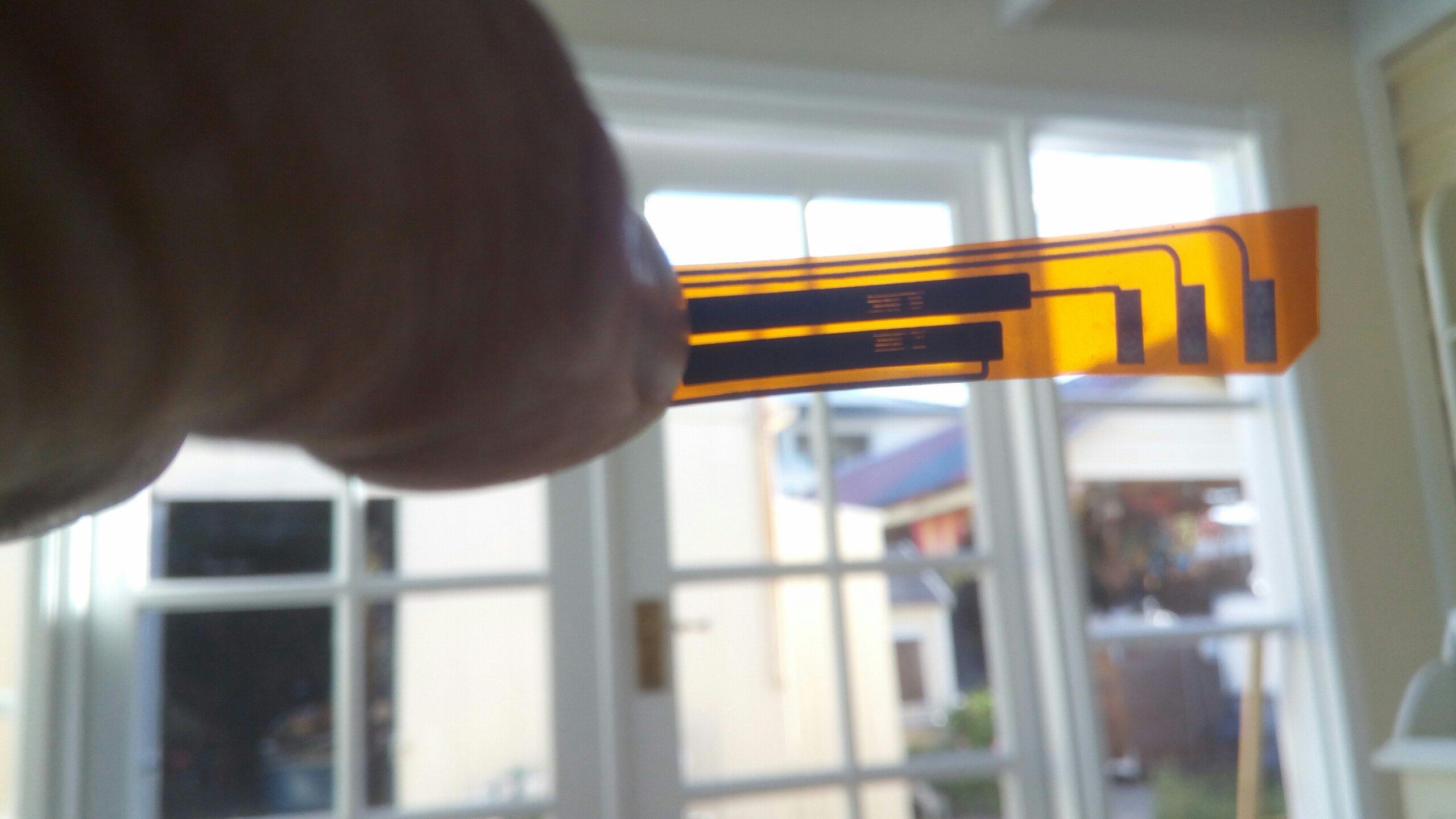

After about 1.5 hrs of work removed the sensor 1 contacting strip and replaced it with one I couldn't see through that I removed from a faulty ETM that had a board problem. No idea how long it will last but the sweep test shows under 2℅ variance between sensor 1 and sensor 2 so that's a definite improvement over the 75% figure achieved earlier and is about as good as a contacting strip can get.
Photo below shows the sensor 1 strip with wear marks in the early part of the film.
Also a video of sensor 1 removal until the video corrupted.
