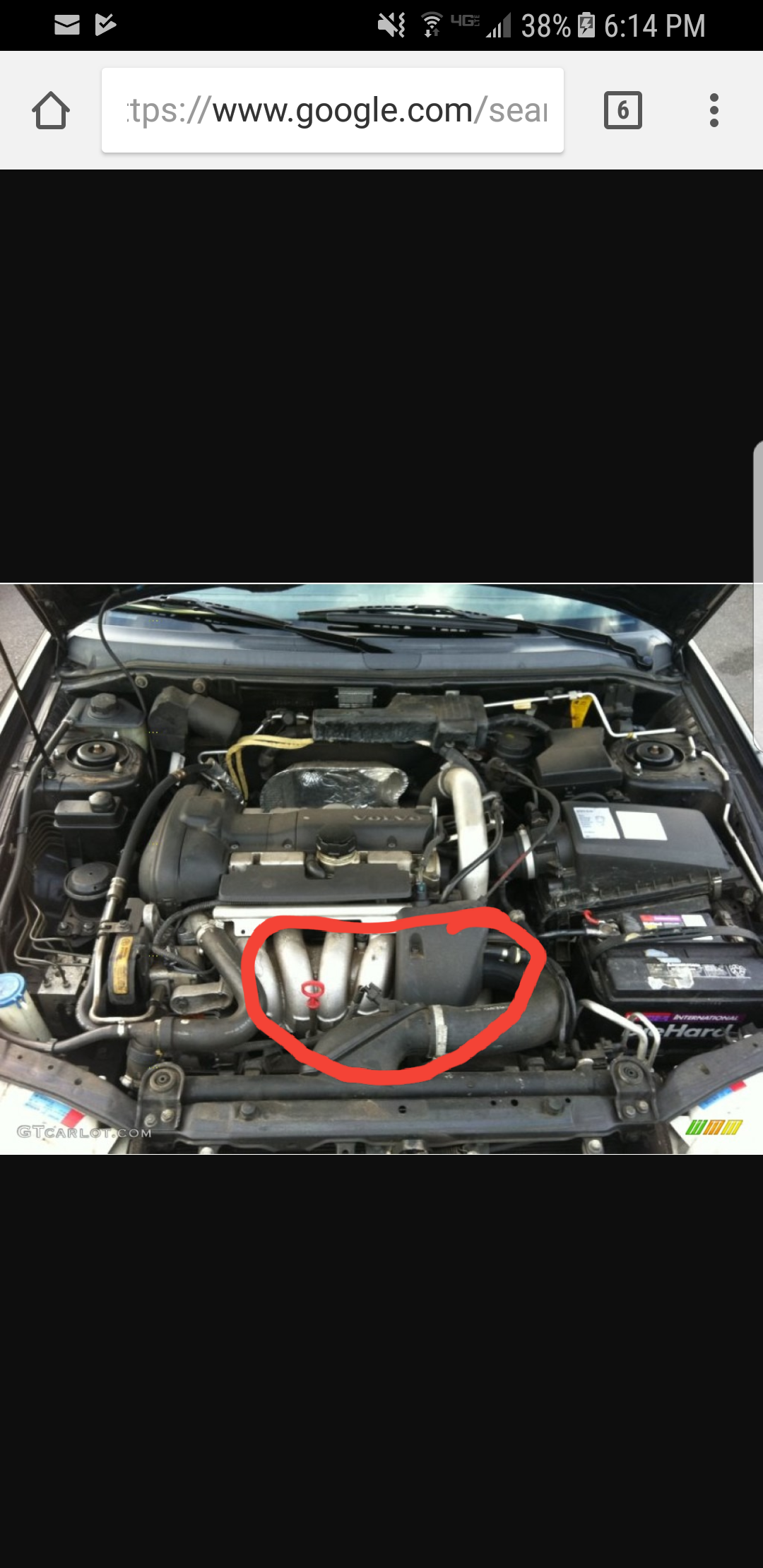

The MAP sensor I swapped was on the intake manifold, approx at cyl #3 position, tucked under a fuel rail. Is there another one somewhere? I had read some vehicle models had two and some had one. The sensor I replaced looked like this:

Here's a photo from another thread - not mine - but you can easily see the MAP sensor on top.
download/file.php?id=37357&mode=view
I may still have the extra MAF sensor if you're interested.

Thanks for the pic. I went and looked at mine, and it's different - I don't have a MAP on top of the intercooler hose connection. when I look under the intercooler hose, I found a sensor, but it does appear to be a temp sensor, not a second MAP. It's like the pics in this thread:
https://volvoforums.com/forum/volvo-s40 ... ted-52469/
At this point, I might just have to open the checkbook and take it to a specialist. Any other suggestions to try?
