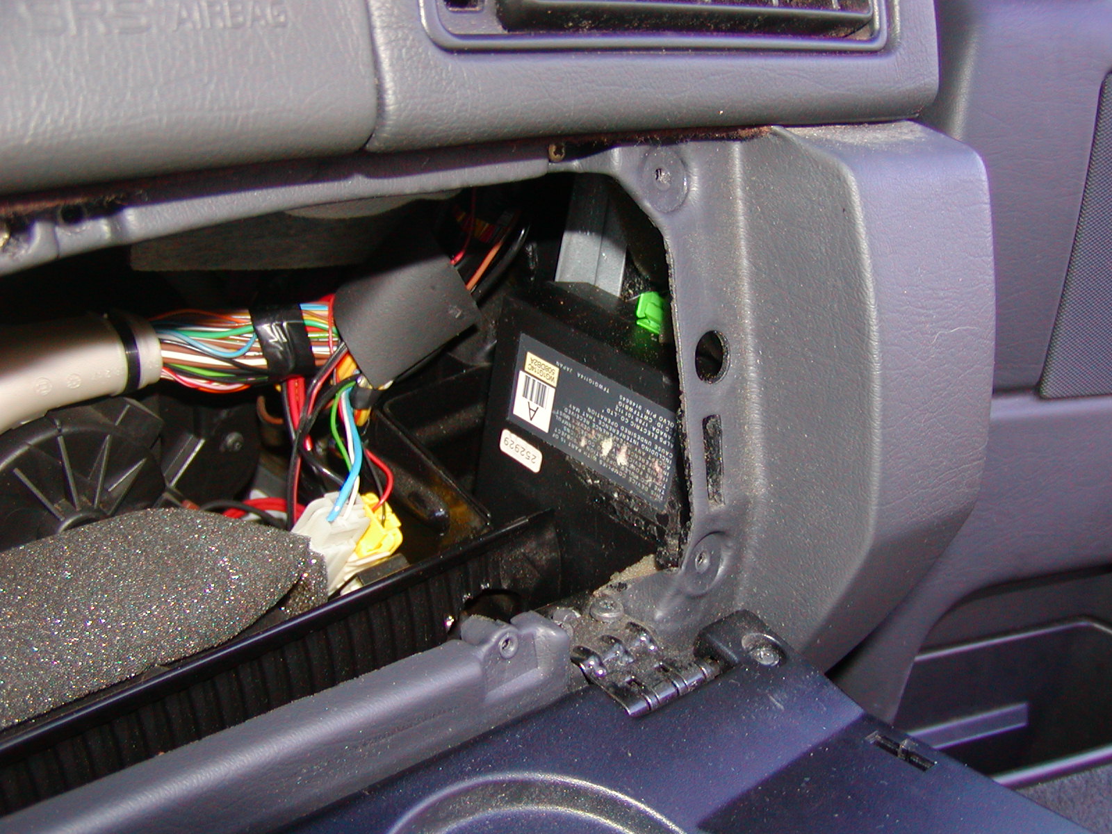

Hey there, i have a 850 -94 and my remote thing "what´s it now called" don´t work, i can hear a sound from it when i press it. But nothing happens with my car, i have to use my key each time to unlock/lock the car :/ I have also tried sit in the car and reprogram the key, but after turning the key 5 times nothing happens.
Also there is no light on the dash that blinks :/
I been using google and youtube to see if i can fix it, but nothing so far
Any ideas?

On the standard remote for the US spec 850s there is no audible nor visual confirmation that the doors have locked or unlocked. Some of the European cars have one of several "Guard" alarm systems but, since you don't have the LED on the dash, I don't think you have one of those. Some of those versions chirp the horn and or flash the parking lights.
The remote keyfob receiver is located next to the glove box, just below the A pillar. It sounds like this car is new to you so you might want to make sure it has a remote receiver and, if it does, that the numbers on the receiver match the numbers on the remote control. There are a couple of variations on the remote that look the same but they have different numbers. They are not mix and match interchangeable between the series.
Here is a picture of the receiver - it is the box with the big upside down letter A on it.
...Lee

I think i have the guard alarm, it´s a car imported from Sweden, but it look slike the previous owner has removed the relay. Gonna remove some thing later today and see if i can find it :)

I know the car has an alarm and i have the remote, but no light on dash from the alarm and nothing when i lock the key, also nothing happens when i try to reprogram the key
Here is a picture where i think the relay should be placed. Maybe i´m wrong?
It looks like there is an relay there with connections that someone has pulled out, if u look close at the image. Also why has the previous owner put a cables from one spot to another :/

Previous owner might have installed and then removed an after market system? The 850 T5 should have come with a factory alarm.

Klausc wrote: 20 Dec 2017, 14:20 Previous owner might have installed and then removed an after market system? The 850 T5 should have come with a factory alarm.
It´s a T5 i have,sorry forgot to mention that. Yeah it has a factory alarm but it looks like the relay is removed. I guess where the cables are there is supposed to be a relay there instead right? And the cables are there so the car is able to start?
