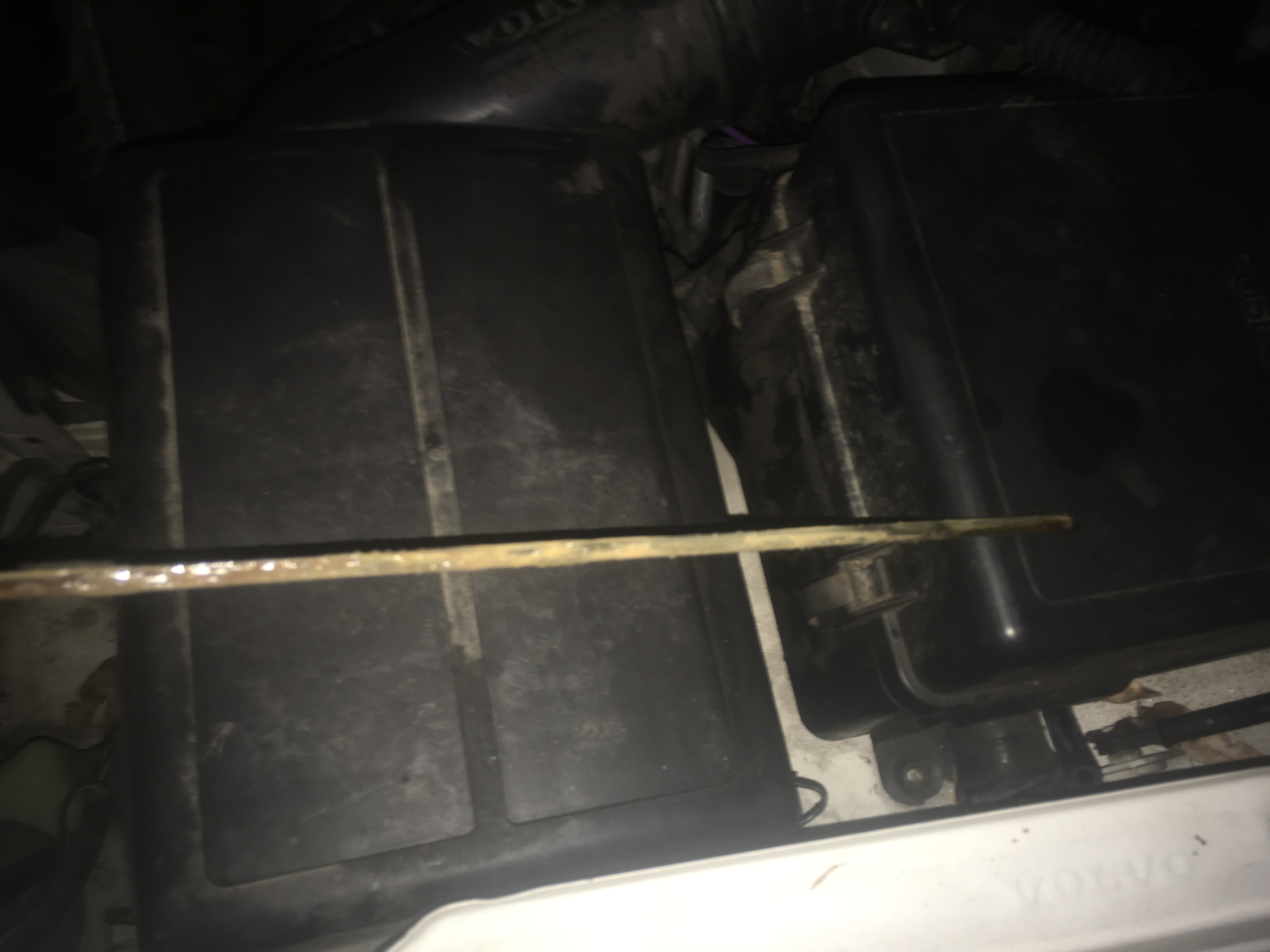

-oil turning milky. The dipstick tube started out very early on with a slight amount of crap on the stick. I have a universal dipstick in there and thought some crap got in the tube, so I made a better sealing dipstick with some bits of hose line and changed the oil (don't criticize the dipstick, I was/ am broke, don't see how it would cause this problem). I checked it a day or two later (short commute) and it seemed fine. Then...

-so I check the oil and it's milkier than before. There is also smoke coming out of the dipstick tube. So I do some research and decide to swap the PCV / flame trap. While doing this I changed out every fuel hose and vac line that looked or felt at all worn (most of them). I cleaned all of the hoses to the pcv thoroughly (none were cracked and my "full kit" didn't include them even though they were in the picture... another story), checked all of the coolant hoses for cracking and wear and for signs of leaking (all good). Cleaned the throttle body and intake manifold along the way. There was some oil pooled in the bottom of the intake manifold so I figured that the PCV was the likely culprit, since what I can gather is that a clogged unit will cause pressure in the oil system which can lead to oil moseying along wherever the hell it pleases. I also read that this issue can cause coolant in oil without there necessarily being oil in coolant (which I have not observed). So I put everything back together clean and tight with new rubber. I also flush the oil and change the filter to get the crap out.
-it worked great for about 4 days before stumbling comes back and power loss gets worse than ever. I check the oil and it is milkier than it ever was before. And now i start to notice smoke in my rear view mirror when I leave for work in the morning. I know it's winter, but a couple weeks ago was way colder in the morning than it is now and I never saw that. I also just moved the car from Colorado to Virginia last summer, so I'm fairly certain that it's warmer here than it ever was in Colorado in the winter. I also notice that the exhaust smells slightly sweet when I get out and take a whiff of the cancer gases.

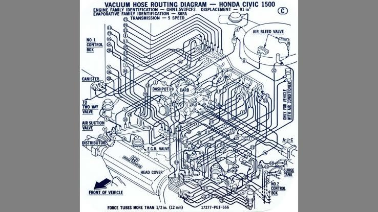

I have done a head gasket before on a 1985 Honda crx hf and that was a nightmare, so I'm pretty sure I can handle this (see attached images for example why) and this all seems like earlier warnings of the same issues there. I have ordered a gasket kit and new head bolts that should arrive tomorrow. I have found jack on the procedure for doing this, but I've already built a temporary "garage" out of a loaned camping awning and several tarps and started the tear down and I want to try to document this as best I can in pictures for those who are unfortunate enough to follow.

P.S. any diagrams like below for this vehicle and procedures would be greatly appreciated.

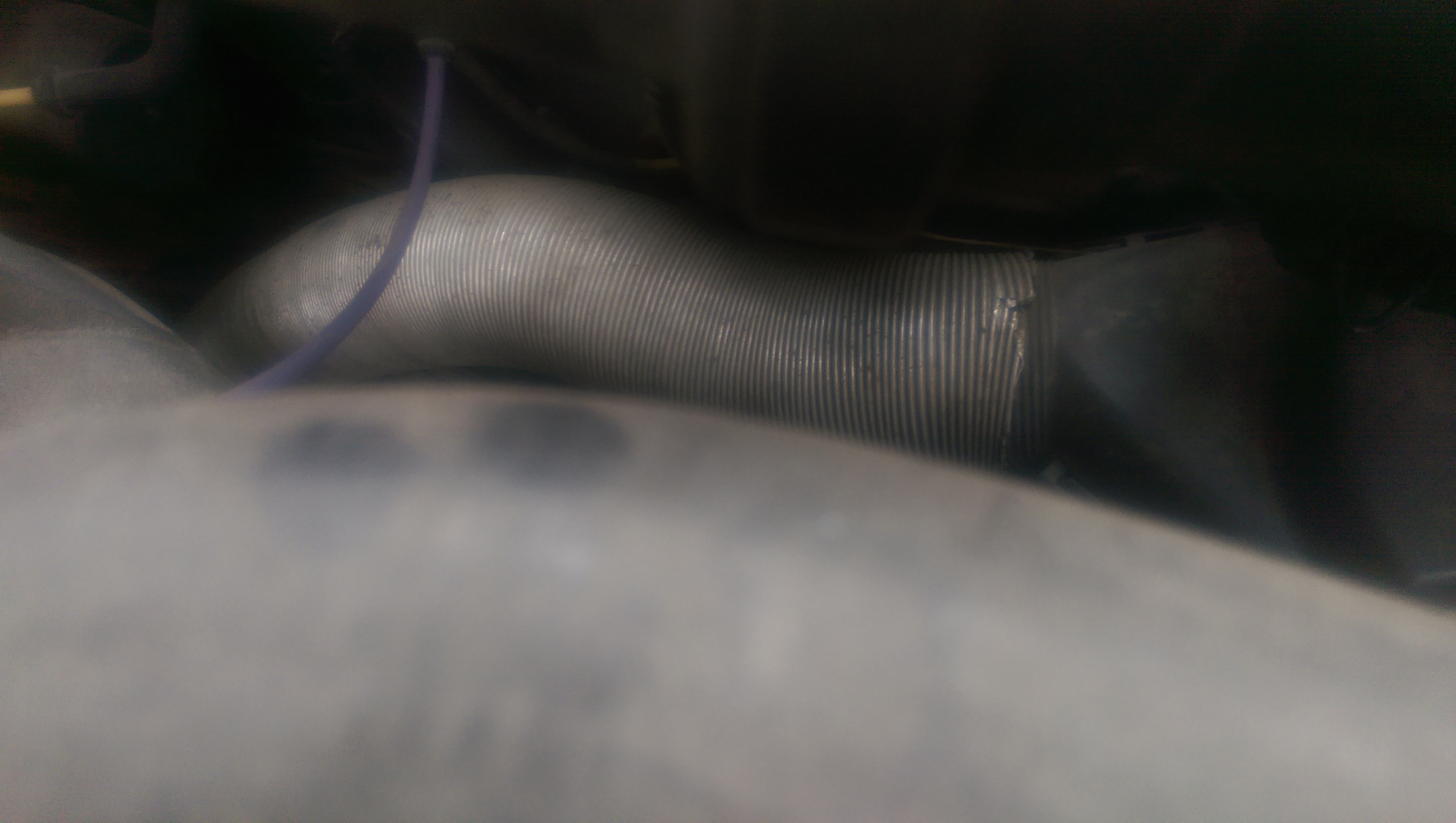

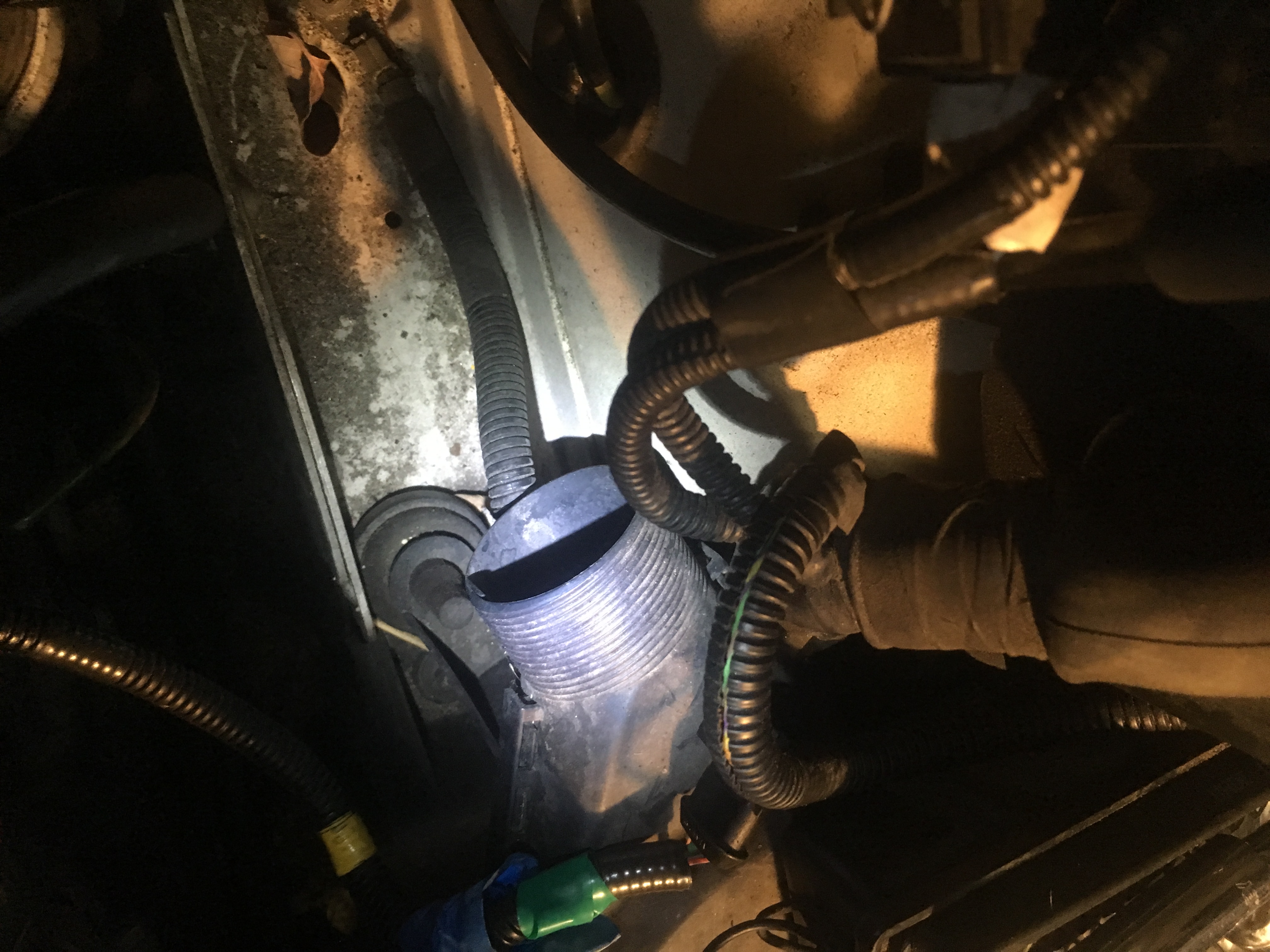

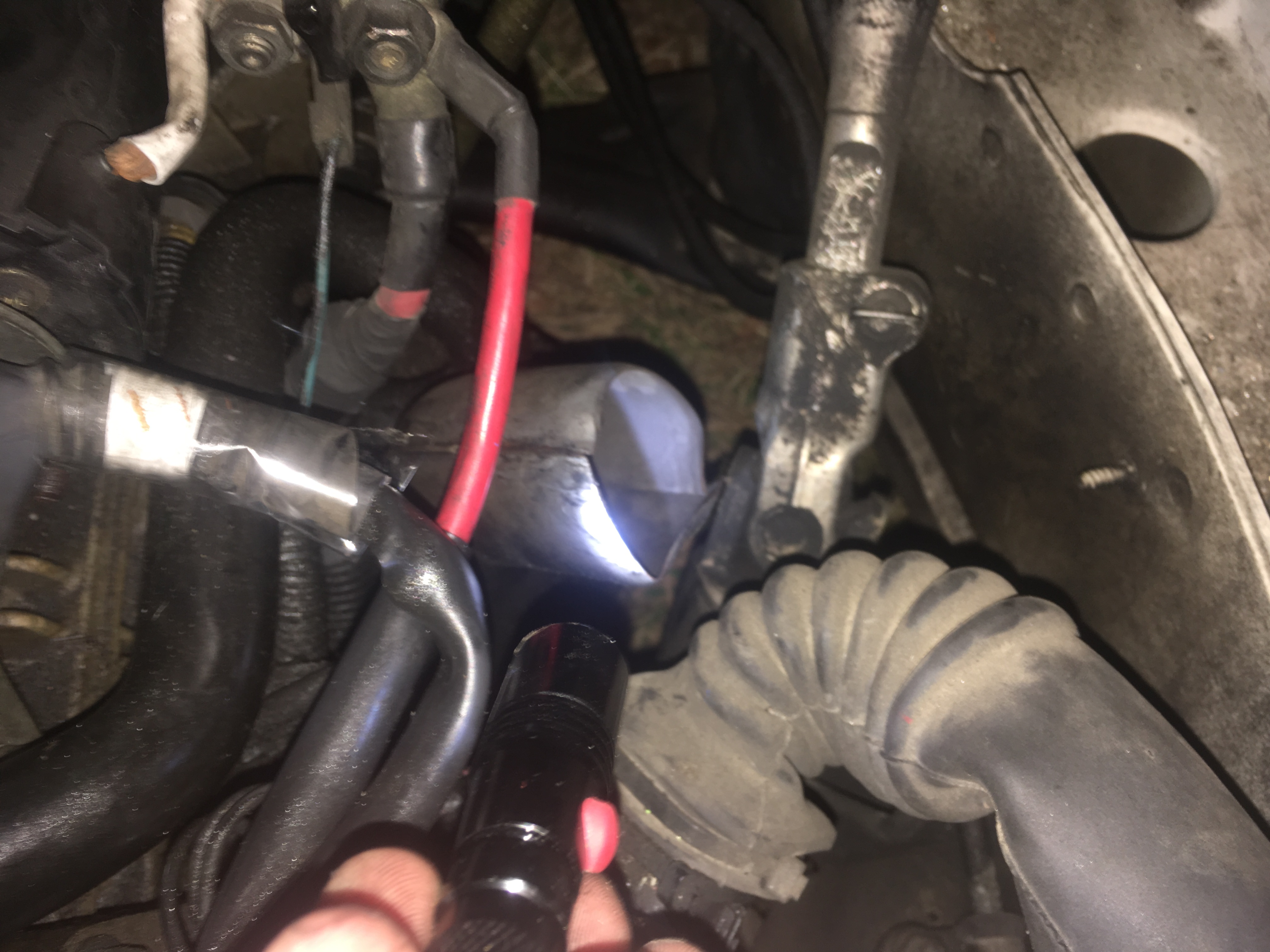

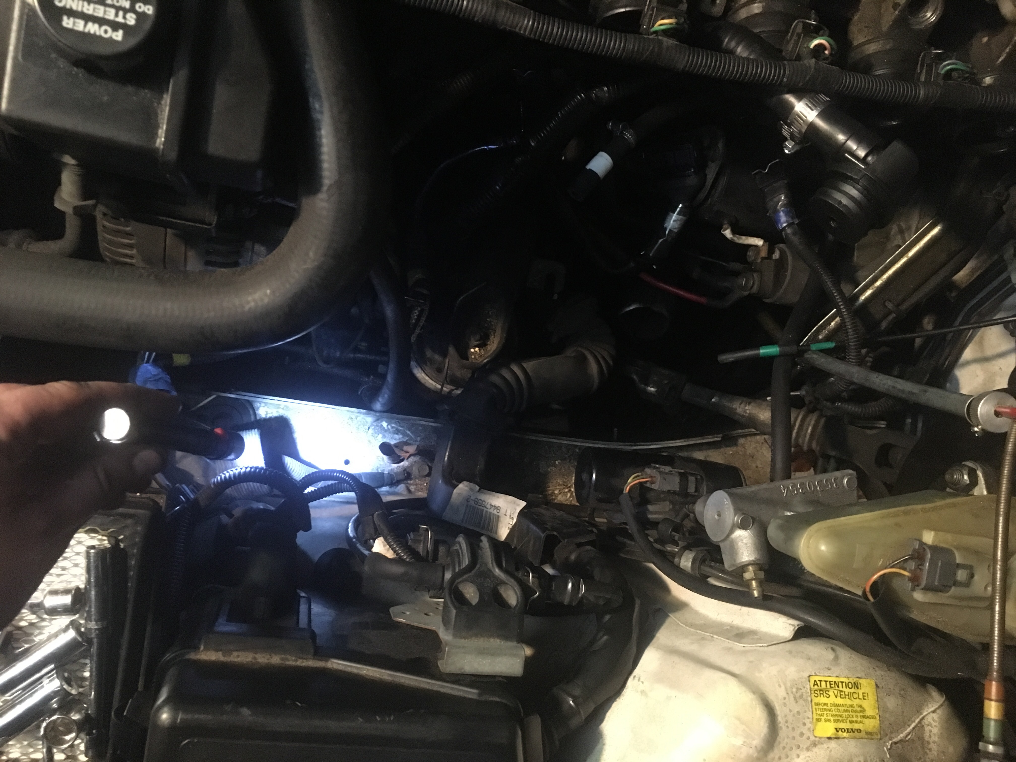

Check out the pics below, though. I just noticed this. There seems to be something missing from the car. There are two tubes that look like exhaust or air intake or something that is missing a line between them.
Some sort of breather or emissions or HVAC thing? Are these two open pipes supposed to be connected? What to each/ both do? Do I need a special part/ type of hose or could I get away with HVAC type tubing or something similar? Or are they really supposed to be like that?

It is missing a flex hose. It is the preheating air intake. The lower one runs over to the exhaust side where it picks up heat.

Wait a week, without it your lose some fuel economy, gain some top end power but it won't hurt anything.

If intake is getting year round hot air, can you say "here comes a head job?"
In colder climates, exhaust heat assist in warming up engine sooner...on my 240/940, the tubing on exhaust heat side is removed.

On the bottom of the airfilter box is a flap that is operated by a waxcartridge (same principle as the thermostat).
Its purpose is to ensure that if the outside temperatures drops below 4 degrees Celcius preheated air is supplied to the engine.
Unfortunately, after 10 years in most cars the wax cartridges do not work anymore so the flap is dead and regardles of the outside temperature preheated air is supplied
In the summer, especially in warm climates, this may lead to overheating of the MAF sensor.
Simple solution is to remove the flex hose from the airfilter box in the beginning of spring and push it on again in the autumn.

as listed above do not hook up the preheat hose. take the flap in the air filter box and secure it to where it pulls from the front. the so called wax solenoid fails to the hot side cooking the MAF. even in cold climate in Ky it doesn't need that preheat. Warms up just fine.you have a bad head gasket for sure as I just went through it. yes, I had the milk shake throughout the engine. But I decided to do an engine swap. I plan to keep driving a 960 for quite some time. This one I've had 5 years and a total of 4 over the years. Due to that I'd like to see some pics and maybe some tips. I've not done a head gasket and I'm sure I'll need to if I do keep driving these fine RWD bricks. They are great cars, providing you start with a working maintained one.
