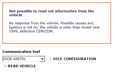

First, I want to thank you for the instructions -- got it working perfectly on my Windows 10 Pro machine, however, I am having difficultues with my DiCE unit (I suppose). When I login as admin, or as the numbers, every time I go to scan the car, I get the "not possible to read out information from the vehicle" error. When I input the car's info (VIN, Year, Bodystyle, Engine, Trans, etc...) and press OK, I am able to see the diagnostics function, but when I click on it, and after it tries to scan the car for DTCs, it gives me a "communication error"
Try"
1. Connect to OBDII port.
2. Key to POS II. wait for Dice lights to settle down.
3. Then connect the USB to the computer.
4. Make sure partner group is set to AME (North AMErica)
5. Try to read VIN.
In other words let the DiCE boot before you connect it to the computer.

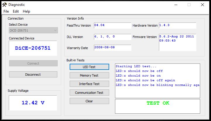

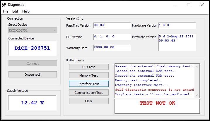

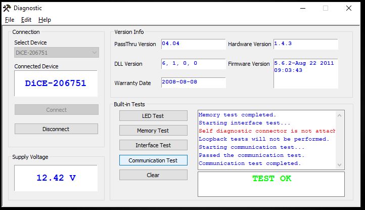

Ok, I did the following:
1. Connected to OBDII Port (Green and Blue Lights blinking)
2. Key to POS 2, wait for Dice lights to settle down (waited about 10 seconds)
3. Logged in as "admin"
4. Connected to USB port
5. Set region to AME
6. Clicked "Read Vehicle"
7. Green Blinking, Yellow Solid, Red Blinking + Clicking from Dash

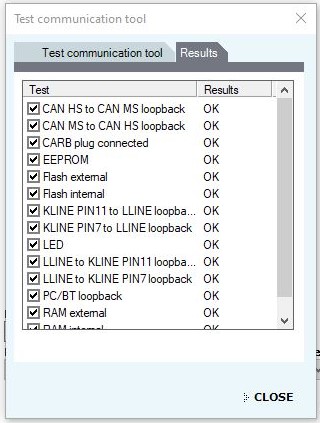

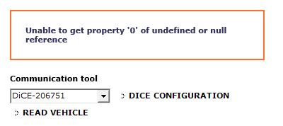

I received this error: Image
8. I added my VIN, and vehicle specs, and clicked "Read Vehicle" again, here is what happens:

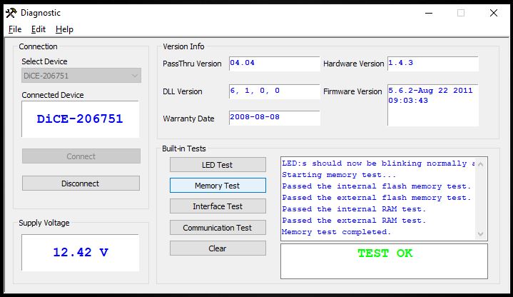

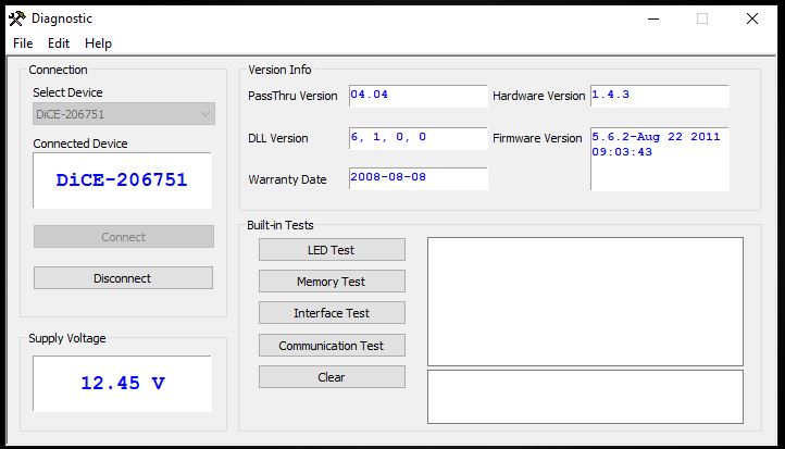

Launching DiCE Configuration reveals:
Launching DiCE Diagnostics and running the tests:

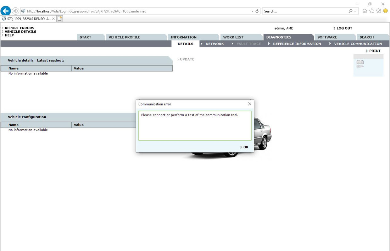

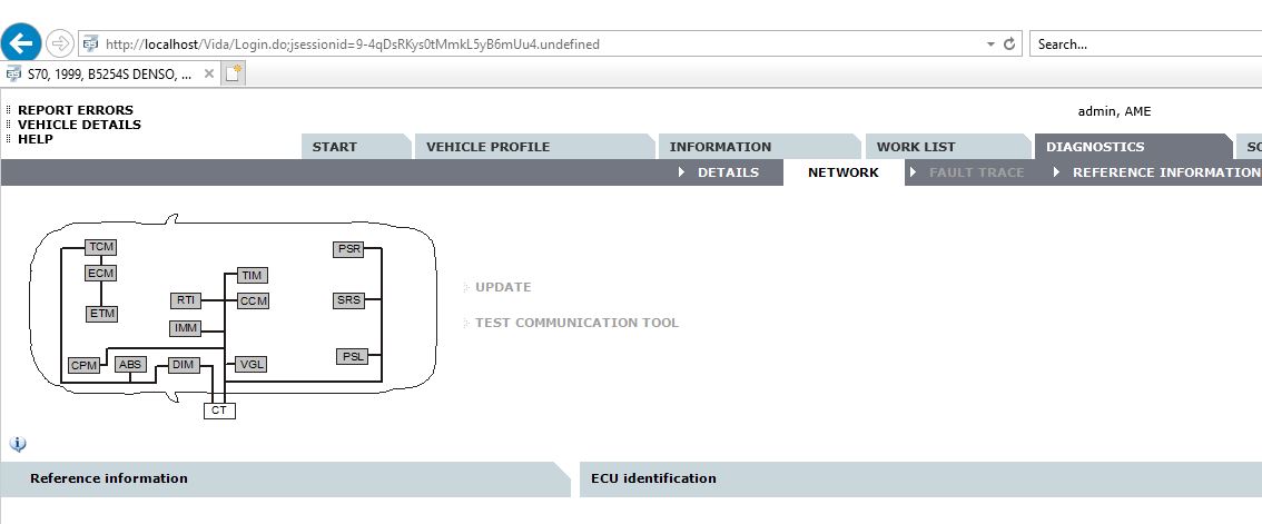

Back in VIDA, When I click Diagnostics, it tries to communicate with the vehicle, Green Blinking, Yellow Solid, Red Blinking + Clicking from Dash, It says "Communicating with CEM, CDM, DIM" Then I get this:
Fault Trace is greyed out after I click "OK" from the "Communication error" box:
RickHaleParker
Posts: 3211
Joined: Mon May 25, 2015 2:30 pm
Location: Kansas
Has thanked: 3 times
Been thanked: 374 times
United States of America
RickHaleParker
Re: Vida 2014D Times out 12/31/2017 23:59
Post by RickHaleParker » Sun Nov 24, 2019 8:04 pm
prefuse07 wrote:
Sun Nov 24, 2019 7:54 pm
Something went wrong in the install. Reinstalling over the existing install has always fixed it for me. Until you get this fixed, everything else is spinning your wheels.
