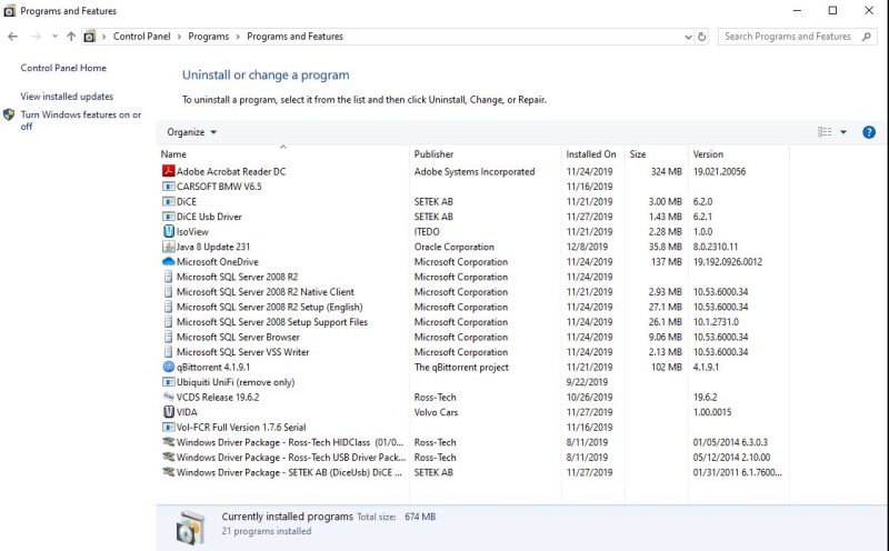

Unless you have a device related missing driver, can you post a screenshot of Control Panel > Program and Features?
Here you go:

^^ Missing ITEDO IsoView ActiveX Control 4.0. ^^

Vida Media:\3PP\Products\isoview\
