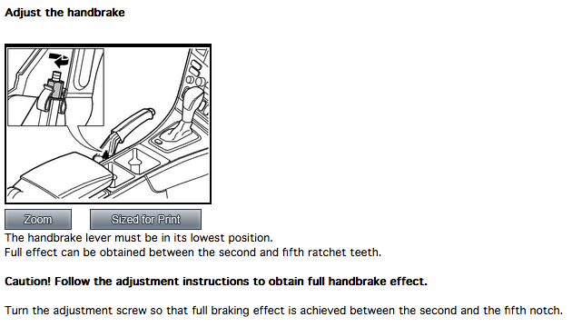

There is a chassis break on P2 where the adjustment goes from star wheels at the rear wheels to only an adjustment at the parking brake lever. Ill try to sort out when that happens.
My 1999 P80 adjusts at the wheels
My 2005 P2 adjusts at the parking brake lever.
If you plug your VIN into the Volvo Parts Lisle website, you can probably look at the exploded diagram and figure out if you have the wheel or lever adjusters.
Warning - if you adjust the 'wheel type' at the lever, it will work but you are probably wearing the shoes on the wrong end and will have to replace earlier. The correct way to adjust the 'at wheel type' is ..at the wheel. The adjust at the lever is only to comp for stretching cables - which is rare unless they are breaking.

abscate wrote: 27 Dec 2017, 12:30 There is a chassis break on P2 where the adjustment goes from star wheels at the rear wheels to only an adjustment at the parking brake lever. Ill try to sort out when that happens.
According to the inspector, the parking brake is required to hold at least 1500 RPM while the transmission is in drive.
I feel your pain but given I drive in MA a lot, its good to know you guys have real inspections.
Seeing as these engines reach the max torque at 1500 that's quite a requirement. Over here they use rollers to test all brakes so I'm not sure what the absolute measurement used is actually. They go more for evenness than absolutes though.
My -00 S80 didn't have wheel adjustment either. I'm not sure any P2 cars ever had them stock. But you can retrofit them and they're readily available online for the P80 cars and will fit.

I'm not seeing any indication on the parts site that my model should have wheel adjustment, based on the fact that it's model year 2001 and chassis number 77,411. Also, my ALLDATAdiy membership is keyed to my VIN, and this is the procedure for parking brake adjustment, excerpted from the section on replacing the parking brake shoes:
Screen Shot 2017-12-27 at 3.14.43 PM.png (76.36 KiB) Viewed 2723 times
This same section doesn't mention any adjustment at the wheel.
So if I've tightened this screw down as far as it will go, and there's no adjustment at the wheel, and the parking brake still doesn't hold at 1500 RPM, would the next step be to replace the parking brake shoes?
