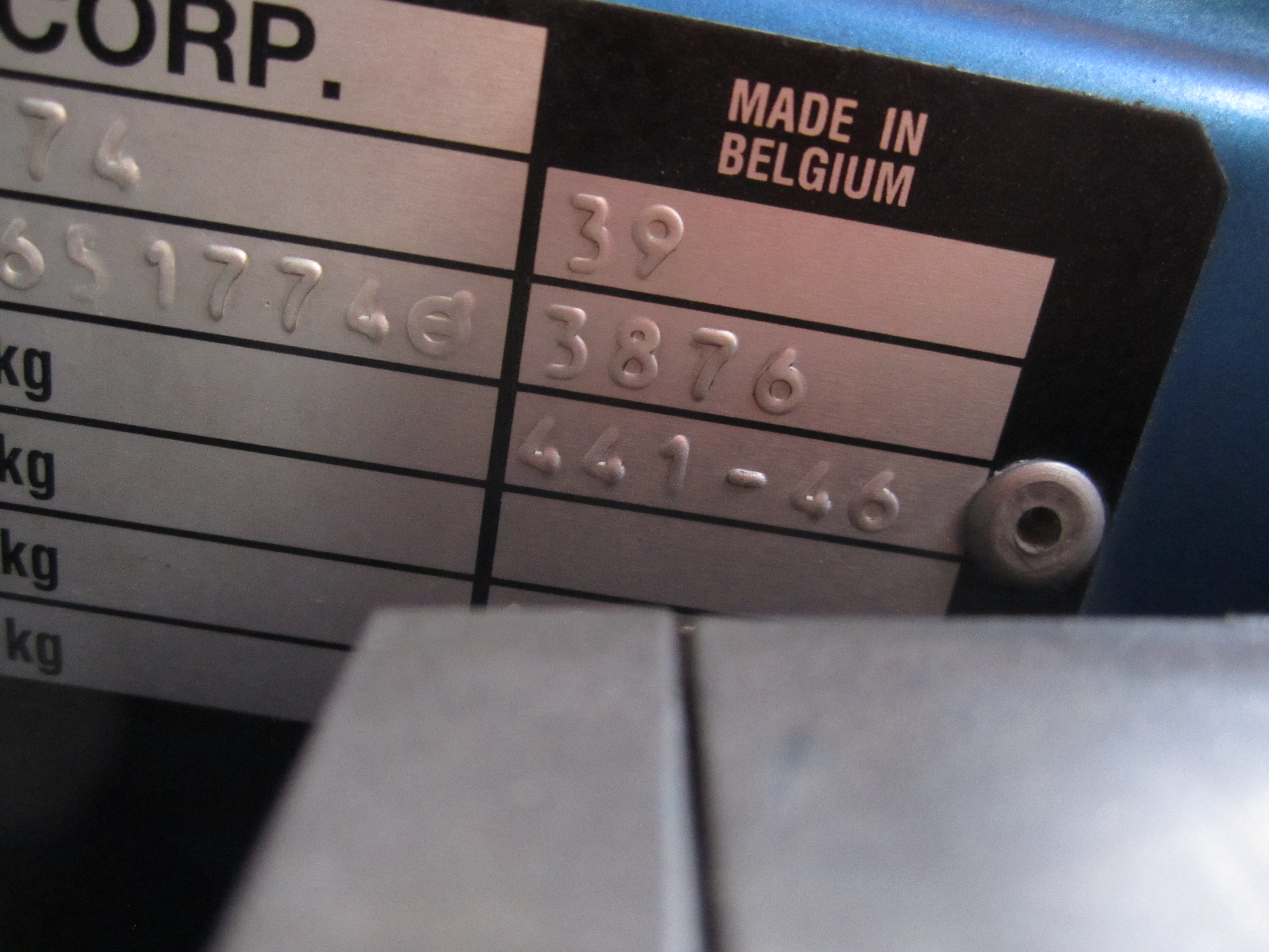

What is your interior code number? 4 digit number on the VIN# plate beside the battery on LHS inner fender.
On my car with the dark gray interior it is the 4 digit number starting with the 3XXX. For dark Gray (I would still verify #):
RH is # 9198848
LH is # 9198845
These are for dark Gray.
Junkyard is your friend here. If you have no luck, I may have one but not sure which side.
