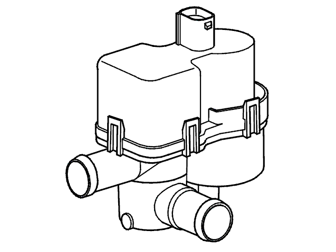

- Posts: 36147
With a wiring diagram, look at the supply plug voltage on the emission pump - see if it is 12 volts at the right time. You can also supply fused 12VDC to the pump and see if it runs - if it doesn't that is the likely cause of the error code.

How to investigate and eliminate - "Short-circuit to supply voltage in the signal cable"?
Pull the connector to the Leak diagnostic unit. Turn key to POS II (on) measure voltage to ground on all pins of the Leak diagnostic unit harness, only one line should be supply voltage. If more then one is supply voltage you have a Short-circuit to supply voltage in the signal cable.
Eliminating a Short-circuit to supply voltage is a matter of tracing the shorted signal wire until you find the short. Else, you can replace the harness with a known good one.
