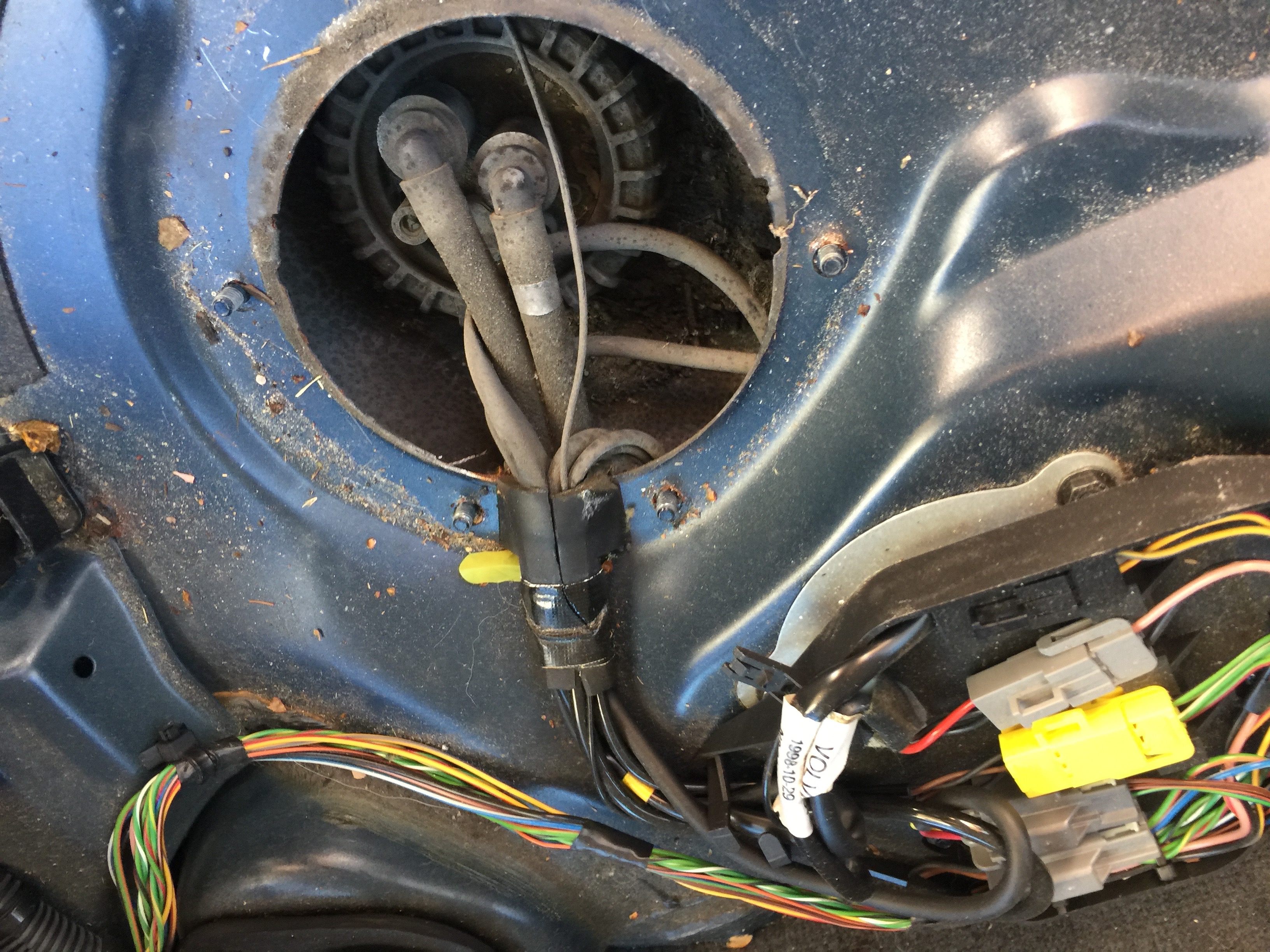

I finally replaced my multiple-repaired rear ABS harness - made difficult since this is a one piece harness that has to be threaded above the gas tank into the rear interior to plug in.
Pictures to come.

Fish tape to pull connector from below car into trunk - contrary to procedure.

Could be worse, you could have had an AWD! Well done that man as it ain't easy!

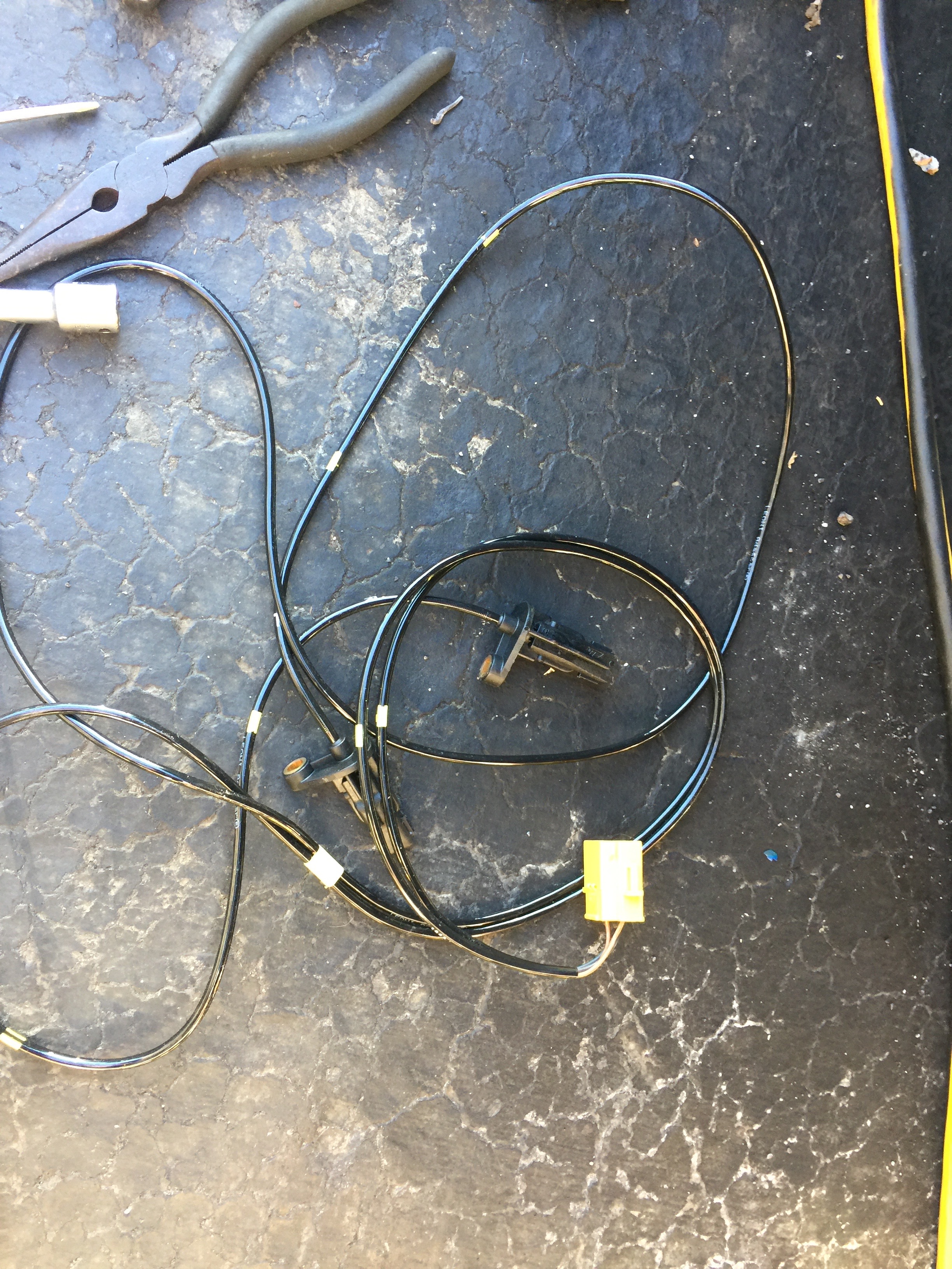

Total time for job 75 minutes. I got hung on the left ABS sensor stuck in the hole, snapped it with pliers - so I had to punch it out through the brake drum with a long screwdriver.

Root cause of problem. Long time ago, I had an indie do something on one wheel, and this is how they put it back together.
I had to solder this thing about 5 times, each time it broke again, just as I went to redo it, the wires would reconnect and my ABS would no longer fault.
Glad I finally fixed it right.

Just a small open/short at the end of the bend where it was rubbing, right?
- Posts: 36137
- Been thanked: 4064 times
I had to disassemble the wheel to get that wire out and then I had an open wire to solder. It’s small gauge and hard to get a connection that wouldn’t flex and break.
